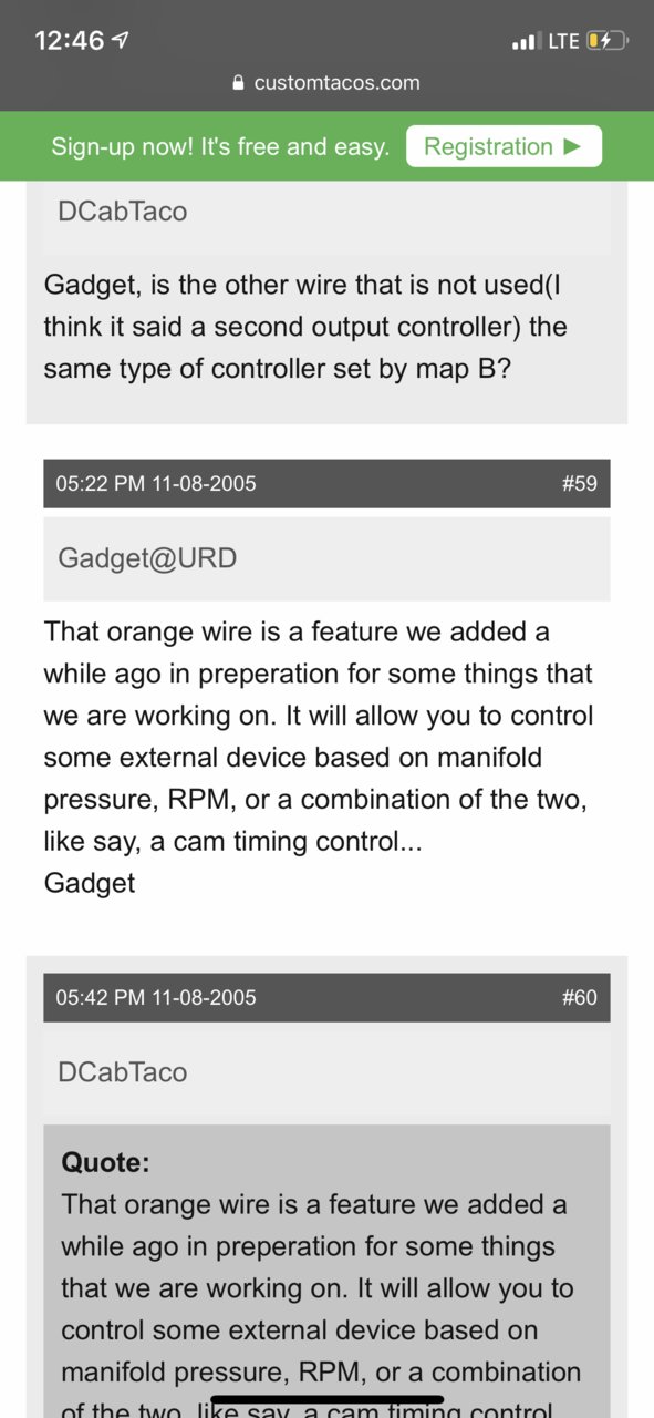

    Here’s a screenshot where Gadget mentions cam timing control through the unused feature on the 7th injector or the AFR calibrator. Can’t remember which one.

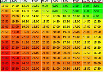

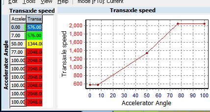

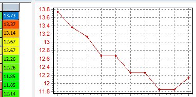

    Transmission shift tables and other transmission related components can be tuned.
    (shift map for example) Shift maps 1 > 2, 2 > 3, and 3 > 4 ( up and down),
    You can see how there is so much more possible with transmission tuning if you don't use half the map for full throttle like toyota does (axis can be tuned)
    Tune-able tables would be >
    Engine :
    Fuel controls
    Ignition Controls
    Torque controls / load
    Throttle control
    Transmission:
    Shift tables Up
    Shift Tables Down
    Torque Converter
    ignition timing:
    (these numbers may not be accurate, have to double check code for conversion) However this is what the stock timing map looks like.
    Full throttle fuel (by rpm)
    obviously there are many more tables but here is just a few to check out.
