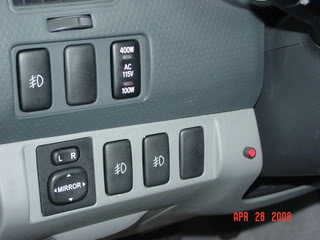

    I have that alarm, but I disabled the annoying horn blow & just have the parking lights flash. The horn has a series of # of sound offs when you unlock to let you know the vehicle has had an alarm. In the pic you can see the red light-button to the right of the switches. It flashes when the alarm is armed.

    I have this one also. The red light is a button that you can push to turn the alarm on and off.

    +1 mine is also in one of the blank slots. From what I've found the alarm is made by Audiovox, Prestige models. I downloaded a manual of one of their alarms with a similar remote as mine and everything works like the manual (disabling/enabling horn chirp etc etc)
    The manual states that pushing the red button is for disabling/enabling valet mode.
