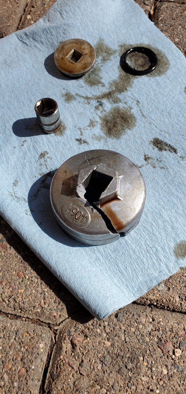

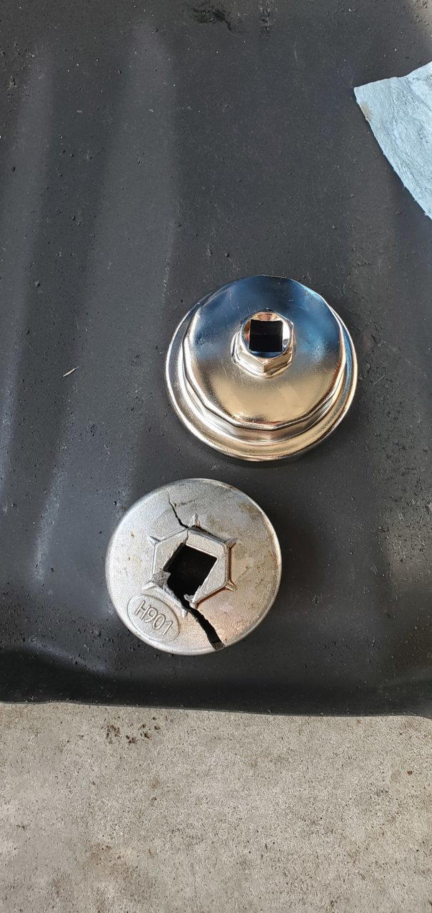

    Oil filter housing is torqued to kingdom come. Holy shit I can't get this thing to budge. I bought a cheap adapter deal and it's toast.

    counter-clockwise. :frusty:
    glad to see some other people have experienced this lol.

    You broke it due to user error. You don’t want to use the square hole for a 1/2” breaker bar. You really want to use the larger hex with a socket on the breaker bar. The 1/2” hole is for reinstalling using a torque wrench.

    New tool from auto zone. Finally got it....
    I had to plant my feet on the tire to give myself enough leverage to get the fucker un stuck. Holy shit. The tool that broke was obviously cheap but it didn't feel much cheaper than what I got from auto zone.
