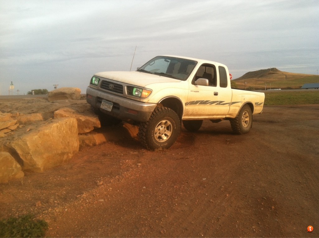

    Nice truck I hope you figure out your transfer case issue ta7ana9y_b9612a4fddae00a6510a8e0b0741b2fa69ddee11.jpg
