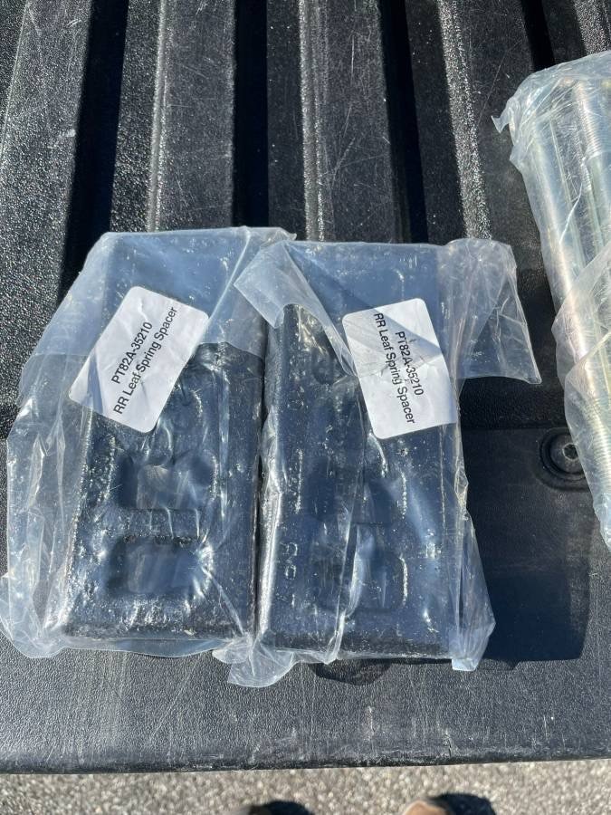

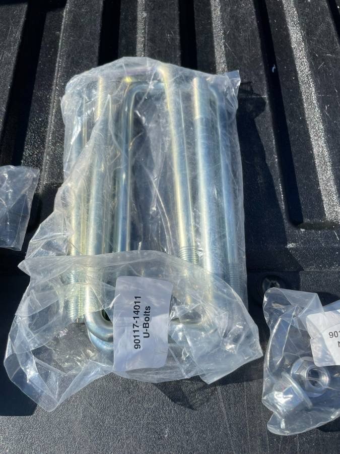

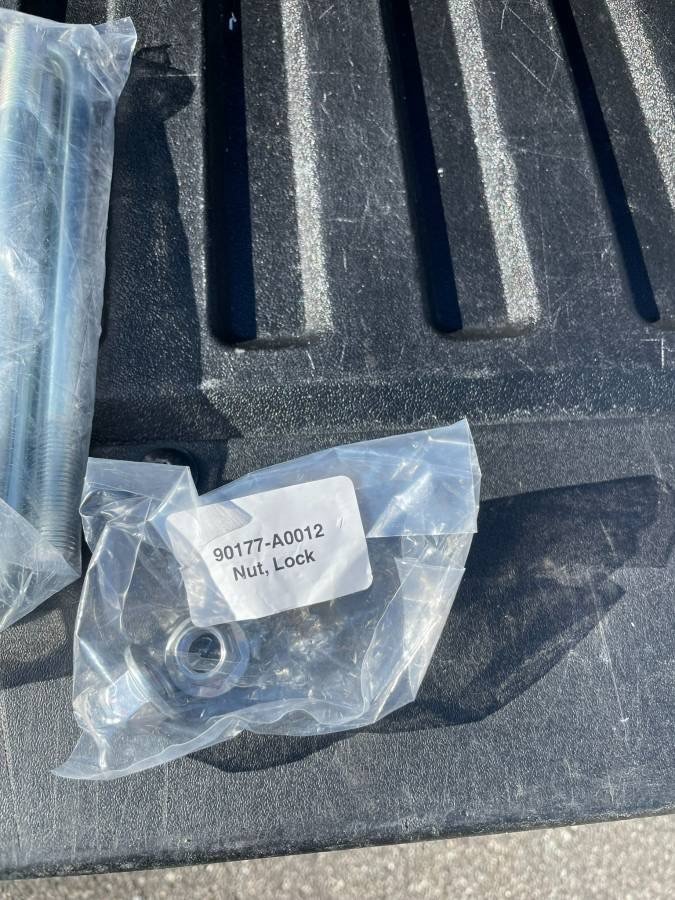

    Pro Skid Plate - Lone Star Knock Off Trail Edition Lift - DIY - Toyota Parts
    Did 4 U-Bolts and both Spacers come with these part numbers or did you order 4 and 2 of each?

    They're single units per part number.
    denimdan73[QUOTED] likes this.
