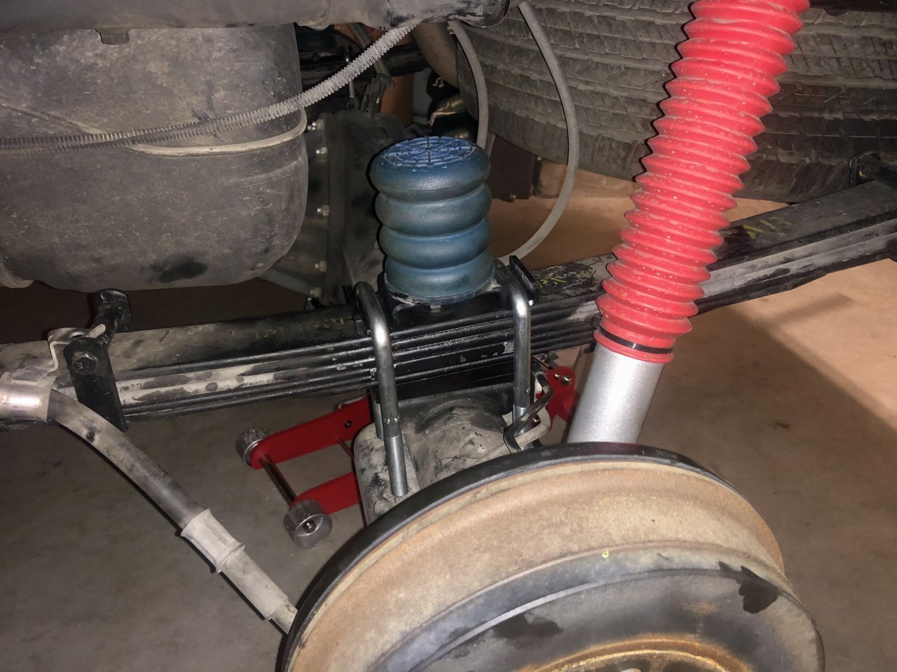

    Got a little bit of rake back. Sits 3/4” higher in the back now, exactly what I wanted. Already had TRD Front Shocks on top setting, TRD Rear Shocks, and Wheelers 3 leaf AAL.
    - Added a Headstrong 1/2” shim to my AAL
    - Added Supreme Suspensions angled leaf shim (think it’s 2.5*). No more vibes!
    -Added Center Bolt Head Lengtheners for shim install from AutoandTruckSprings.com.
    - Added SumoSprings SSR-612-40
    0EE200CC-858B-474F-8E96-5820D063EB0A.jpg E0BE10FA-8E8B-48E0-9893-E35A57E3D57F.jpg

    Interested in more details about the angled shim. What direction for the angle go, and it got rid of the common vibration problem without doing the ecgs bushing?

    Slimmer side faces the front, Thicker side faces the rear. I did not do the ECGS bushing. Every truck will be different, but this worked for me. Here is the link to the tapered shims I got https://supremesuspensions.com/prod...1&_sid=d8370a141&_ss=r&variant=32886517563472
    If you use these shims, also make sure you pick up some center bolt lengtheners so there’s enough bolt head that can seat into the axle. You might also need new center pins as well. https://www.autoandtrucksprings.com/center-bolt-head-lengthener-2-pcs.-cbhl2/

    You could've left the stock overload leaf in there with the AAL and retained the height you wanted and better load carrying capacity.
