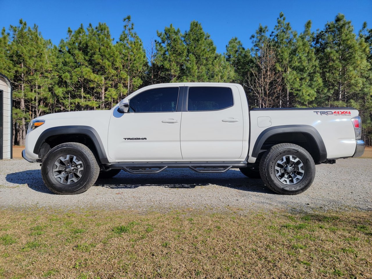

    TRD Lift, MKW Offroad M205 Bronze 17 x8.5 wheels, 265/70r17 General Grabber ATX, Hikari LED Headlight Bulbs, Diode Dynamics SS3 Max Amber Fog lights, Tyger Rollup Bed Cover, OEM Bed Mat, Havoc OffRoad HS2 steps
    Those are stock 265/70r16. I would like to get 265/75r16s later on, but stock will do for now.

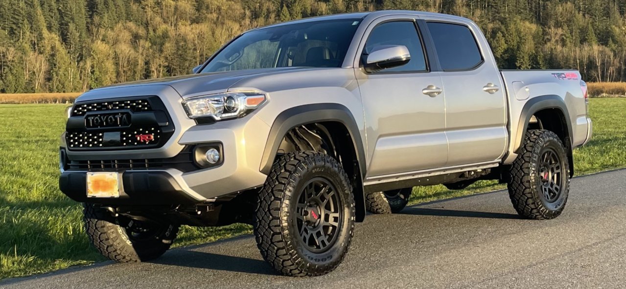

    OEM Lift Kit, 4Runner TRD Pro wheels, BFG KO2 265/70R17 tires, OEM black emblems, tacos4cheap TRD emblem, TVD vinyl grille/tailgate letters.

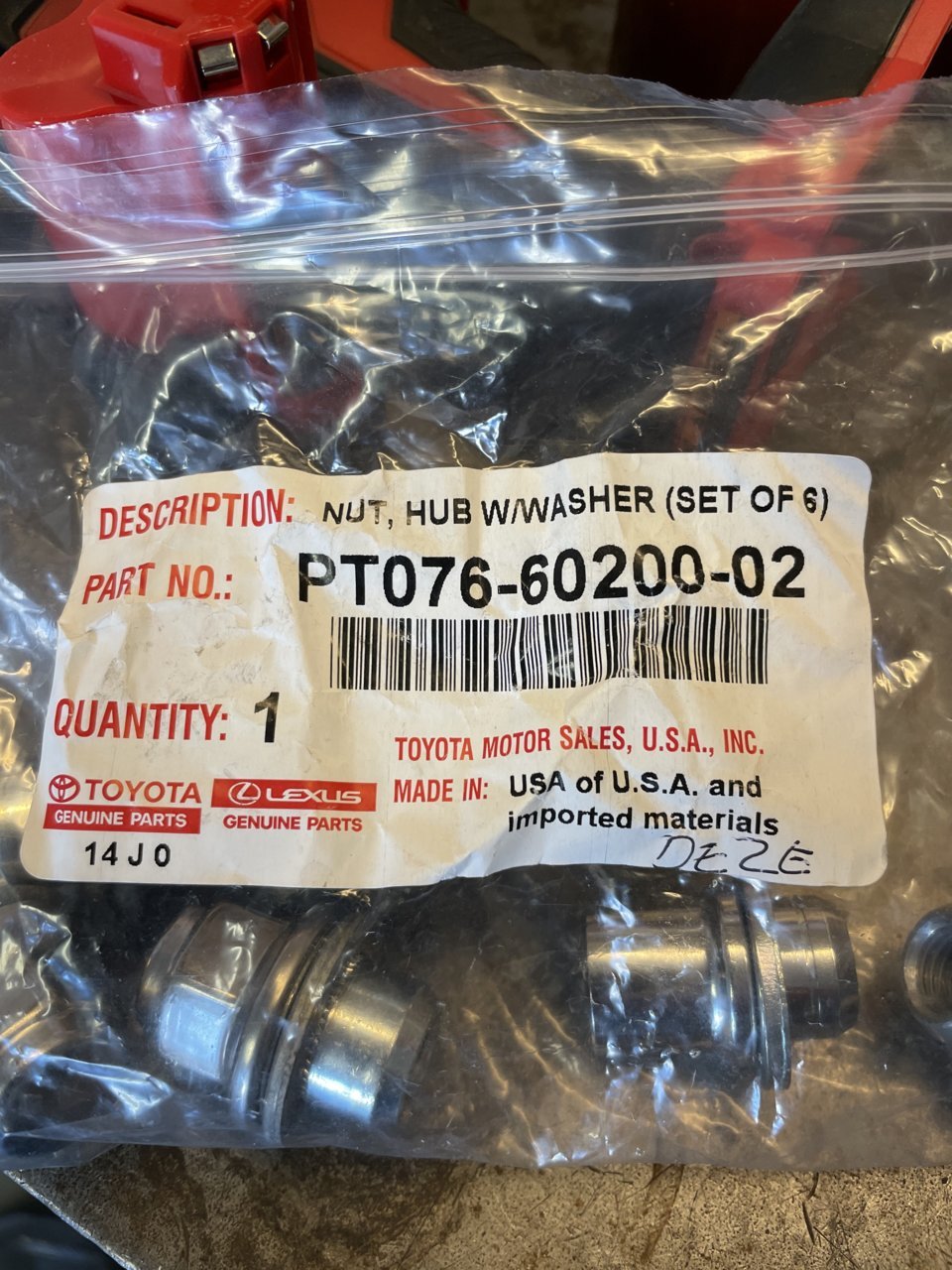

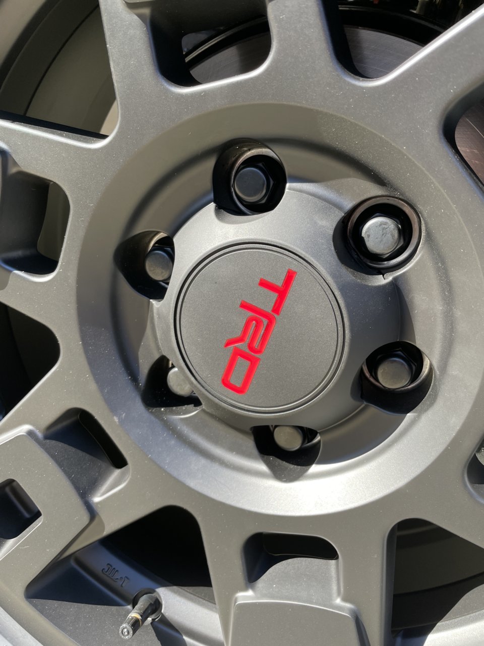

    My new ‘21 Off Road DCAT MGM with 32 miles is getting the lift installed today, with 17” TRD Pro 4Runner rims and BFG KO2 265/70R17 C load tires. The asst service manager also found Toyota black lug nuts which will fit the rims. I’ll post pics tomorrow—can’t wait to see it. The lift is also covered under the 3yr/36K warranty.

    Please share the yota black lug nut info.

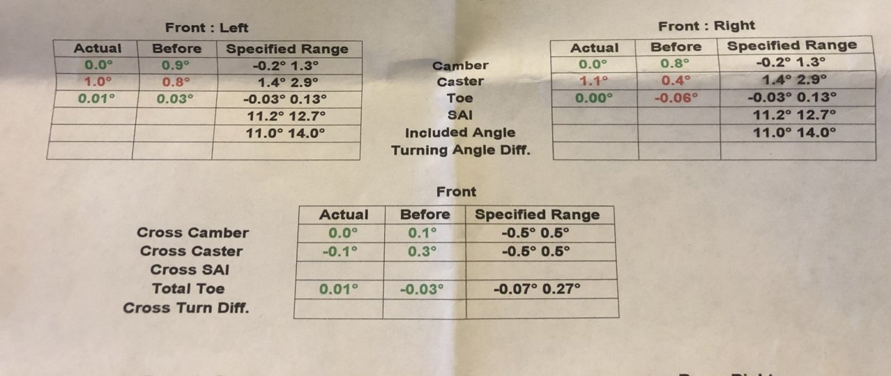

    Got my alignment today. As most people have stated on other threads, you should really consider getting some aftermarket UCA’s.
    I have stock UCA’s and the tech maxed out caster with keeping camber and toe at zero. He could have increased caster a bit at the same rate camber would also increase. He suggested I keep camber at zero to get even tire wear. Drives straight and isn’t terrible, but I’m guessing some extra caster would really help the sloppiness on the highway.

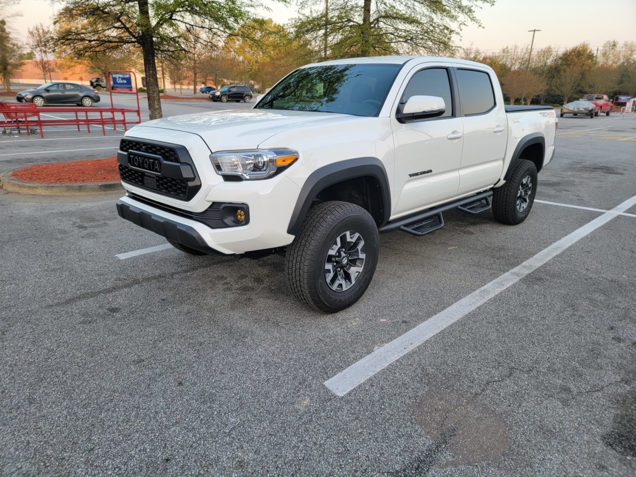

    I had the dealer install my TRD lift kit today. I purchased it at the time of sale two weeks ago but it was still on back order at the time I picked the truck up. They agreed to leave the foglights in place for me instead of pulling them out and putting the blackout plates in.
    At first I wasn’t too keen on going with the Pro grill, but so far I’m pretty happy with the way it looks. Now to get into the clamshell bushing etc. 1B609FDF-886E-4139-A436-79170C901B78.jpg 3C34F80D-D35B-47E3-BCE5-4438BE6534AF.jpg

    That is such a huge improvement! Truck looks great! What did you go with for the rubber? I'm surprised your dealer let you leave the fog lights in. I thought they had to take them out for legal reasons?

    Thanks. I was pretty happy to finally get the truck, but even happier with the way it turned today.
    I went with the 265/70R17 Goodyear Duratracs. I’ve had them on my previous trucks, an F-150 and an F-350 and had good luck with them.
    I was told when scheduling the install that they would certainly be pulling the foglights off. I debated pulling the fuse and covering up the lenses with black tape before I dropped it off. This morning I told them that if they left the lights as is they could keep whatever shop time was allotted to their advantage. They seemed a little iffy whether they could, or would do that but in the end they left them. Saves me time of reinstalling them.
