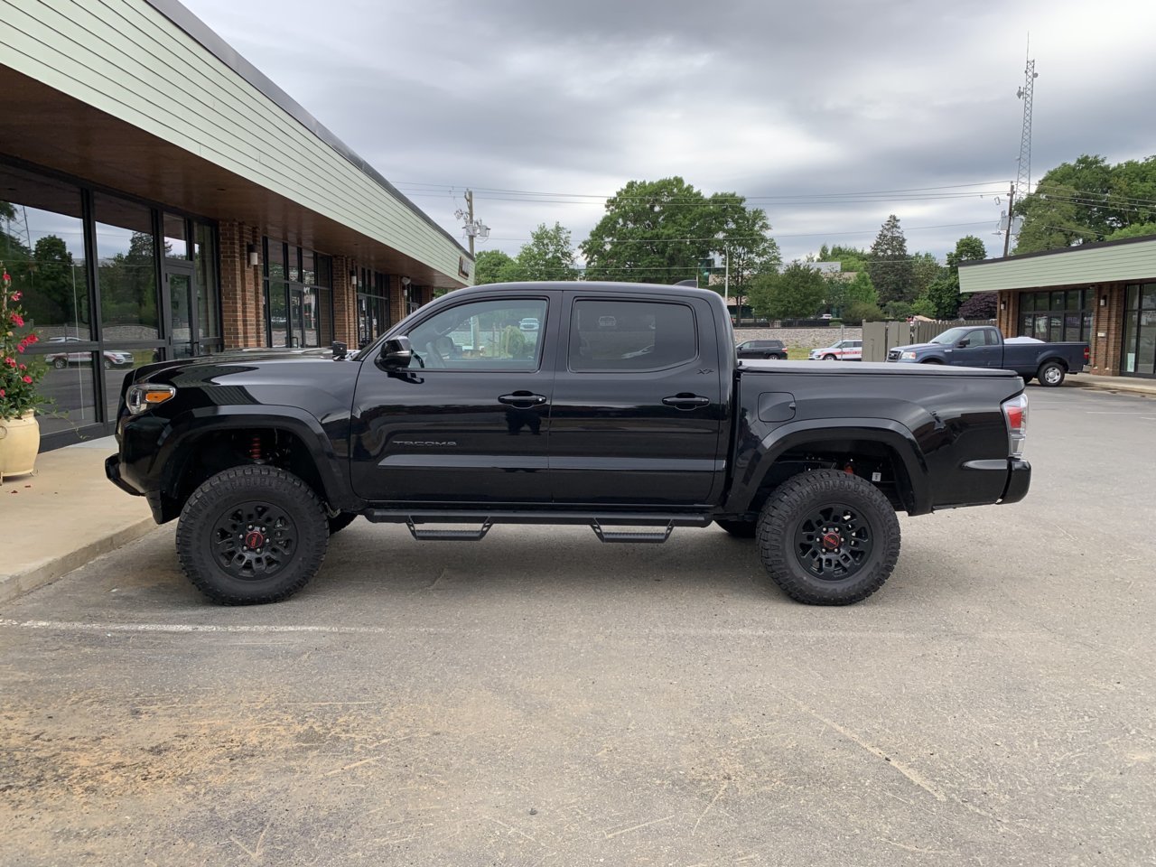

    This is the TRD shocks, OME 888’s, and Icon AAL. 1C85018B-7093-4060-A845-D7B329EA560F.jpg

    My post above has a pic of my truck with the stock 16’s with 265s on them.

    Nice! Very clean black truck. I'm thinking 17" rims with 265s...or slightly bigger. Well done!

    thanks!
    It’s not quite the well-framed glamour shot that makes a truck look amazing, but it’s the current state.
    Can’t wait to get the predator steps off the side...

    Great looking truck!

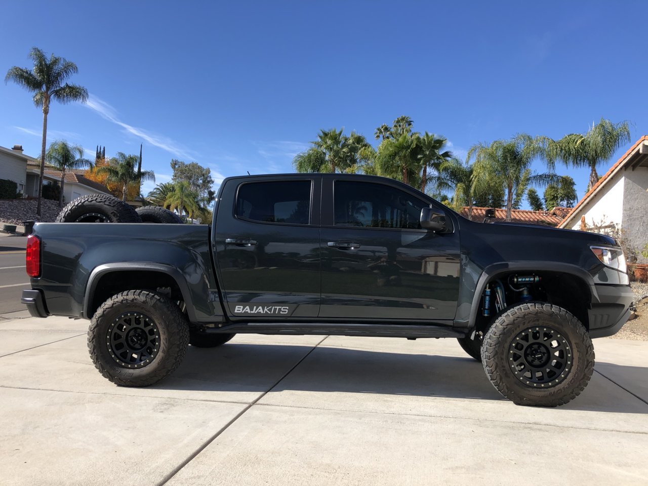

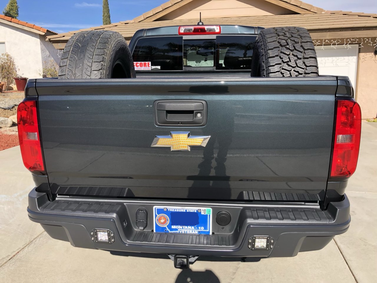

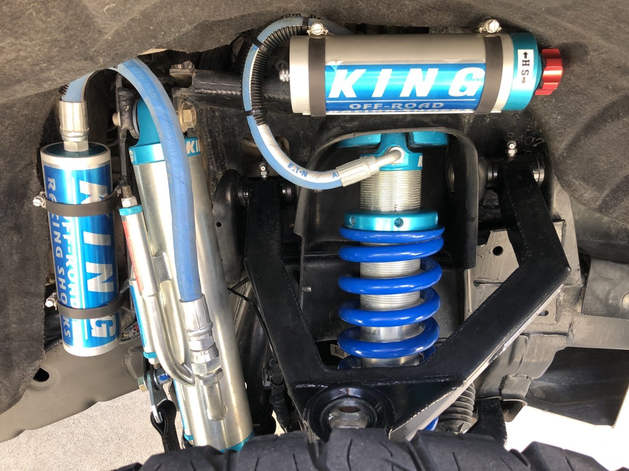

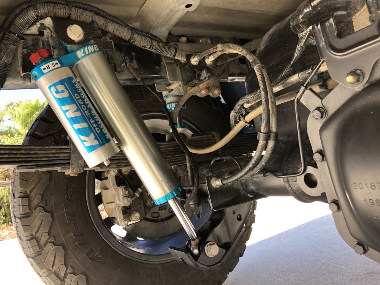

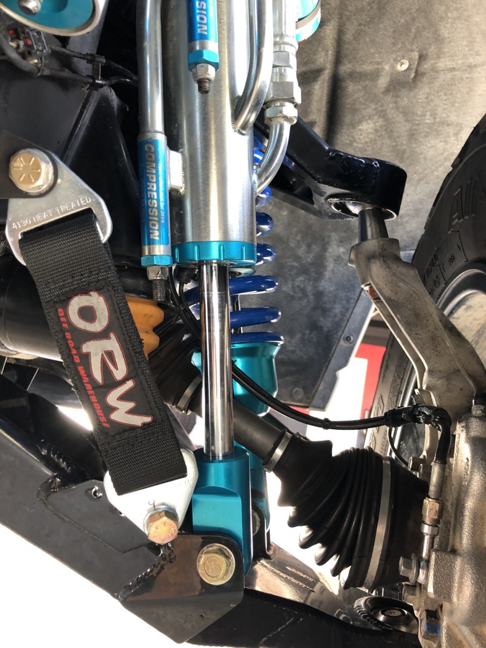

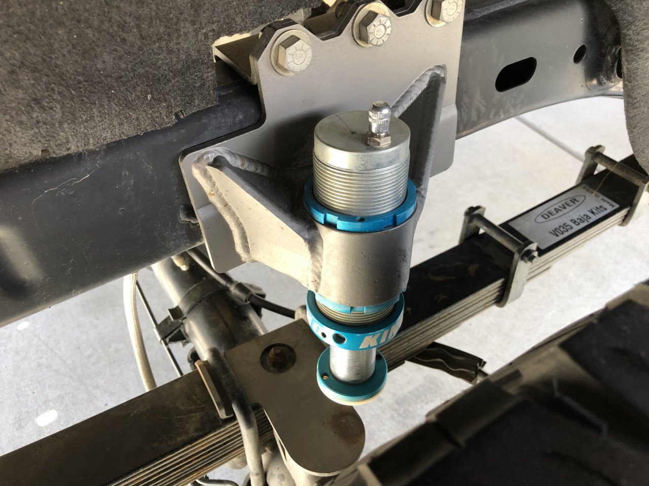

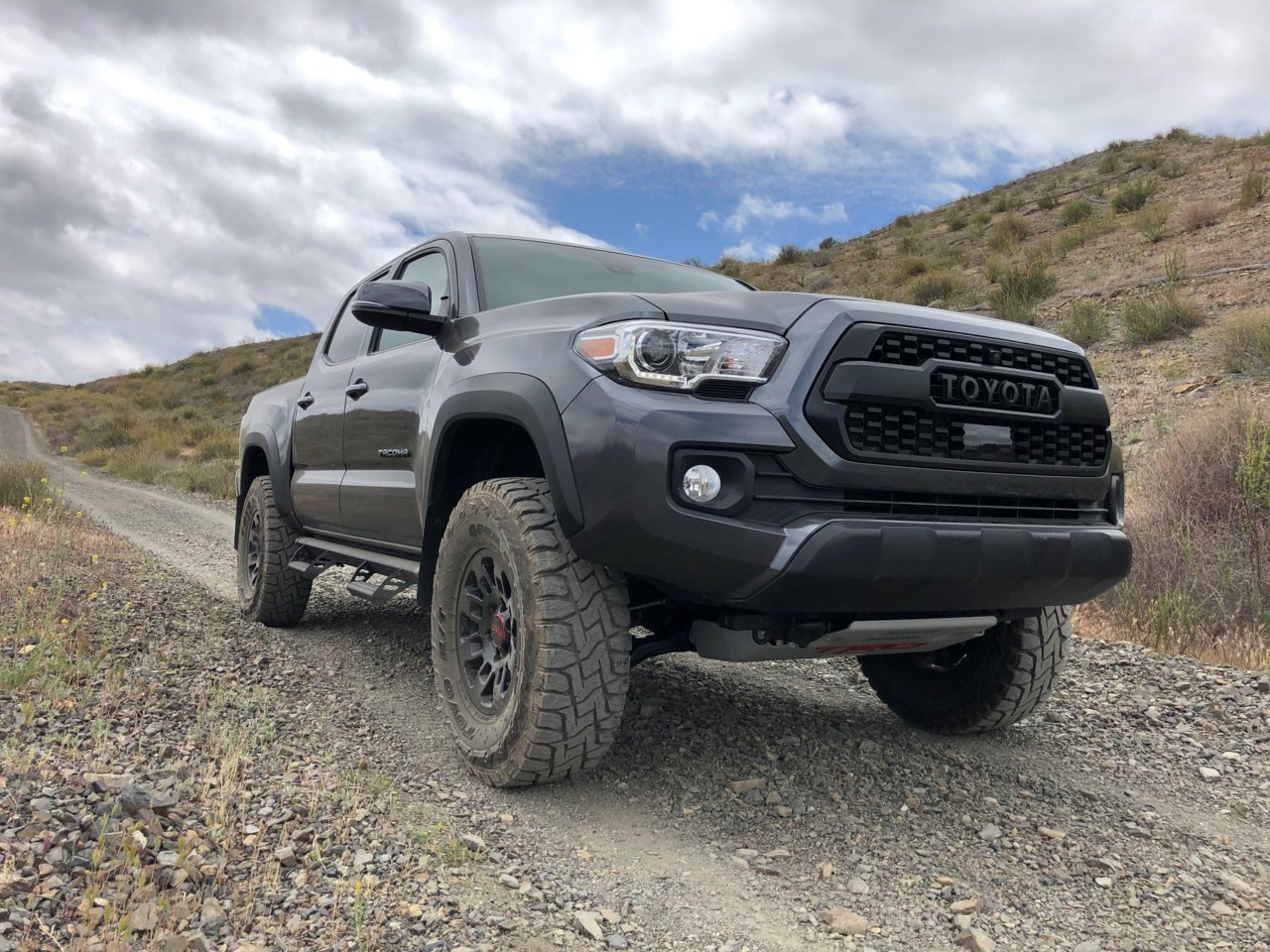

    First post on the site, and thought I would share my set-up & experience after one month with TRD OEM Lift. 2021 TRD OR, owned five months before the install, 10k mileage at time of install. Installed 2019 TRD PRO wheels (Offset +13) 285/75r16 Toyo Open Country RT (E Rated), running 33psi (cold) on road, 20psi (warm) off road. Tires had 6k miles on them (from another truck of mine) when installed. I performed minor clearance mods to the front. Took a heat gun to the front wheel well liner, and pushed it towards the front of the vehicle. Removed the bumper/wheel well liner tab furthest out from the frame rails. I installed Rally Armor Basic mud flaps (http://www.rallyarmor.com/product_info.php/basic-mud-flaps-universal-basic-mud-flap-black-logo-p-274), and used plastic low profile push pin style fasteners, and round head low profile screws. No clearance issues front or rear under full suspension articulation & full lock! I was pleasantly surprised after hearing all of the chatter online about clearance issues! I also do not have some of the other issues mentioned on this thread: needle bearings (vibration), and rubbing on the upper control arms. I think I found the perfect tire & wheels set-up for the mods I currently have on her. Front grill sensor calibrated well, rides stiffer on road then the stock 4600 Bilstein's (no major lean in turns...a nice "sport feel"). Driven off road daily in MT to get to and from home. The suspension is well tuned for what it is (single shock body no bypass). Nice control on medium speed washboard roads, and does just fine in the slow stuff. For what my perception/experience is worth, I have owned varying degrees of modified trucks. To include vehicles with 15k plus suspensions systems (uploaded pictures... "only true if there are photos"). I am not expecting King or Fox shock performance, but I am very impressed for what we can get for the price. I recently traveled from my home in MT to CA with this set up. I drive at the speed limit on HWY15 (65 - 80mph), but I am gentle on the throttle during acceleration. Averaged 18mpg when I arrived in CA. With a warranty behind it as well (one year or three depending), it is a great basic lift. If you have the means to afford the TRD lift, and are contemplating the Non TRD Bilstein 5100 VS. TRD lift. I recommend the TRD Lift to my fellow Taco owners.
    IMG-0525.jpg IMG-0526.jpg IMG-0528.jpg IMG-0530.jpg IMG-0542.jpg IMG-0545.jpg taco.jpg

    Looks GREAT but aren’t you concerned about the cv boots ? Cv angle looks extreme. Boots won’t last long

    The CV boots in the first set of photos are of a ZR2 I use to own. I was trying to convey experience between one type of suspension on the ZR2, to the TRD lift kit. It was the ZR2 listed on Baja Kits website. Yes they were extreme! I ran through CV boots every three to six months in the ZR2. The CV boots rubbed against the King coil overs, and would fail. I am an expert on ZR2 CV boot replacement now. You gotta pay to play whenever you are the first kid in the block with a new suspension set up. The angles on the TRD lift are not extreme at all. I will update with photos of the Tacoma CV boot angles later today.
