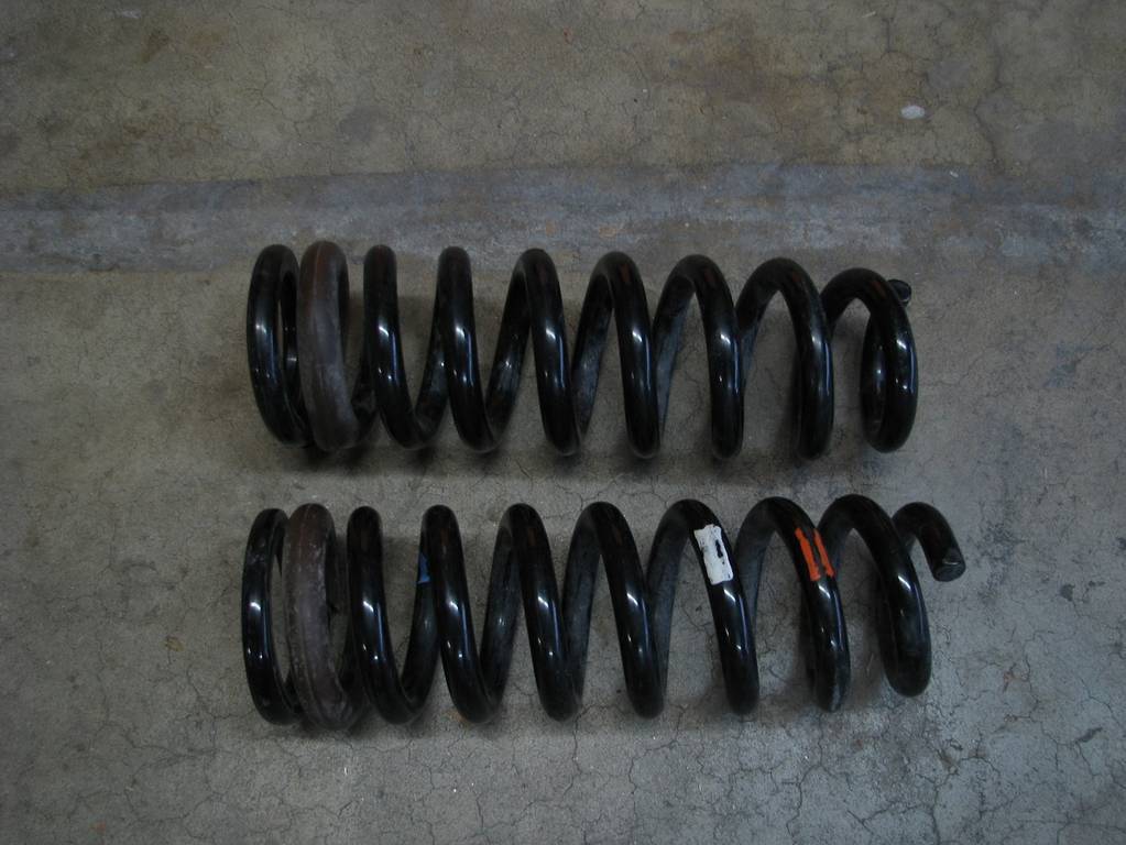

    Not true, the driver side coil is slightly more extend to account for the weight of the driver and gas.
    OP if you set the two coils on a flat surface the taller of the two will be your driver side coil. This will help your truck account for the "taco lean".

    But just in case I'll submit this picture as proof of what I'm saying.
    Notice the upper coil has a slightly elongated gap towards the top, that's to account for driver and fuel weight.
