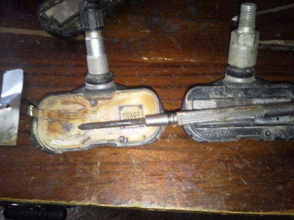

    Some stuff. Not a lot, just some.
    You can't replace the battery without destroying the unit.
    That's the battery at the end of the screw driver...
