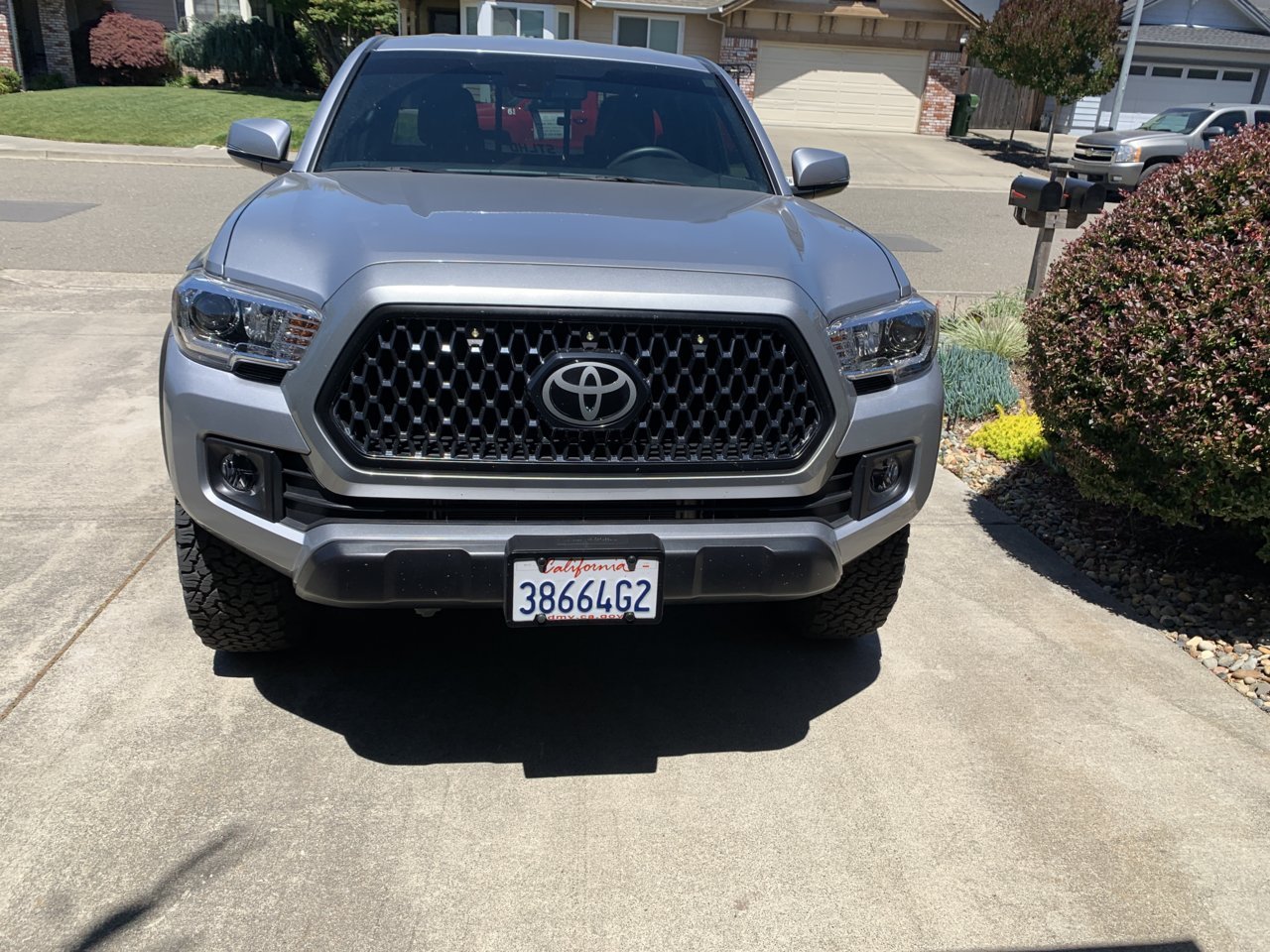

    bogeyj2
    bogeyj2 Well-Known Member
    Nov 17, 2017
    #236208
    158
    jim
    Petaluma CA
    2024 Tacoma Off-road Double Cab Short Bed
    BF Goodrich KO3 265/70R/17 Tinted front windows,Husky Floor Mats,OEM Bed Mat,Clazzio Leather Seat Covers,Beat Sonic Amp
    5FE8842E-1502-4EC7-80E7-E2FF2FD9A21A.jpg No I didn’t put the Pro Grill back on,left the Off Road grill on and went with the black trim around grill.I think it looks good
