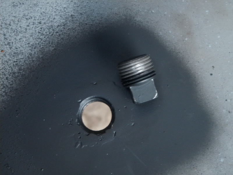

    Ok thanks man! I'll check that site out for sure! Do you by any chance have a pic of the drain you installed when you replaced the floor? When it comes to that point I will be lost. I would like to use the original style rubber stoppers if I can but I'm just not sure how to go about doing that since I have to replace the whole floor.

    Drilled the hole and welded the female end in. Here you go....

    Awesome! Thanks man! That's a great idea. That will more the likely be the route I have to take.

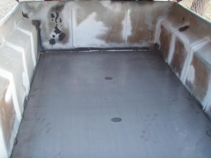

    I don't remember the floor thickness on the tub. Might be at the most 1/8". If you do replace the floor make sure the tub is square! You might even use something less thick and lay over and tack weld to save you $$ and time. You wouldn't have to cover the whole floor just most or areas of concern.

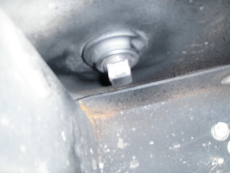

    As far as the drain plug goes I can't remember where I got that from. It could have been Lowes or Home Depot? You could alway use a 2-3" piece of pipe that is threaded on both ends. Weld one end into the floor and cap the the other end. Should be easy enough.

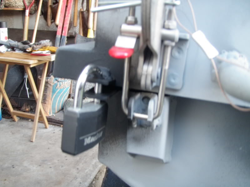

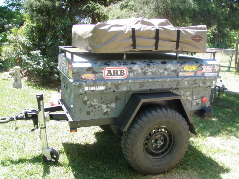

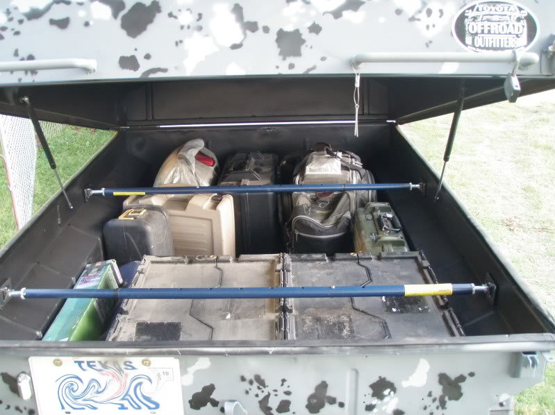

    Don't mean to hijack your thread but a few more to get the both of you motivated....
    Latch and lock for the lid...
    New floor put in...
    The frame and lunette after powder coat...

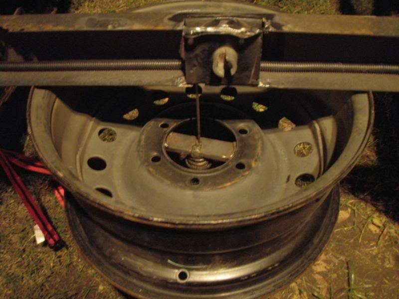

    I even welded in a spare tire winch/reel. Didn't work too good. Still need to tweak it some.

    That's cool. I need the motivation! That floor looks great! I just wish there was a way I could get the ribs put in the plate after I redo my floor. Oh well no worries, A new floor with no ribs is better than a rotted out floor with holes.

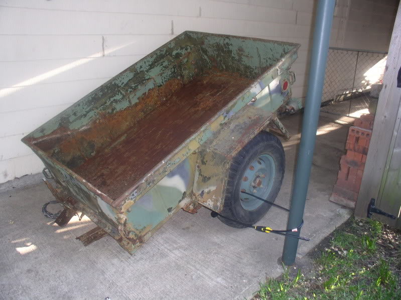

    This weekend I'm putting
    On
    And tackling the rust on
  18. Jan 28, 2012 at 9:44 AM

    Yea, I wore a mask when sanding a small section of the frame today. I think I'm going to do the sanding outside though and not in the garage. Wayyyyy to much dust. I had a fan set up to pull the air out of the garage but it was still pretty dusty.
    Here is a pic of the small section I did today.
