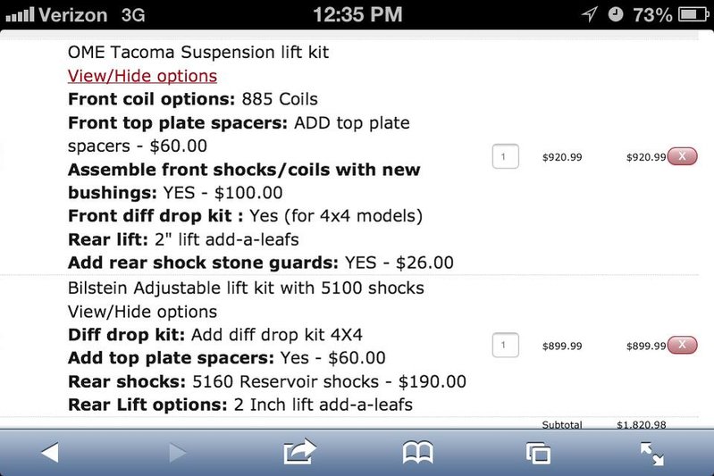

    Ok. Done some more research and have decided on 1 of these 2 lifts. Out of these 2 which one is going to be level?
    OME Tacoma Suspension lift kit
    View/Hide options
    Front coil options: 885 Coils
    Front top plate spacers: ADD top plate spacers - $60.00
    Assemble front shocks/coils with new bushings: YES - $100.00
    Front diff drop kit : Yes (for 4x4 models)
    Rear lift: 2" lift add-a-leafs
    Add rear shock stone guards: YES - $26.00
    $920.99 $920.99
    Bilstein Adjustable lift kit with 5100 shocks
    View/Hide options
    Diff drop kit: Add diff drop kit 4X4
    Add top plate spacers: Yes - $60.00
    Rear shocks: 5160 Reservoir shocks - $190.00
    Rear Lift options: 2 Inch lift add-a-leafs

    I think for the OME kit, you can choose to have a 1.5" AAL, at least I had the option to.
    Here is a thread for my install; they let me hangout in the shop and snap some pics for this thread I did.
    http://www.tacomaworld.com/forum/2nd-gen-builds/293161-ome-kit-finally-installed.html
    Might want to look into some UCAs also.

    And I went with the 2" aal because of settling of the leaves.
