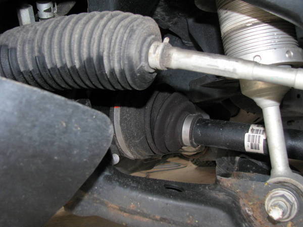

    No worries man. I was just a little upset that you have had to mess with this for so long. I can imagine it was a lot easier with the bar on the end of the spanner wrench. Snap a pic of your CV's and we will take a look at them. Here's a picture of mine:

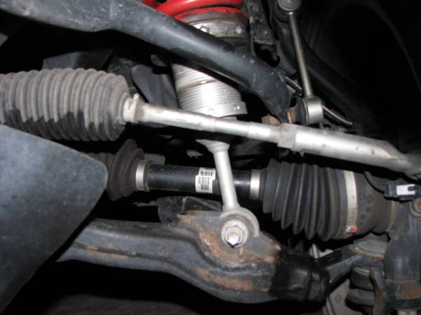

    Sorry for the crappy pic. but here it is. If either side is going to be bad it will be the driver side and that's what this is.
    Let me know what you think.

    Can you get a picture of the top of the boot nearest the wheel? It's obstructed right now... I believe Chris has always said that you're ok as long as the fins of the boot aren't touching.

    The fins on the one nearest the wheel look close but not touching:

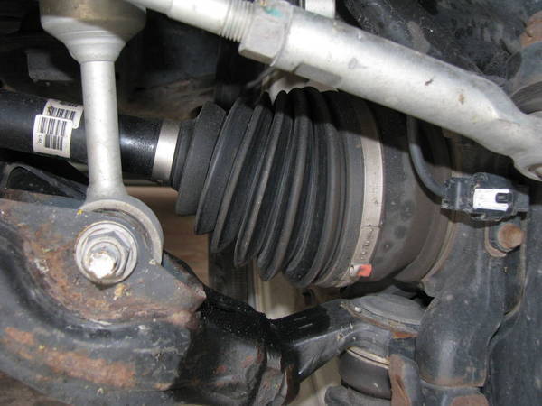

    The upper ones are definitely touching on the bottom of the boot:
    Is that really bad?

    I think I'll let Chris weigh in on this one... I was just parroting what he always said... :eek:
