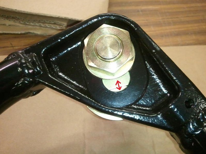

    does anyone have a suggested set up for my light racing uca when I bolt them on? I helped a friend put his on 2 weeks ago and I believe we set them at mark E and 3/4 in in ?? any help

    I set mine on D. that's what they recommended for 2" to 3" lift. the Boss coils come set at 2.5". only wish I had bought a leaf pack like you did. will be buying some next spring just not sure which ones yet. dakars or boss

    I will give ya an update on the dakars once their installed. Now what about the position of the top large nut on the uca. Do I get that at a mid point in the slot it sets in ?

    not sure what you mean? maybe someone else could chime in if im wrong but I think the large nut just tightens on the ball joint there is a spacer, washer or what ever you call it below the nut that once you put it on the setting you want it doesn't move. you tighten that large nut down on it.

    did you mean the large cam bolts on the lca?

    I'm talking about the slot in the upper control arm that the ball joint bolts onto and the possession at which you tighten it down2013-08-26123033_zpscca8de7b.jpg

    I will have to check mine in the morning because that does not look like the LR uca that I have.

    Based upon post 327 I will just put it in the middle and eyeball it. Because it will be different on every truck until aligned correctly

    funny you would post the link with that diagram. I opened the box mine came in that I put the stock uca in it and the install instructions with that same diagram on it. im sure I put mine in the middle like you mentioned until I had it aligned a few days later. did you buy new uca bolts?

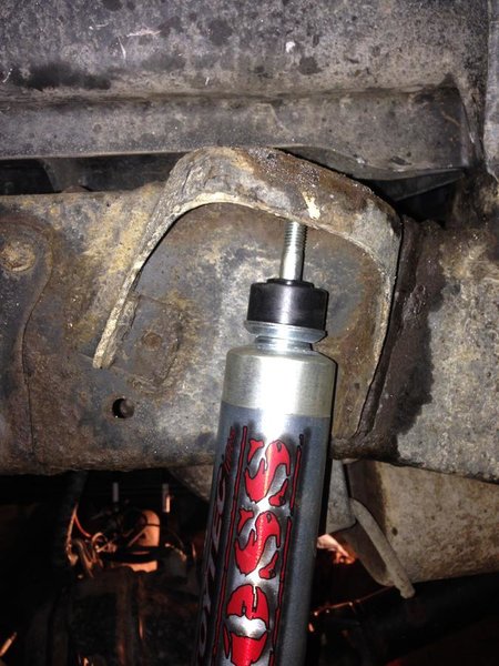

    also after installing the rear Dakars i then installed the boss year shocks that looked wayy too short. about 3-4inches short but i figured it was due to the darkar being at full droop and bing new
    i called toytech later on after the install and they said it will be fine and the dakars will settle about an inch and that i will not need limit straps and the shocks will not be harmed due to full flex
    other then that and having to cut the top buts for the rear shocks it all went smooth.

    the rear end is at full droop but supported by the floor jack. rear shock resting on lower mount tabs. upper shock mount is shown below. having the shock fully extended and not being long enough worried me . but toytec assured me the dakars will settle and the shocks will be fine

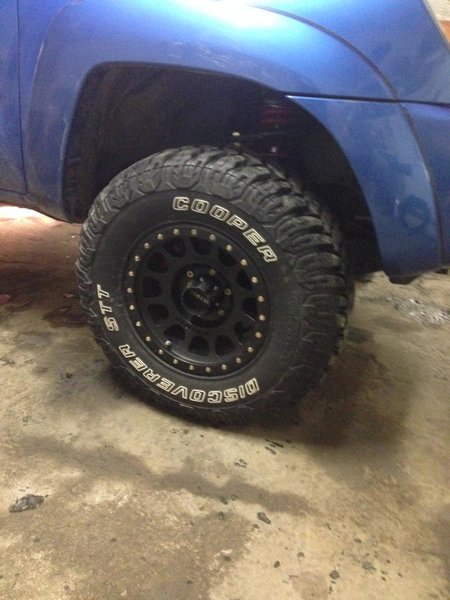

    what size tire did you go with?
