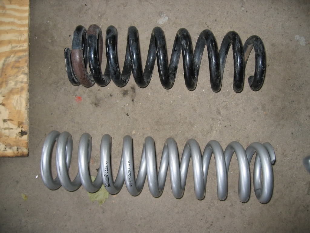

    I asked Doug this same question about the ToyTec C/O being able to handle the weight of and ARB bumper and he advised that the spring rate on the Eibach springs are 600lbs. This is actually a slightly higher spring rate than the OME 885 which has a spring rate of 590lbs. He also stated that ToyTec C/O should handle the added weight of a bumper just fine. Hope this helps.
    The Eibach springs are also longer than the stock springs as seen in the picture below.
