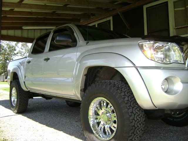

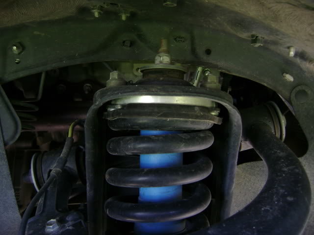

    Here is my toytec 3". Go with the 885 springs up front toytec now recommends them for the dc models. I also have the Belstien shocks, got when I did the Spring TSB, 3 days before I installed the lift. I haven't had any problems truck rides like stock, I haven't really put them to the test but thus far I love them.

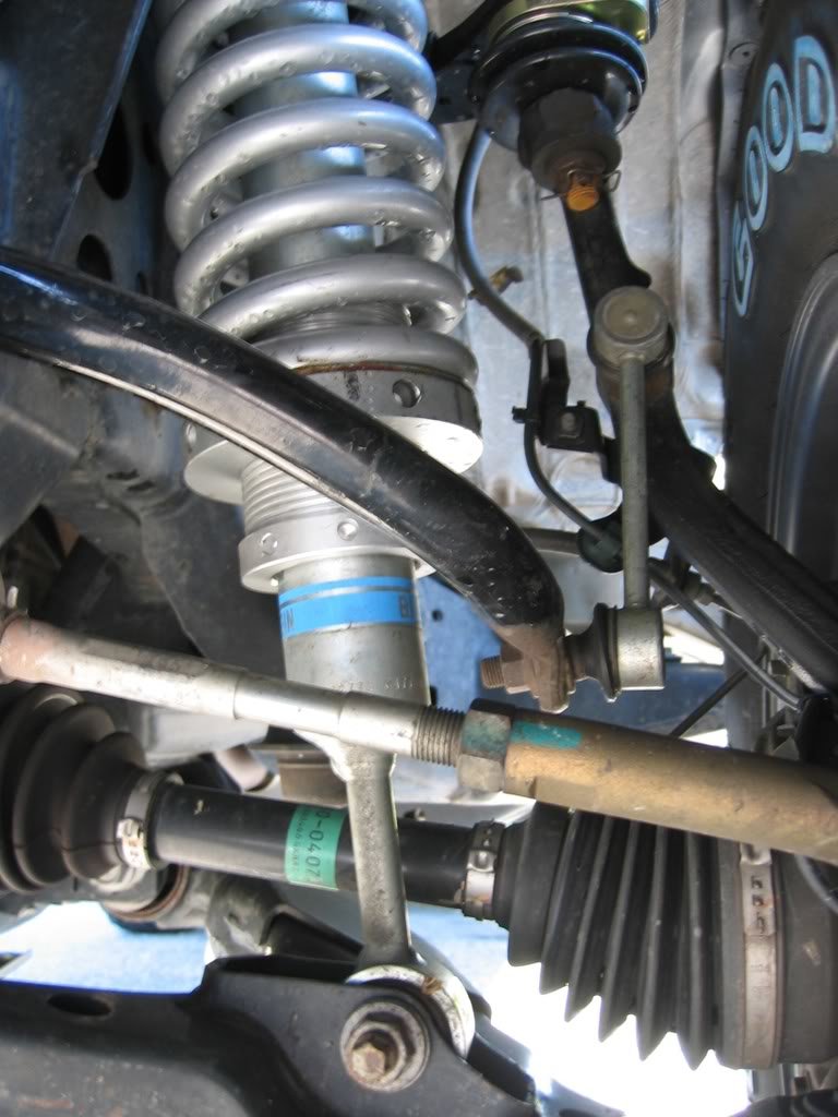

    the thing that bothers me most about the toytec coilovers is how THIN the assembly is at the bottom...it looks like the slightest amount of pressure in the wrong direction could result in snapping that shaft off the lower mount...
    ICONs are good, but theres other more affordable solutions out there that are almost or just as good
    I'd personally go with something adjustable and rebuildable
    with a bit more beef to it

    The toytec coilovers are bilstein 5100s with an eibach spring on them and a height adjust collar. So you are getting a pair of $150 shocks with $150 springs on them for $799. Not such a smokin deal. They do not compare to the real coilovers of SAW, Fox, King.
