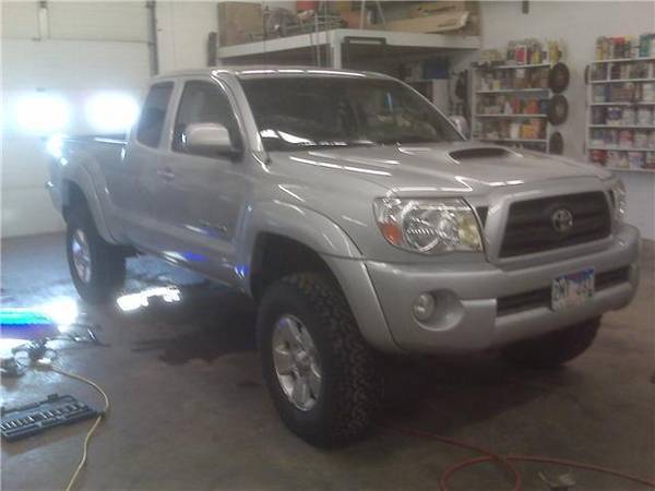

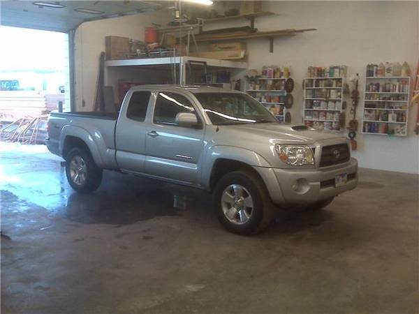

    Well, I threw a Toytec 3" on a buddy's 2005 taco on Saturday. The install went flawless and quick. I think it only took about 4 hours. He wanted to keep the stock wheels so we used spidertrax spacers in the front. I really like how it turned out.
    Sorry but the only camera i had was my phone.
    Before:
    After:
  2. Dec 22, 2008 at 6:56 AM

    nice job looks good, SpiderTrax on the back are good too, evens things out a bit

    Looks great! Which ToyTec lift did you install? Also, I'd echo Dark Knight - install the SpiderTRax on the rear too. It's what I did and it makes it look even.

    If it were my truck i would put them on the back too. I don't think he is too worried about it for another $100. The toytec kit was the one with front coils and rear AAL's.

    Stay with the stock shocks?

    Yes, they come in 1.25" for the Tacomas.

    Yep....... kept the stockers.
