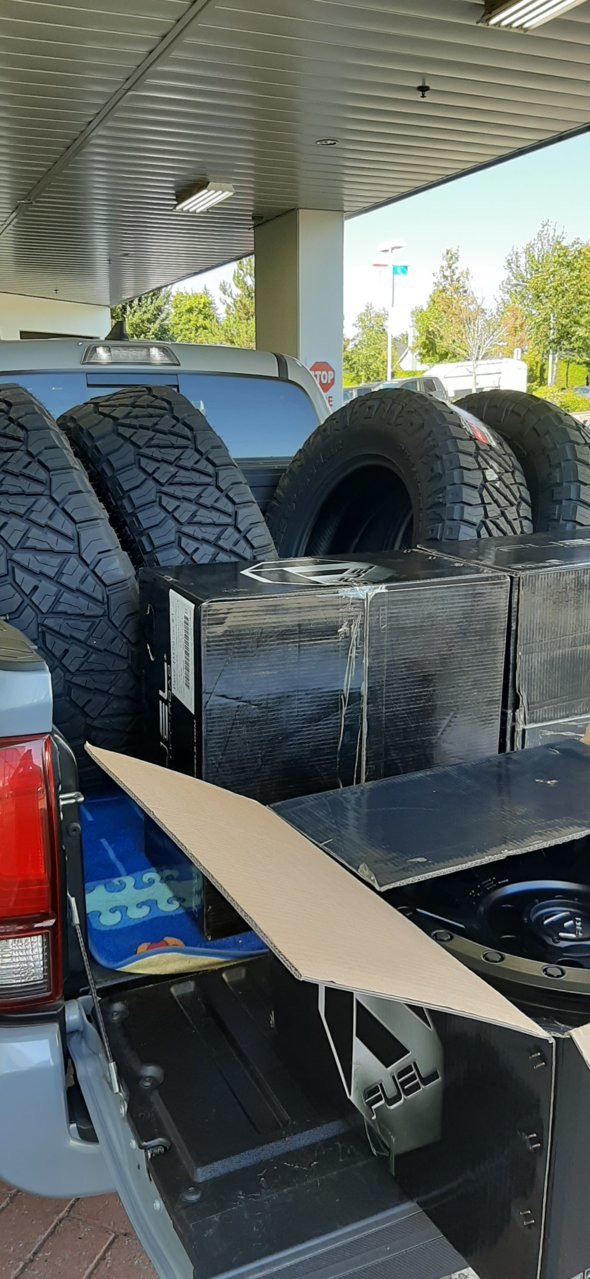

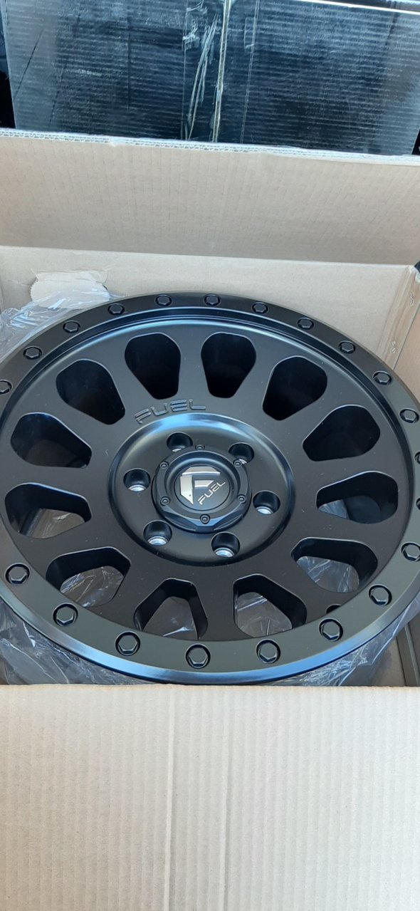

    Hey guys new to the tacomaworld forum and was hoping I could get your guys help. I just picked up fuel vector rims and nitto ridge grapplers today. Was planning to get them mounted and balanced until I arrived at toyota and told me that the toyota tpms might not fit properly in my new rims. They also didnt want to be held liable for any leakage from the tpms so they didnt want to do it either. Has anyone swapped there tpms from their stock rims into Fuel Vectors without a problem? Or know any aftermarket tpms I can buy? Pretty pissed off but I want to make sure I get the tpms properly installed without having leaks.

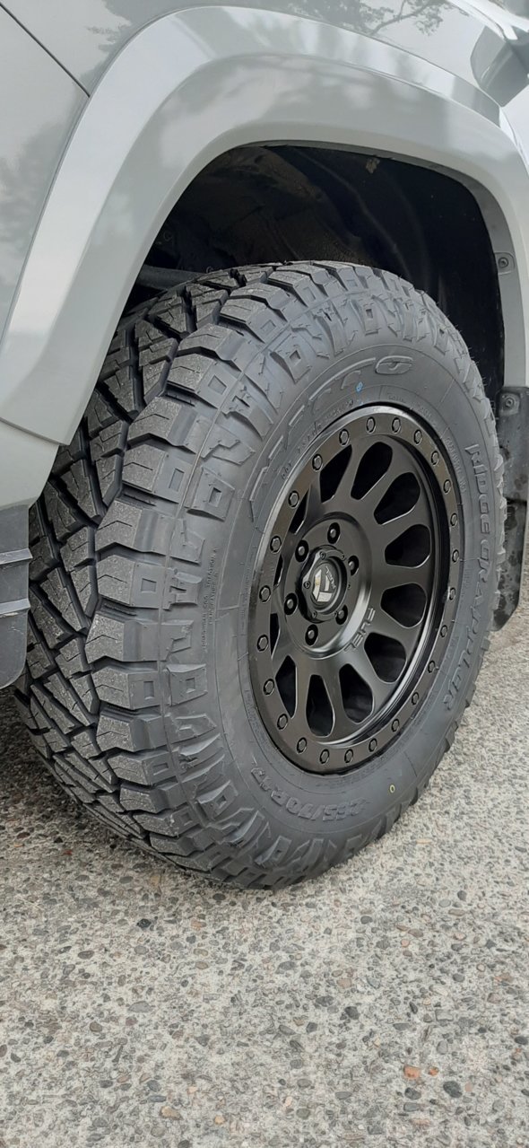

    Tpms swap from stock rims with no problems and if youre wondering if you can fit 32's without a lift and have no rubbing, you can! Mine are 265/70r17

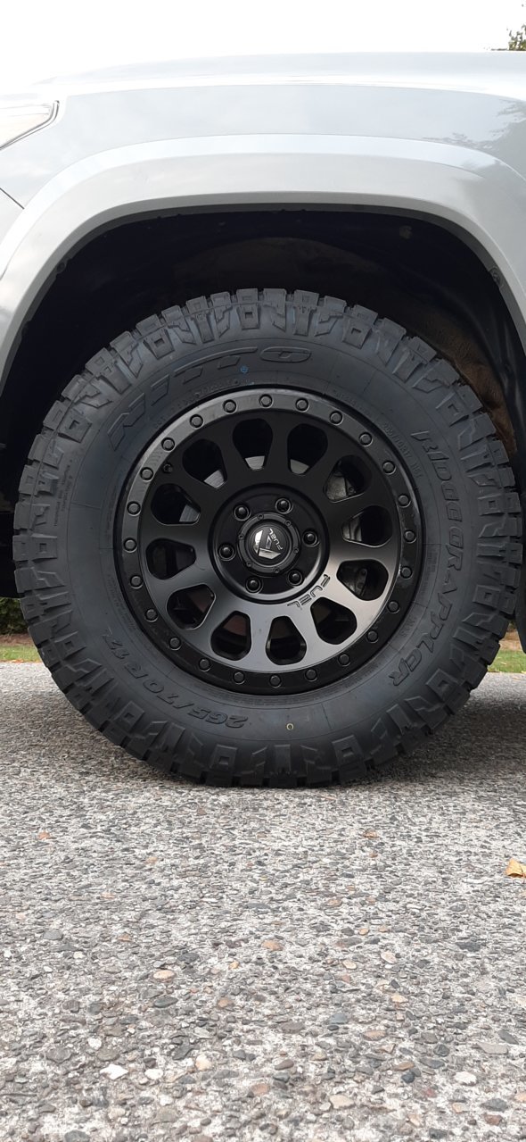

    Its pretty much flush, sticks out just a tad bit. Also just incase you don't know, someone on tacomaworld told me that positive offset pushes the tire in towards the UCA, negative pushes out which normally causes rubbing on the cab mount. So make sure you've got the right size tires or lift so you don't rub anywhere! Btw online pictures don't do these rim's justice, I didn't have the money to afford SCS ray10's so these were the best alternative I could find for a much cheaper price and I'm really glad I went with them. Looks awesome in person.
