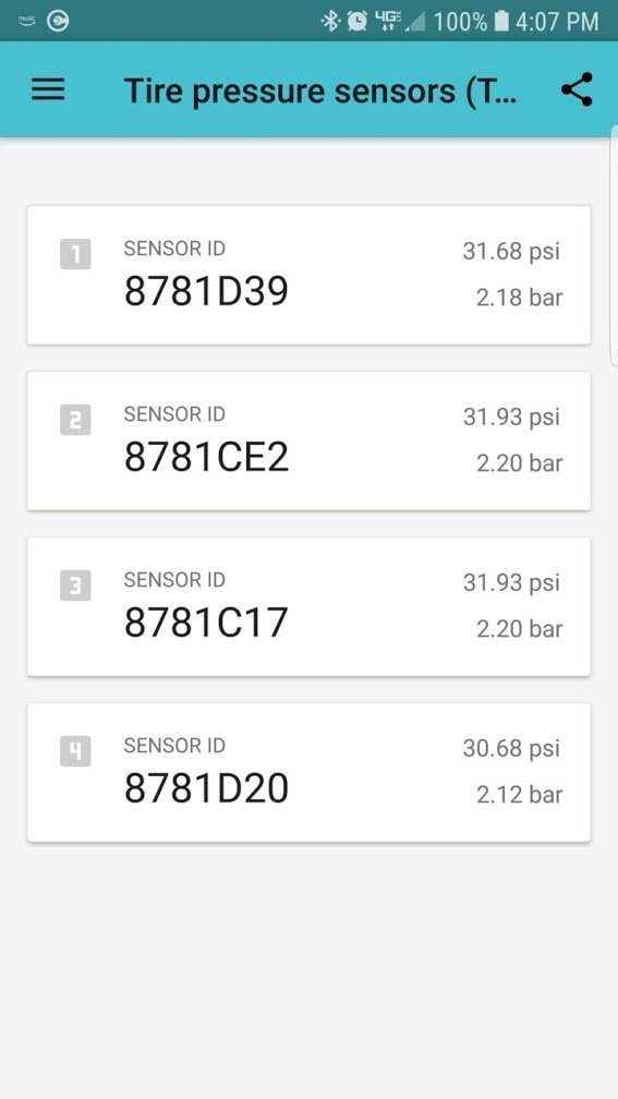

    The only hard lesson here is not having the Sensor IDs written down. With that, you can try whatever you would like.

    TS is certainly cool, but! it is not extracting info. It is just presenting what was entered into memory. If you don't have them saved in notes somewhere, the only way to get the info is through a scanning tool or physically looking at the sensors.
    Of course, saving a screenshot (Shift + WIN key + S) is easy.

    Other automaker's TPMS may report different info to the factory ECU tool.
    If there is a learn feature in TS, I think a lot of folks would appreciate that nugget of knowledge.
    Just for clarity, your Autel tool definitely will tell you for all TPMS sensors. I (and others?) are just not aware of that ability in TechStream.

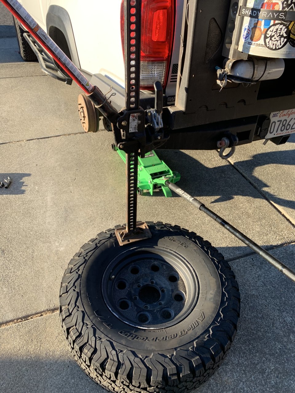

    Alright fellas.... I got home. Installed the new sensor, reprogrammed it, the truck accepted all 5 but only show record of 4.... I’m driving this bitch now to get my daughter pizza.... the PSI showed up before I hit the block....
    When I get home, I’ll rotate the spare in... leave the one I’m rotating at home to avoid the truck picking it up on the rear carrier....
    I’ll hit the little magic button beneath the dash and we will see if the truck recognizes a 5th tire in a 4 slot memory.... fingers crossed

    If the car blows up on you after you hit the button, I'm going back and editing my post to hide evidence. Impressive getting the sensor installed that quickly; do you have a tire machine at your place?

    and nah, man... hi-lift jack off my rear bumper.... I’ll post photos.... I’m used to fixing things on the trail LOL actually.... I have a photo....

    Fancy. As long as you don't pinch your sensor in the rubber... er, tire.

    Yeah, that was the broken sensor.... I believe.... now I just keep the sensor on the opposite side.... and even with a broken bead.... the other bead is so tight that the tire won’t spin on the rim.... tire won’t go out of balance....
