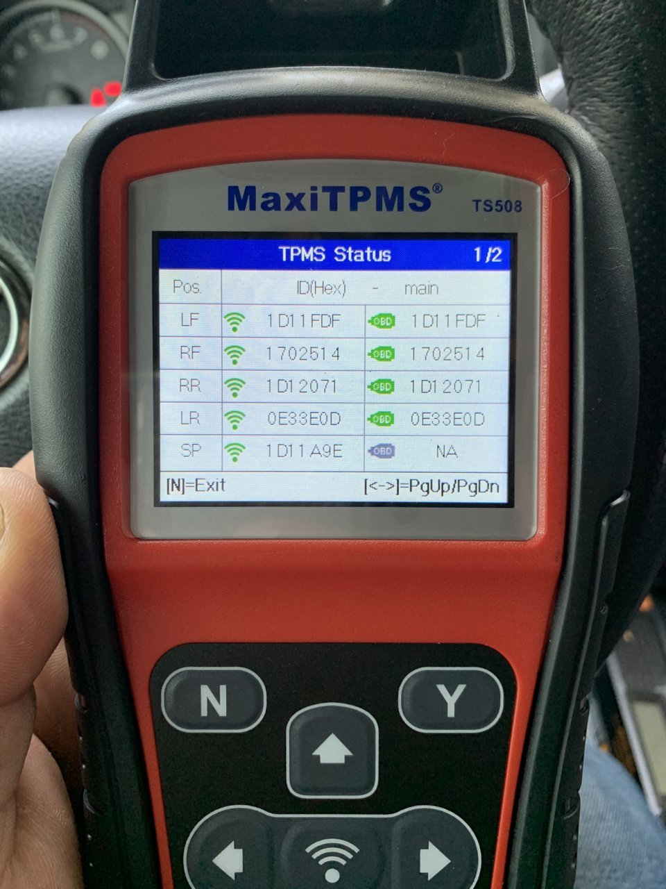

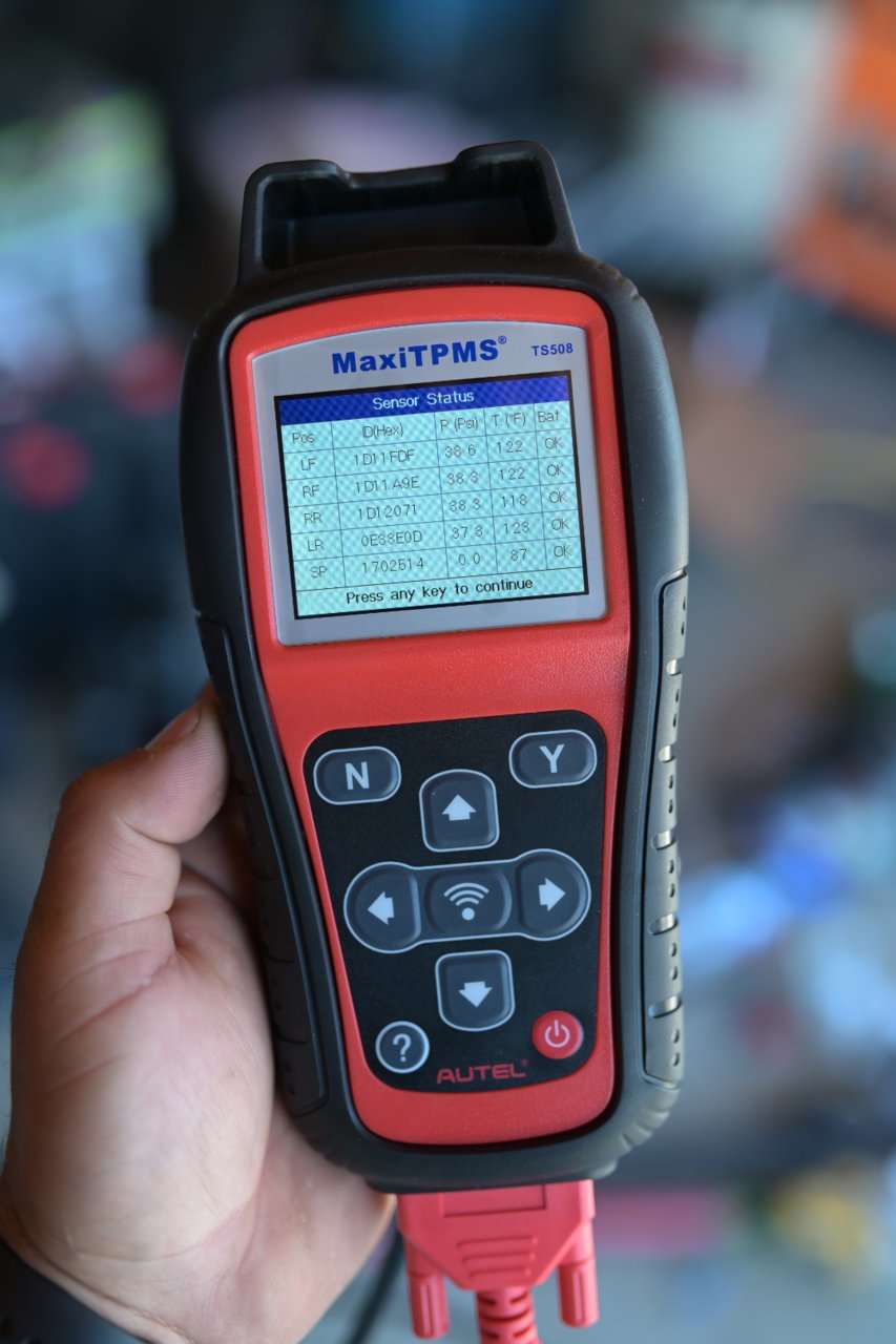

    I said screw it and I used my tool and “relearned” positions, it all worked... more importantly, proved the MX sensor is read and recognized by the truck/ECU
    Currently I have two NON-OEM sensors on the truck and my tool was able to write the ID’s to the ECU without a problem. One TPMS is from Orielly’s Auto Parts and the tool was able to write that one no problem.... the MX-TPMS needed programming since it is a universal tpms.... the tool was able to do that no problem.
    Verdict?!
    Tacomas only have 4 slots of TPMS memory.... programming the 5th will NOT allow you to “relearn” tires after full spare rotation by simply using the tpms button on dash.... sorry
    While the tools require you to scan a 5th (Spare) TPMS and the ECU “learns” 5 sensors.... when you extract the info, it only calls out 4 slots of memory.... I can’t explain it and it really doesn’t matter to me anymore.... I have the tool and it is exactly doing what I need it to do.
    if you guys want to save money, I highly recommend the Autel TS508.... in retrospect, I would have paid the additional $250 for the All-in-one tool to read Engine trouble codes and diagnostics, but I’m okay with keeping my bosh for the motor and this for the tpms

    Photos for reference, my dudes.... the screen is really clear in reality, the frame rate on the camera did not play well with the refresh rate of the screen

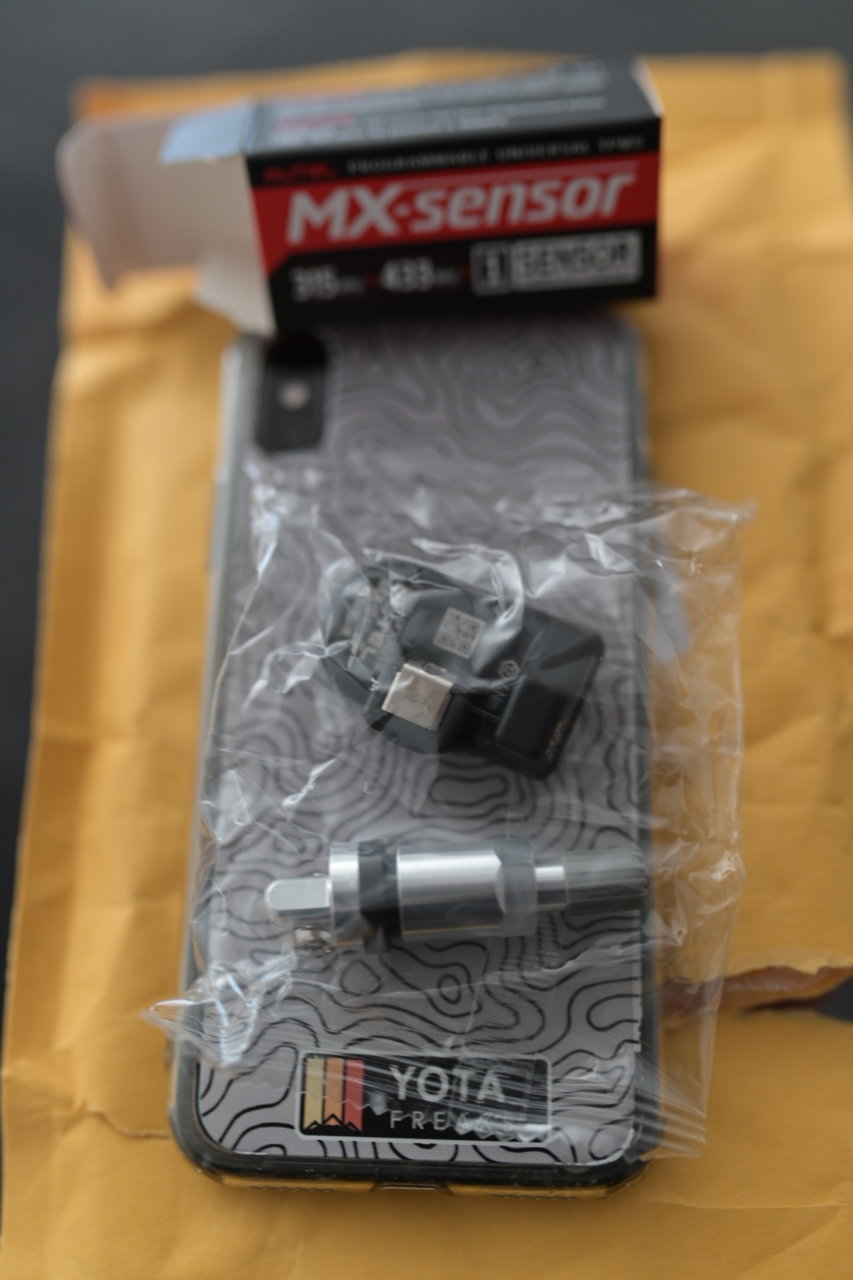

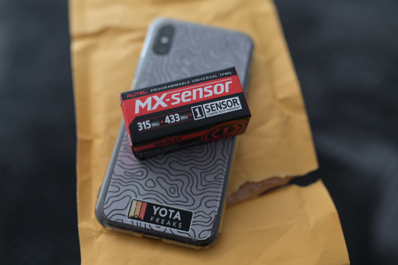

    first two photos are the Autel MX Sensor... hella high quality... felt OEM

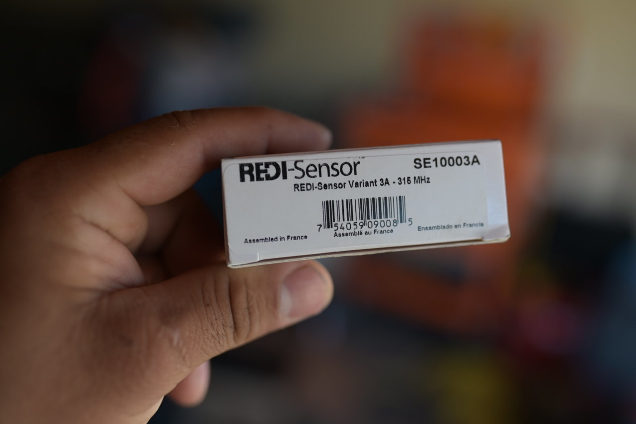

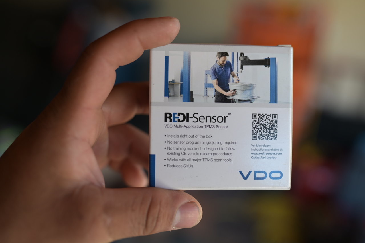

    photos 3/4 are what the parts store tpms look like. They don’t need programming but you do need to “relearn” them.... which.... means.... programming? It’s dumb....
    and notice on the final relearn.... the sensors, their ID’s and positions on the left.... ECU ID’s (they match when relearned) on the right.... see? Asked for 5 and only shows 4
