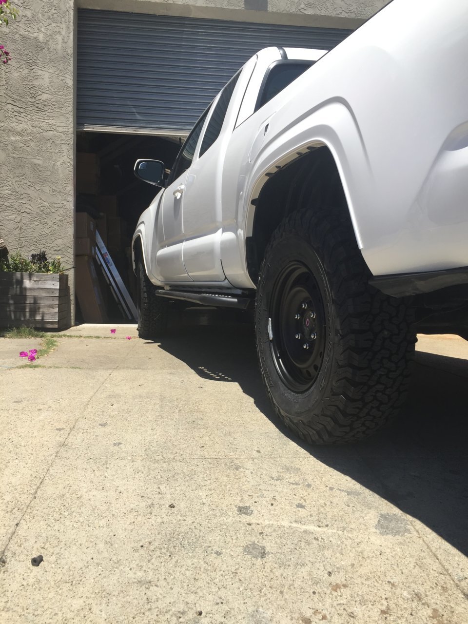

    I'm also in the same boat with the sensors. Switched from the steel standard tacoma wheels to steel spares, and the sensors didn't fit! So now I have the giant idiot light on all the time. It's right in the middle of the instrument cluster on the 3rd gen tacomas. I'm confused on this post because the pictures won't load? I vaguely understand the concept; you're making a Plastic chamber you can compress with air that has a TPMS sensor in it? And buy you only have one instead of four? If you could give me any advice here I would appreciate it! Thanks

    All four sensors programmed to the vehicle have to be in the chamber device (pipe bomb, wheelbarrow wheel, etc.).
    The spare steel wheels require the 20 degree sensors; the "styled" steel wheels (the ones on the four corners in lieu of alloy wheels) use the 40 degree sensors.

    Nice! okay yeah this makes more sense now. I think I'm going to try it out this weekend, I have the factory sensors from my stock wheels still. Seems like the best alternative to that stupid dash light! Thanks!
