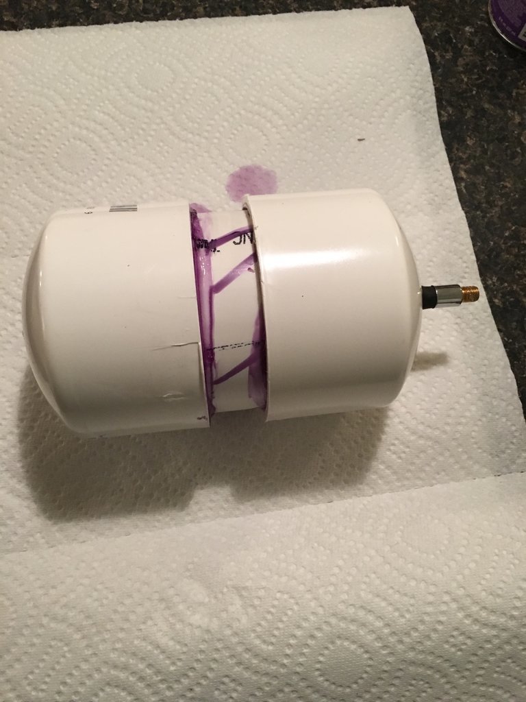

    I searched for a way to disable the TPMS on my 2011. I didn't want to mess with the wiring, but I did find this on another site. I used a 3" piece of SCH.40 PVC, two caps, drilled a hole in one cap and installed a valve stem, taped the TPMS valve stems together so they wouldn't rattle around, put them inside, glued the caps on, let it sit overnight, put 30 psi
    in it, sprayed some plasti-dip on it, put it in one of the storage holes in the bed of my truck, no more stupid light!!! Now when I put on my other tire and rim combo's the computer doesn't know the difference. Here is a link to some pics. http://s1237.photobucket.com/albums/ff461/rpking1/TPMS pressure tank/
    rpking, Jan 7, 2012
    I haven't had a bit of trouble from it, I haven't had to add air to it.

    Already ahead of you :) c557e06877f68033d84676def35f0d09_f38ee37f394f38418cd2ed29d868b9a6113594fc.jpg

    so you just put all 4 TPMS in that tube and add air to it, thats it huh
