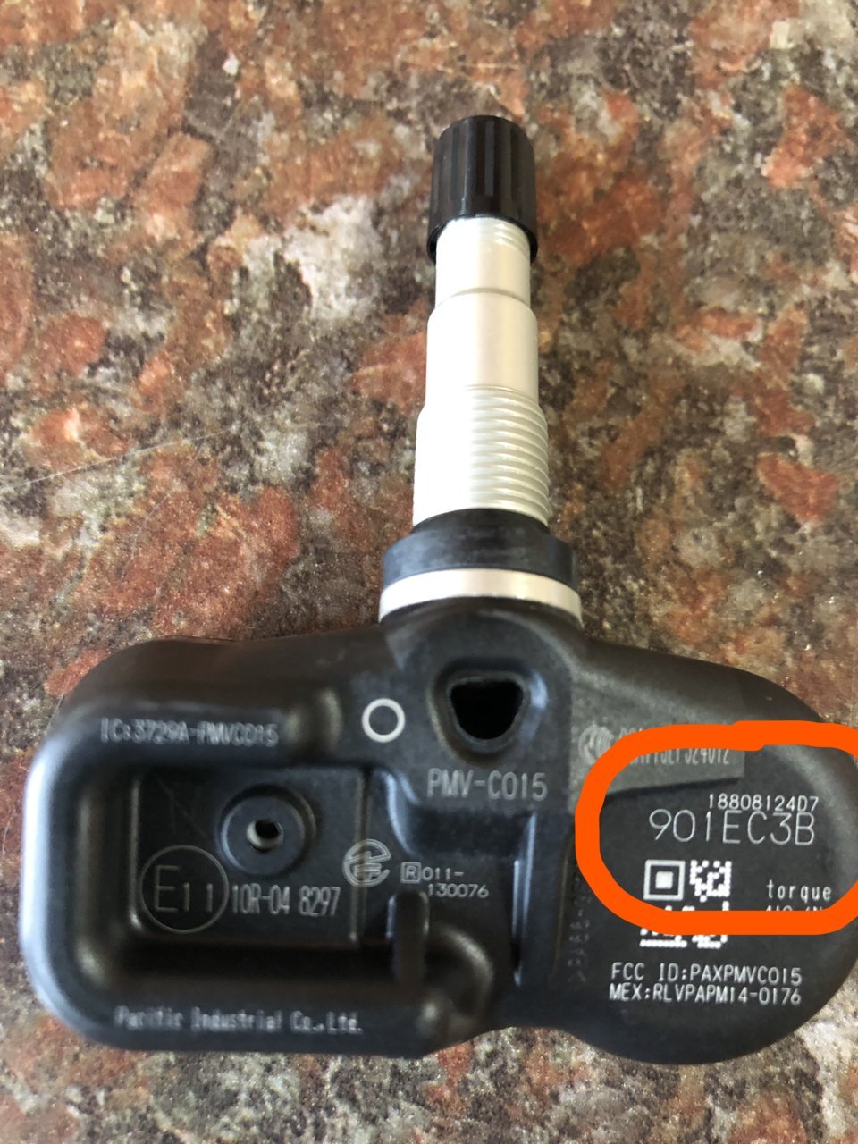

    If you don't have the ID codes for the new sensors, they can be read with a handheld trigger tool which any tire shop should have. You point the tool at the valve stem and push a button. Tool displays the sensor ID number, tire pressure and the "health" of the battery in the sensor.

    This is the code that has to be entered into the ECU.
    G.
