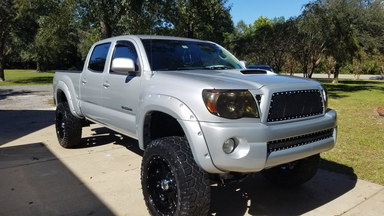

    MY tire sensors had given up the ghost before I bought my 2007 Tacoma about 3 years ago. My understanding is the OEM sensors that came on the truck had about a 10 year life span. I do not know when the aftermarket wheels and rims were installed as it was done by previous owner. I don't know if he used original TPMS or had to get different ones to fit the wheel and tire upgrade. Just figured I would change them out when I had to put tires on her. Well the dreaded day is close, I will need to mortgage the wife to put tires on this baby and want to put some long battery life sensors on it when the tires get installed so I don't have to go through this again in 5 years.. I have done a fair amount of reading on this and still come up unsure what part numbers I need for my specific application. help appreciated. 2007 TRD Sport with 6" lift, 20" rims, 33" tires.
