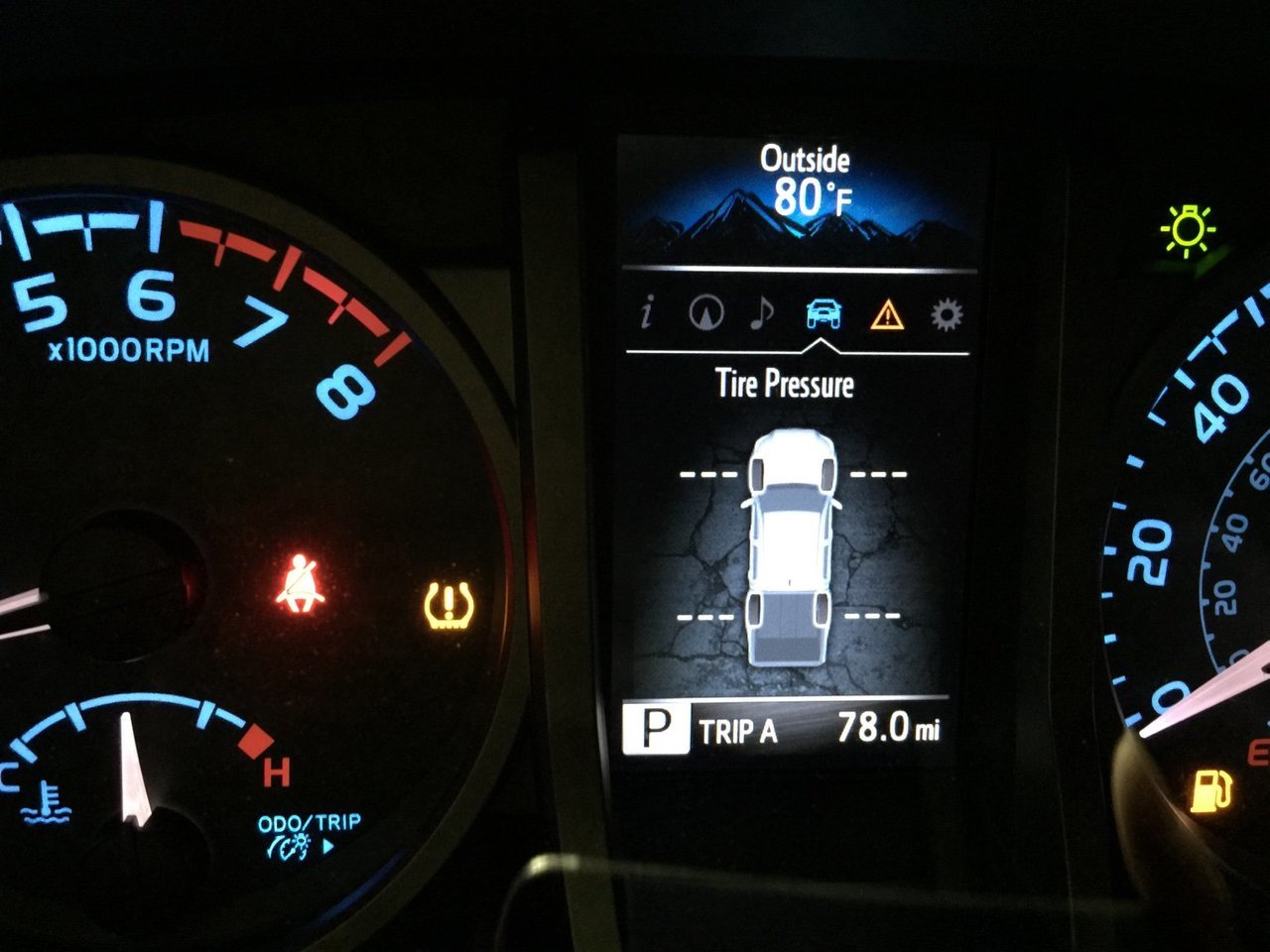

    Wait. But did you scroll to dfc253e7b1204c08781cb08ae95bad21_fb669dc347309539b5b2a003745a336272a611ef.jpg see how there's no read out for psi at each corner. If you have numbers at all four then you're driving around town with your old wheels in your truck bed or you never left the house lol.

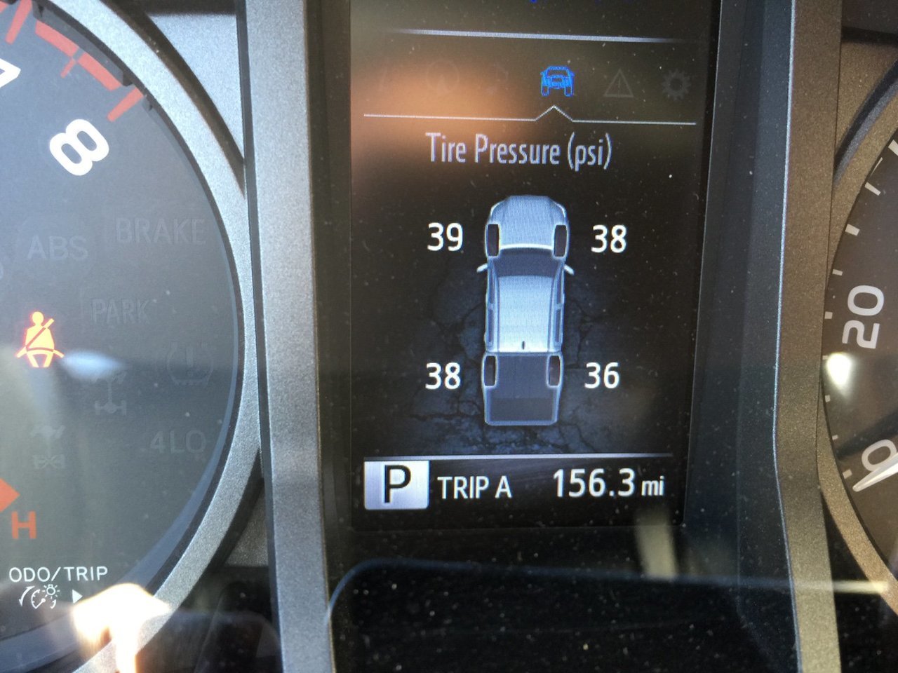

    Now oem TPMS back in wheels 34c67ecf694f44811d6946269b8fa0c5_77c5456b2349547bf57844b61a929b4a3820a135.jpg

    Yes, I scrolled to that screen and got all wheels as "---".... Still NO LIGHT.... Perfect... I'm Happy.... The tires are in the garage for the winter...!
