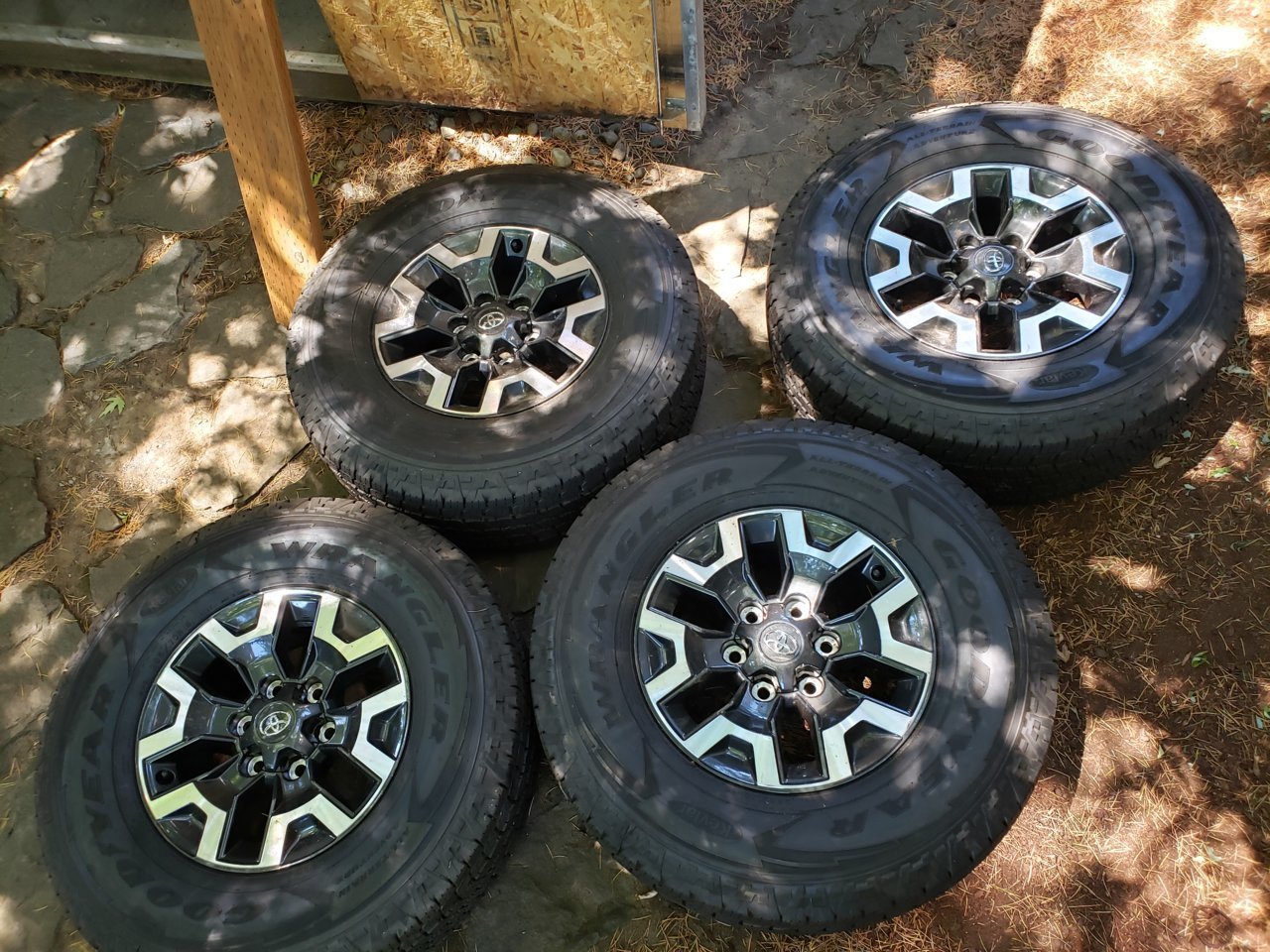

    I bought some tires and wheels off of a 2018 TRD Sport, I think. They look like the attached picture. The TPMS from my 2017 SR wheels do not fit. Does anyone have the part number for the TPMS sensors that will fit these wheels?

    For what it’s worth, my SR5 had steelies that the dealership switched out with alloy rims before I bought the truck- and used the steelie TPMS- just rotated them 180 degrees (I think)- 53k miles on these rims and no issues.

    Those are TRD OR wheels.

    Sr has steel rims. Alloy and steel rims use the same sensor I believe but it has to be turned around for alloy rims. If I’m wrong then I’m wrong.

    But here's the alloy wheel TPMS part #42607-06030

    Toyota has been known to change part numbers without notice but other TWers have switched from steel to alloy just by using the same tpms.

    The TPMS wheel sensors are different from alloy and steel. The angle of the stems is what is different. You can use the steel sensors, but you have to rotate them 180 degrees. That makes them easy to break. I went with aftermarket sensors from Amazon https://www.amazon.com/gp/product/B07VZFDCL4/ref=ppx_yo_dt_b_asin_title_o02_s00?ie=UTF8&psc=1 . You don't have to get them from the dealer as long as you get the correct frequency. Regardless of where you get them, you will have to program them into your TPMS ECU. That can be done at most tire shops with a handheld device or you can use techstream and program them yourself.
