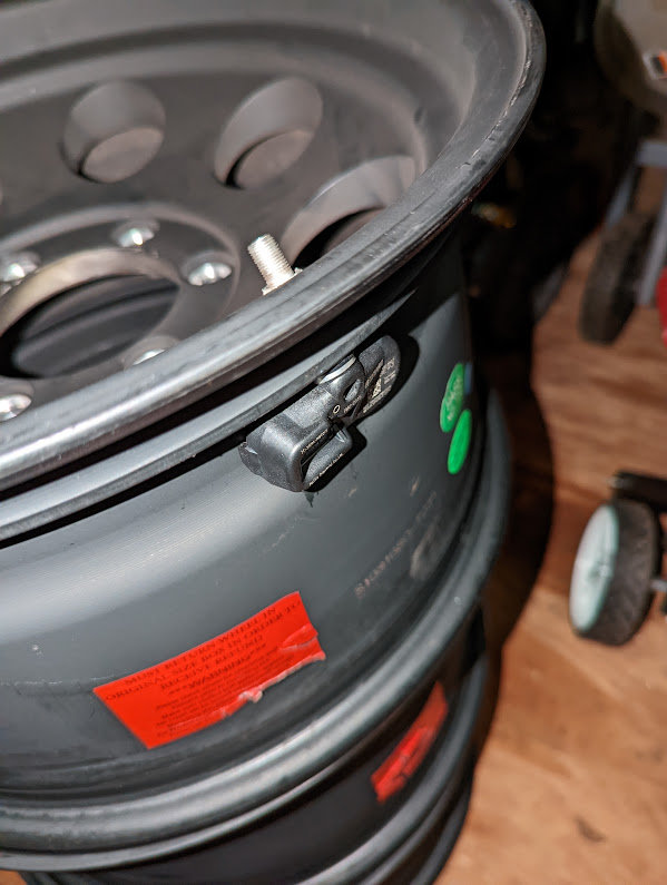

    maybe we can bust this myth
    Alloy wheels with SR TPMS sensors (not flipped around) dont automatically assume you need new sensors
