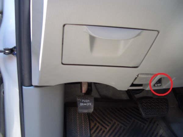

    65 is the MAX psi for those tires. Do a Chalk test, and see what psi you need to run. Odds are, 32 or so is fine. The TPMS can be reset by airing the tires to whatever psi you want (spare included), and push the "Rest" button under the dash.
