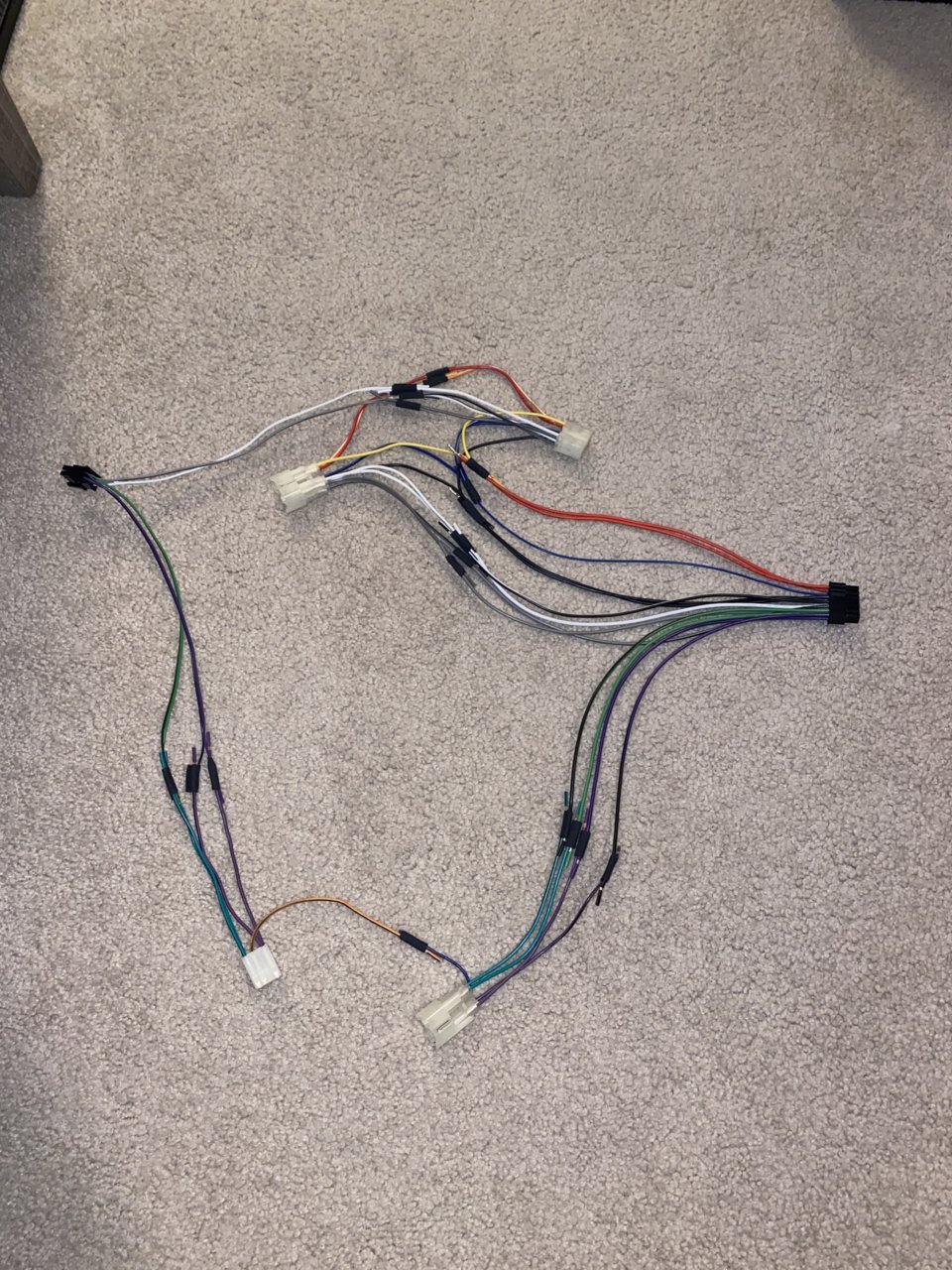

    Long time listener, first time caller! Wanted to thank tpp4 and destin_meeks for all the content here. Just built my harness yesterday going step by step with the guide. I used an Alpine KTP-445U 4-channel Power Pack Amplifier instead of a Kicker Key (not a lot of availability and the price was better). Worked like a charm! My truck sounds amazing! Kicker door speaker upgrade and the Subaru tweeters mixed with some Noico sound deadening in the doors and back panel. Thanks again for all the great content in here. I wouldnt have been able to do it without cha!
