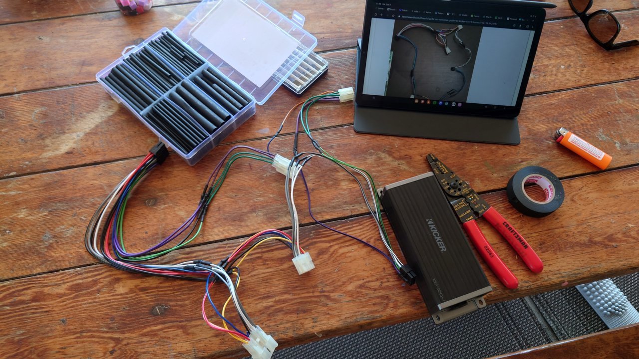

    Thanks go out to the OP and destin.meeks and others who shared their knowledge to make this thread an awesome resource for adding the Kicker Key 200.4 to the 2016 Tacoma with Entune stereo.
    After doing the Subaru tweeter, replace the door speakers, deaden all doors, add a powered 10" sub behind the back seat, stuff the fun pool noodle in the gap between the cab and bed, now I can finally enjoy the music in this truck because I can actually hear the back door speakers work.
    It was hard to get the pins of the blue wire out of the Metra harness. It took 2 people and an ice pick to unlock and pull them out.
    After that, it took me 2.5 hours to twist wires together and heat shrink the T harness joints. Then I pulled the stereo from the dash, figured out which plugs to pull from the bottom corner of the stereo, swapped them into the harness, plugged the harness into the stereo and to the amp, stuffed the amp under the stereo upsidedown, and put the stereo back in.
    I still need to adjust the rear gain, but that is a work in progress alongside trying to fade up to the front on the stereo unit...
    Thank you for sharing this modification Tacomaworld

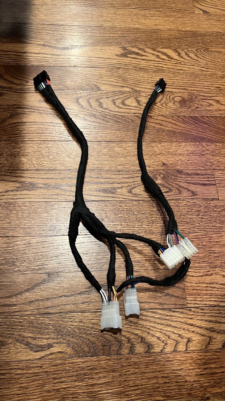

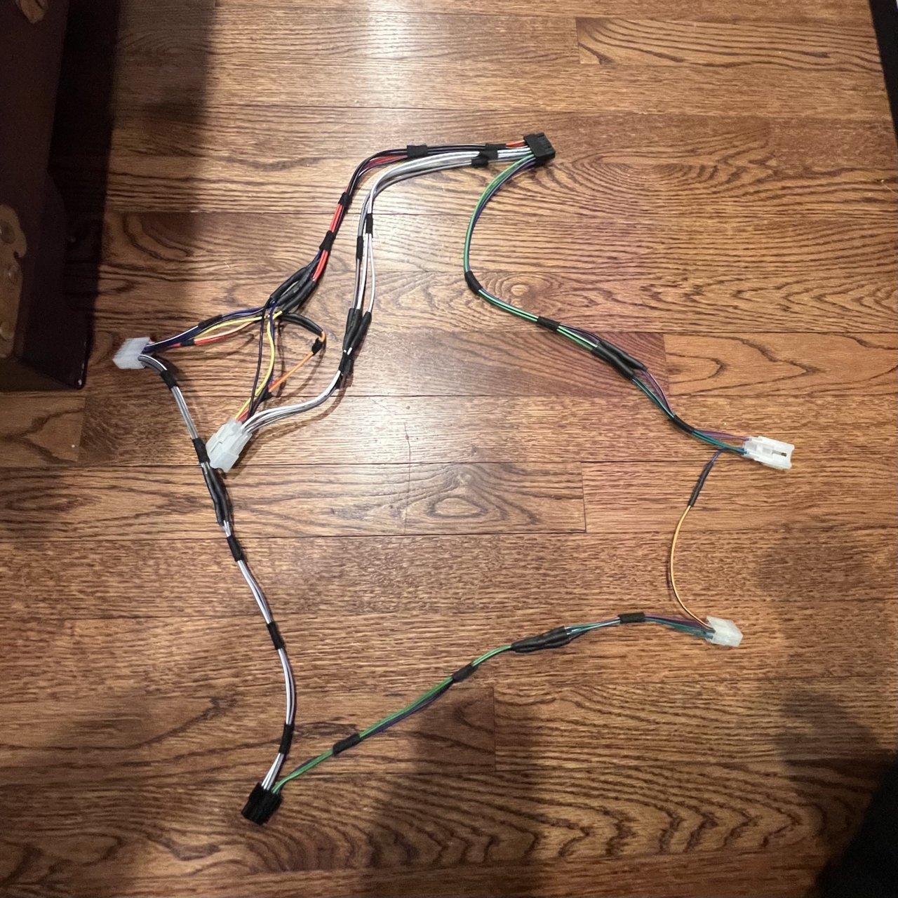

    @destin_meeks , long time reader, first time caller. How’s this look?
  16. Mar 1, 2023 at 6:29 PM
    #456
    destin_meeks
    destin_meeks I used to fix people's crappy stereos
    Jul 14, 2017
    #223997
    3,944
    Destin
    Tuscaloosa, AL
    2017 SSM DoubleCab TRD Off-Road 4x4
    Looks spot on to me!
