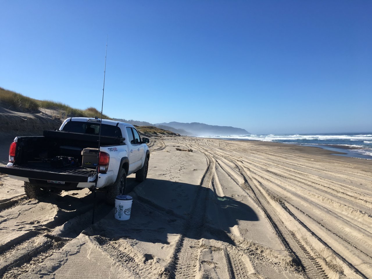

    Sounds like this horse is being beaten to death thoroughly, so I'll throw a few tips out here too lol
    I like to surf perch fishing in some pretty remote areas so I drive in some deep sand pretty often. My fav fishing beach is on the other side of a very steep dune, so I have to have my shit dialed to even get over it to go fishing.
    Here's my $0.02 of opinion -
    1) Turn off traction control by holding down the button for 5sec
    2) Air the f down. 15psi will get you over and through anything lol. If you're worried about airing down that low, just go down to 20 psi. It's really hard to roll a bead at pressures over 12 psi by just driving around on sand, so don't sweat that.
    3) Get a set of Staun tire deflators if you feel like spending some cash on something useful, if not, just use your key to air down enough to have some belly in the tire.
    4) Put it in 4L to optimize torque distribution. You shouldn't need speed to gain traction, quite the opposite actually. If you're driving on sloped shit, use your digital level monitors to avoid rolling your truck over.
    5) When I'm done fishing, I use the Viair 88p to air up. Whatever you do, do not buy a compressor that plugs into your car lighter plug - you'll blow a fuse. Get one that connects directly to your battery. An onboard air compressor is overkill for 99% of the Instalanders on this site. Save your cash buddy.
    Hope this helps. You owe us pictures of your adventure. Here's a pic from one of my fishing trips to inspire you
