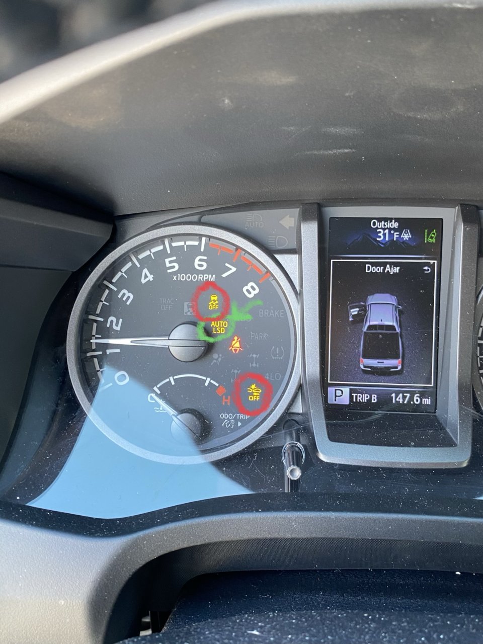

    I want to know more about auto LSD......

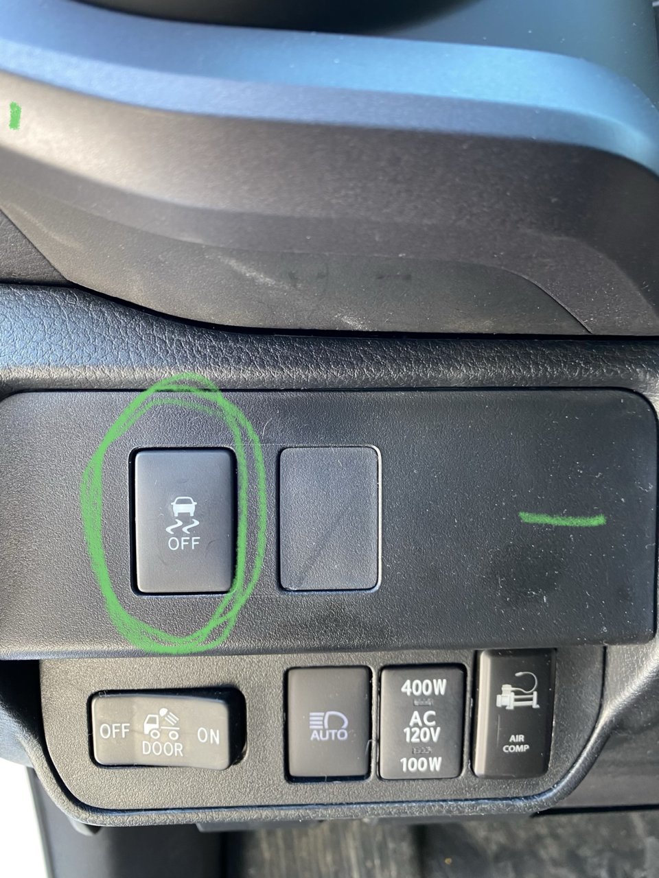

    * This represents my current understanding...which may be flawed.
    It's this button to the left of the steering wheel.
    When enabled, the following lights (marked) are displayed on the dash.
    The AUTO LSD is the feature that will automatically break a spinning wheel to divert power to the other. When enabled, it also disables traction control and the pre-collision stuff. When I find myself on a slick surface where my rear is spinning, I'll push the button and get enough of a shove to continue on... but if I give it too much gas, with the traction control off, I can flip the rear. This has been really handy this week on the first icy snowy roads of the season. ... and it's handy if one were to want to drift a bit in the snow.
    I hope this helps.
