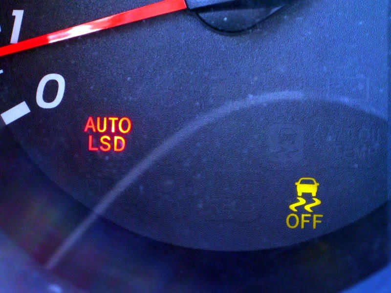

    1) The VSC OFF button is in this group... STOP the truck, and push and HOLD DOWN for a few seconds:
    This light will come on:
    KEEP IN MIND, that if the truck feels threatened and close to tipping over, it will re-activate the Vehicle Stability Control to save itself, even it you want to roll it.

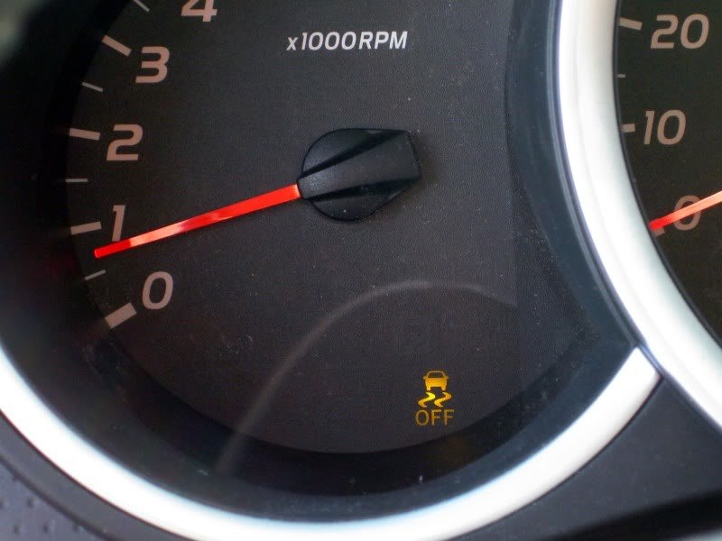

    AUTO LSD IS TRACTION CONTROL... It is MORE control than that standard TRAC limited slip system. AUTO LSD is turned on with just a quick push of the VSC OFF button, moving or stopped. This is what it looks like under 30 mph:
    Above 30 mph, the VSC turns back on.
