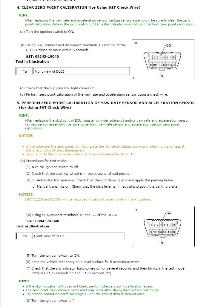

    I have it occasionally. From the research ive done, it seems to be a yaw sensor issue, where the stock rake of the vehicle is no longer there, thus when you hit a bump or in my instance turning into a particular parking lot at an incline, the yaw sensor thinks your front end is higher than it actually is, kicking in traction control. I had my dealer recalibrate the yaw sensor and it definitely helped, but didnt completely eradicate the problem. Hope this helps

    Yep...VSC recalibration.

    Where'd you have it aligned?
    Dealer is supposed to recalibrate after an alignment job...

    Need Techstream to do it; something I doubt they'll have.
    I just didn't want to see the dealer double dipping your pocket.

    I forgot; you can do it manually.

    It says you have to have the vehicle level within one degree...
