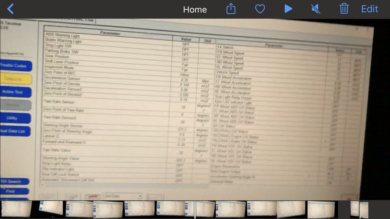

    Very hard to record in a parking lot steady but I got some details. The steering angle sensor is or seems to be reading correct. All values for yaw and steering were zero when sitting still. I drove circles in the parking lot till I got the light to kick on. Hard to tell but like mentioned. Around 360 degrees of steering while accelerating and I was only going 7 to 10 mph the light kicked on. The yaw rate was 30 to 40 degrees. One of the pictures I snapped because it was a right turn into the parking lot and a split second the left from wheel traction engaged. C4EE306B-0083-405C-80FF-27C429592DA9.jpg

    This is an interesting thread, hope you find a solution. Being a tech my self (I specialize in European cars unfortunately) I feel your pain. These are the types of things I deal with regularly. Like previously stated you might need to hook up with another Tacoma owner and compare sensor data. The sucky part of not having any codes is what ever data or inputs the system is currently getting is seen as “valid data”, so as far as the car is concerned everything is functioning fine.
    Sorry if this has been mentioned or already checked but make sure the ABS sensors aren’t dirty, make sure they aren’t loose and maybe check the yaw rate sensor and make sure thats not physically lose either. I hate to admit I don’t even know where the yaw rate sensor is located on our trucks but I’ve seen on the vehicles I’m familiar with where they’re mounted under the back seat or under the center console and the 6mm bolt backed off and the damn thing is producing erratic data.
