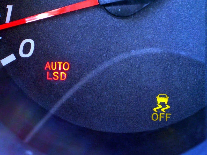

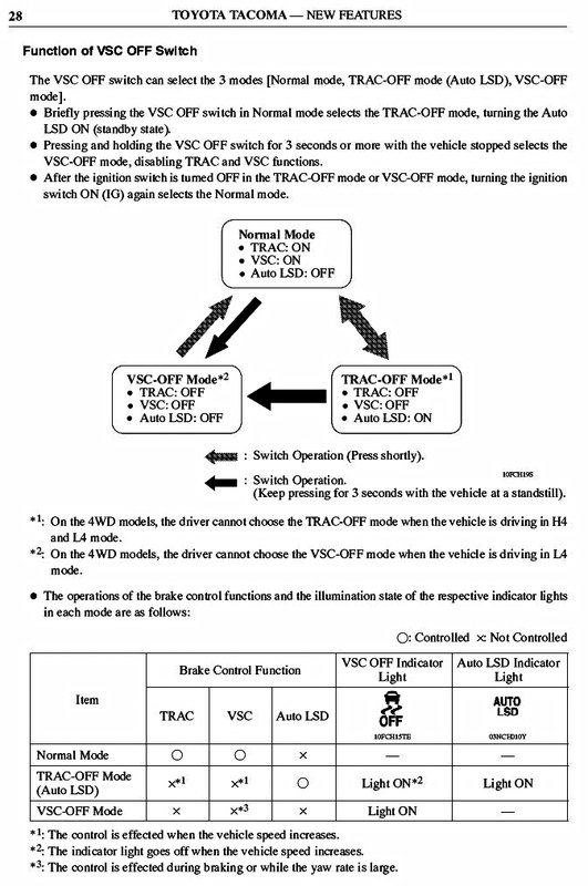

    I didn't see one suggestion to press the VSC button and go into AUTO LSD?
    AUTO LSD is Toyotas little gem like what GM called Posi-Traction, only it uses the brakes instead of differential clutches to slow a free spinning tire to balance the traction across to the other tire.
    Just a quick push, stopped or moving to engage.
    The VSC switch is the car with wavy lines:
    Lights that come on after the quick press (2010 Tacoma). TRAC OFF light added in 2012.
    What the switch does: TRAC (standard mode) to TRAC OFF MODE (AUTO LSD) to VSC OFF (TRAC and VSC turned off) back to TRAC:
    ALSO, as been said before... take all that extra air out of those hard desert tires, too much!
