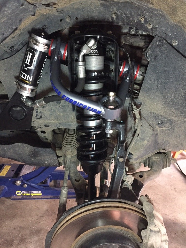

    Suspension:
    -Icon Extended travel w/ external reservoir coilovers with King 700# springs
    -Total Chaos UCAs
    -For 2.0 w/ external reservoir

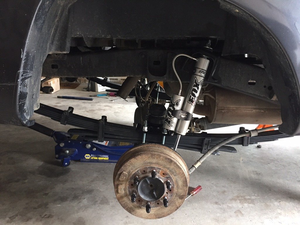

    -Dakar leaf pack + extra leaf
    -Wheelers U bolt flip kit with Timbren bump stops
    -Wheelers front super bumps
    -Archive garage towers (waiting on install)
    -Archive garage hammer hangers
    -Alcan custom 10 leaf pack (waiting on install)
    -Custom built Radflo 14" 2.5 rear shocks with compression adjuster and remote reservoir (waiting on install)

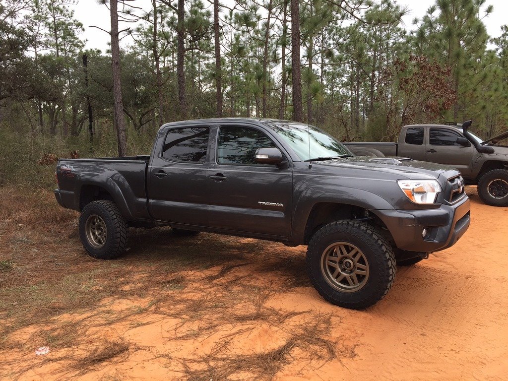

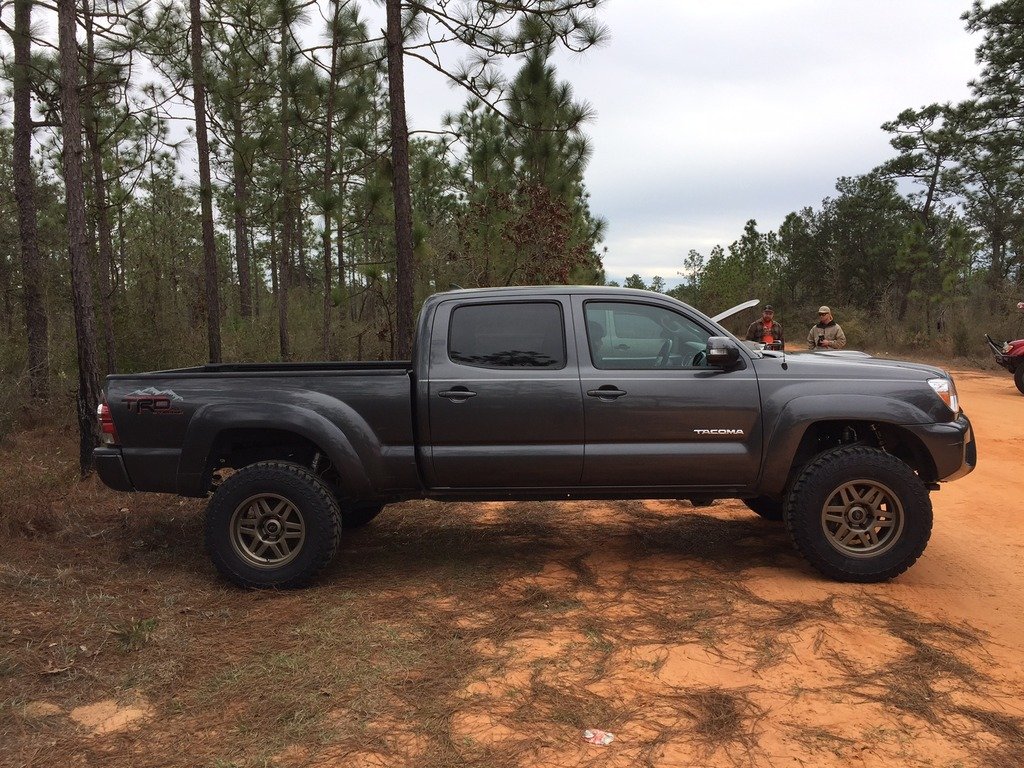

    First shakedown at Eglin AFB

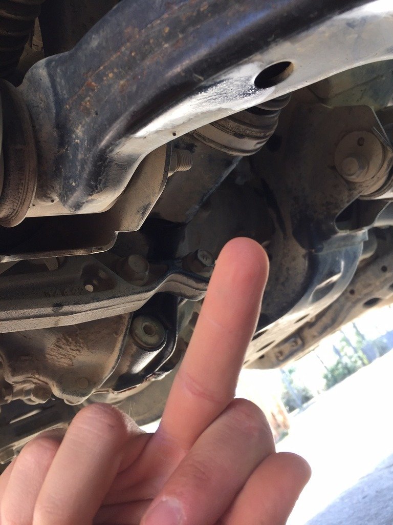

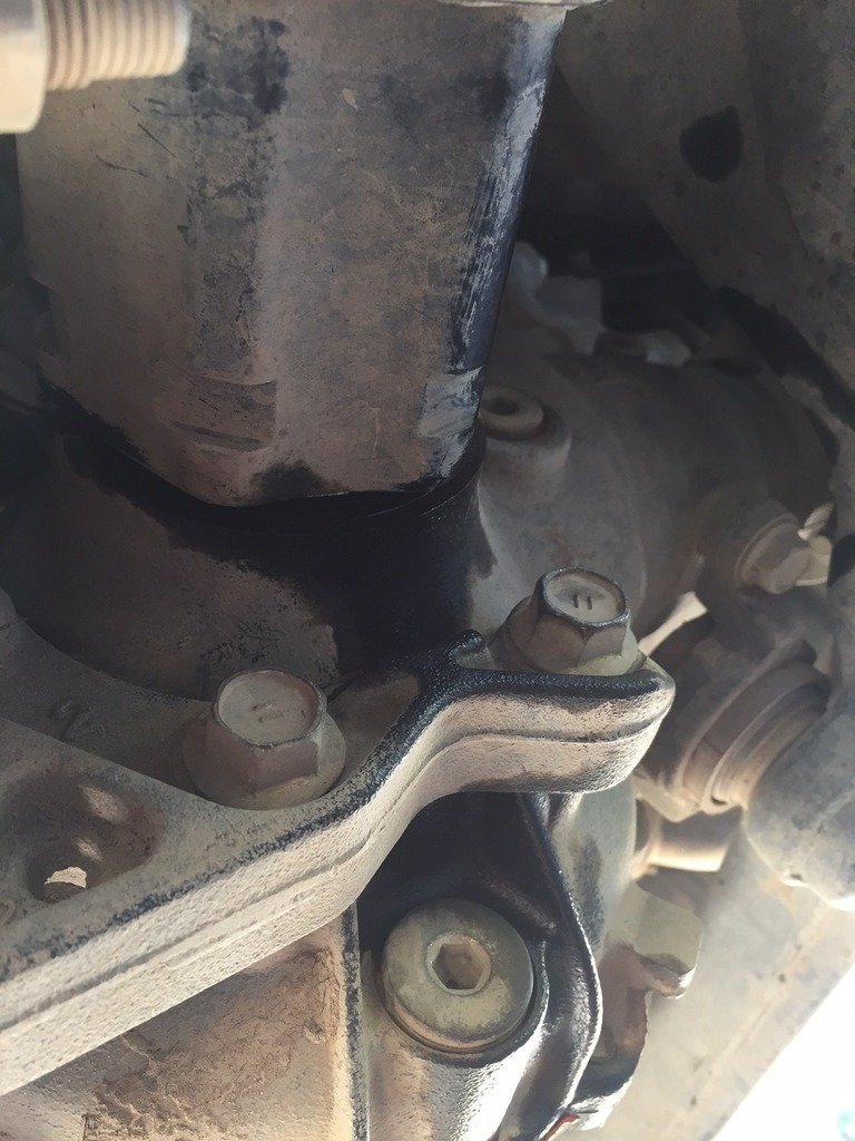

    No snow here in Florida. I found out today that i have the dreaded driver CV needle bearing issue and i developed a weeping fluid leak. I'll hit up the dealer first for some warranty work or call ECGS for their hybrid bushing.

    I had my needle bearing done too. Eventually did gears and air lockers from ECGS. The ARB locker replaces the needle bearing so I don't have that issue anymore.
    But I did have the bearing issue and dealer took care of me.

    I'm not sure how long a replacement needle bearing will last. But at the same time, if Toyota will replace it, why not

    So long as you're under warranty still anyhow. Some say the replacements aren't any better. Same flaw. The dealer who did mine told me the old bearing and new bearing were the same except for a very small difference in size.

    Ordered the ECGS bushing for my drivers side CV axle/front diff. I've developed a weeping gear oil leak and my axle now has a good amount of play compared to the passenger side.
    The truck is still under warranty, however, I feel like a new needle bearing replacement is only going to bandage the problem. At least maybe I'll get a new free axle under warranty work! :thumbsup:

    The ECGS bushing solved all humming issues. And I got a new driver side axle on Toyota's dime under warranty.

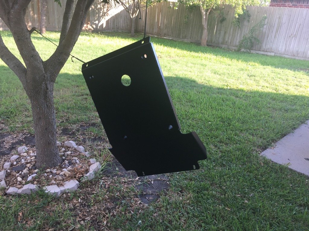

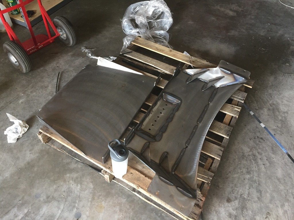

    Got my full set of skids from SOS.
    I painted my IFS skid, but the paint is not very durable, even after two coats. Besides powder coating, is there anything else I can try?

    Bed liner might be another option. Could get it LineEx'd or pick up the Raptor Liner kit and do it at home. There really isn't any coating that is going to hold up to bouncing and sliding off rocks, protestors, or crazy commies...
    Powder coating is nice and looks good new, but second you get a scratch or chip stuff just blows apart. I've also noticed that stuff fades like a SOB in the sun. LineEx I've seen to be the most durable out there. Could do a POR15 and then spray on bedliner on top as well.

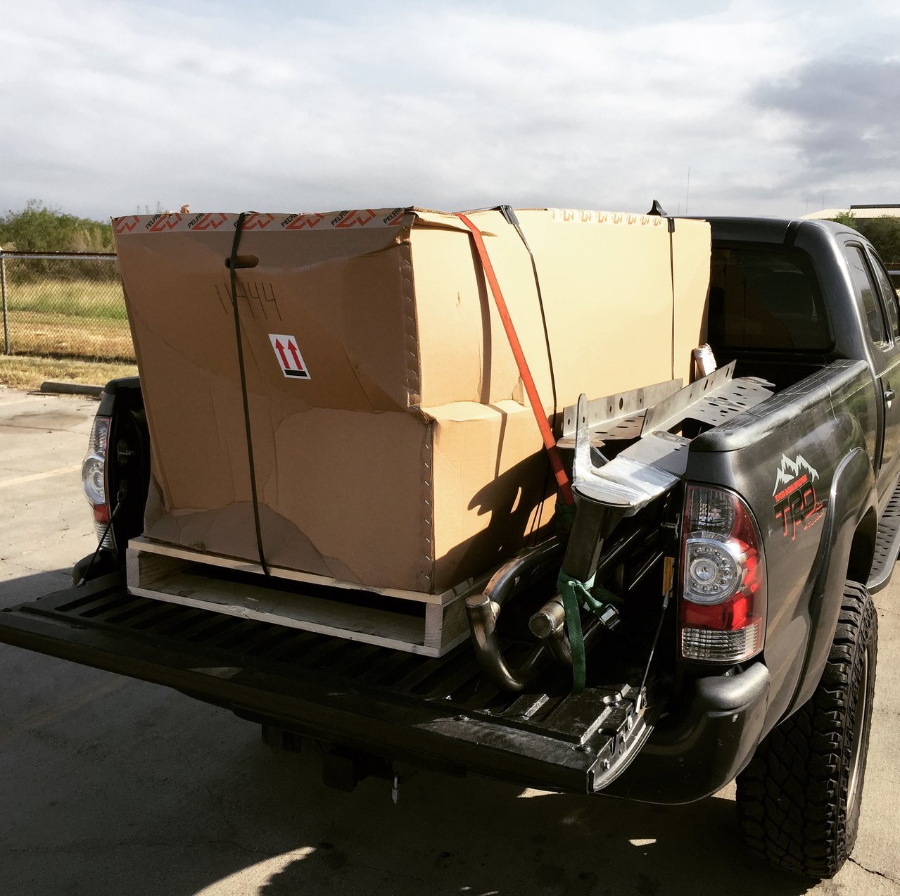

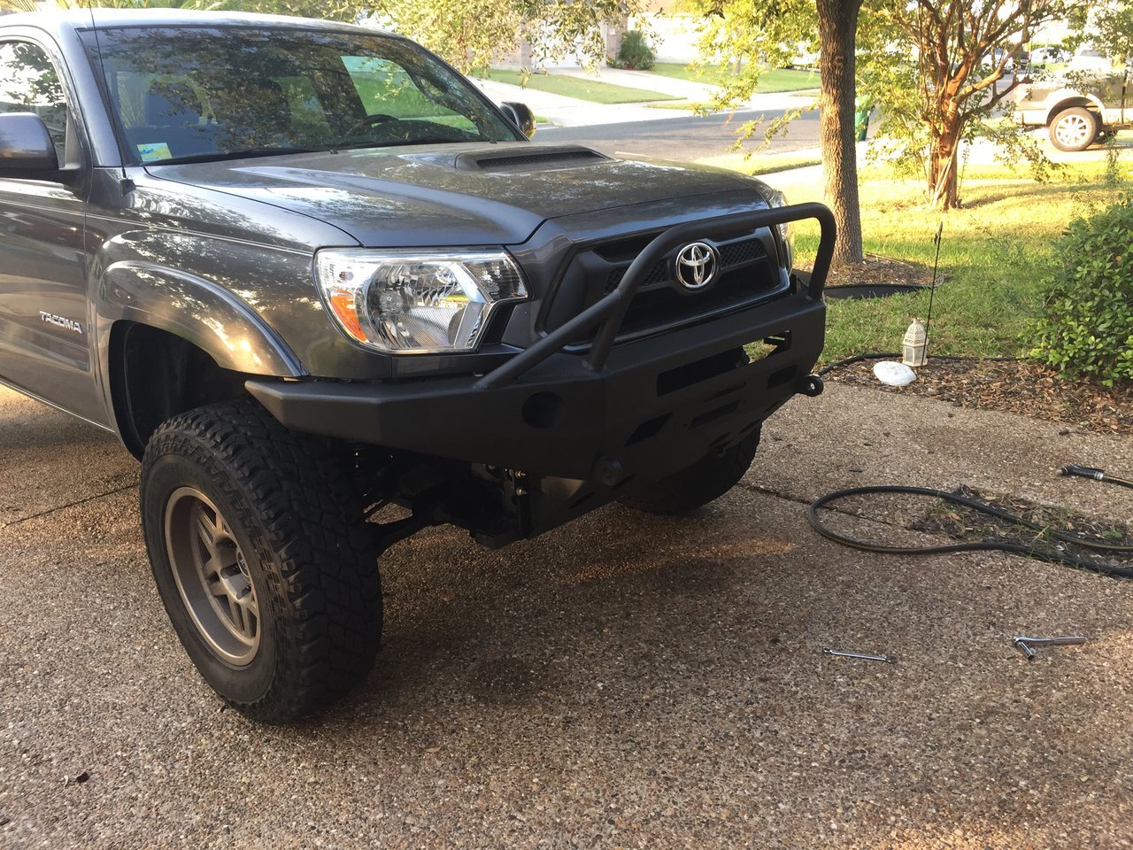

    Participated in th awesome @allpro slider group buy, picked up my apex sliders and @Pelfreybilt bumper.
    Day of pick up.
    Tested slider fitment, looks good!
    Quick bumper install.

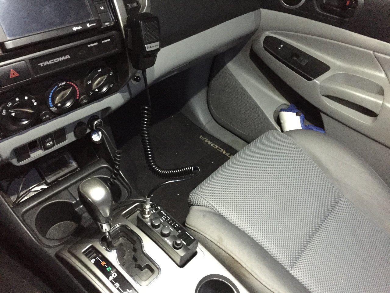

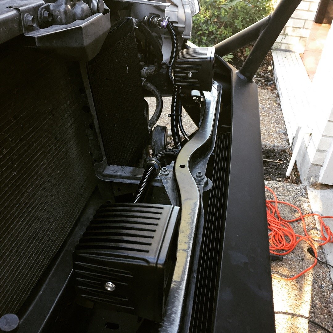

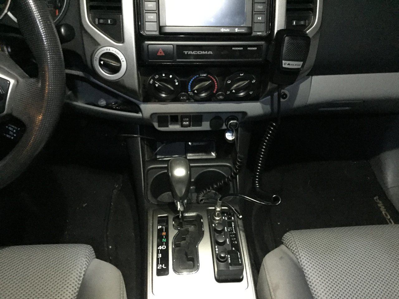

    In preparation for a trip in a month, installed my cb. I also got some lights wired up in the bumper.

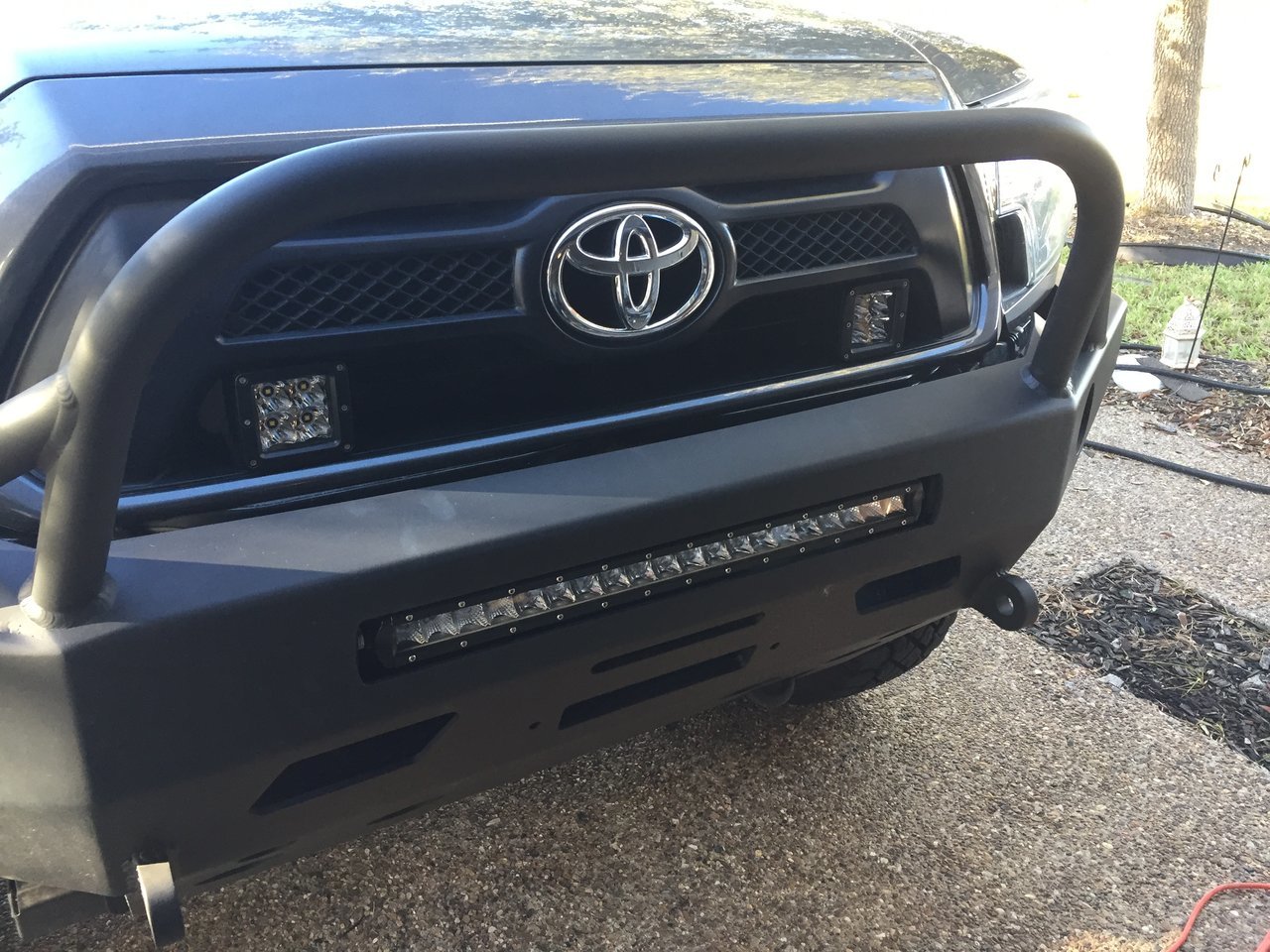

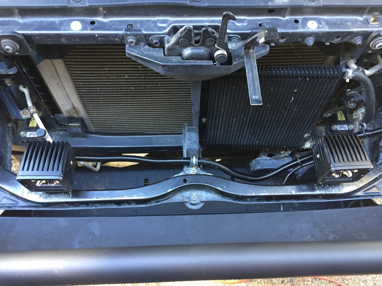

    Since we had a snow day here in Corpus Christi, I decided to finish up some projects on the trail limo.
    Installed the fog lights, found OEM pigtails and made it for an easy plug and play into factory harness.
    I had my bumper light bar installed and two spare led pods laying around, installed them into the grill and tied the harness together. Overall came out nice and clean.
