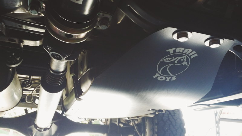

    installed it an hour ago, only difficult part for me was aligning the pins to go back in. Other than that easy and straight forward. On the plastic buckle tho i did add a long ziptie just in case it came loose.

    Your undercarriage is so clean.

    Glad to hear the install went smooth. Those pins can be a pain though.

    Loosening the bolt at the other end of the strap made the pin slide right in. Also, I didn't need to remove the pin at the rear.

    I cheated and bent the tabs on the rear pin. Did you do the same, or did it just fit?

    It just fit.
