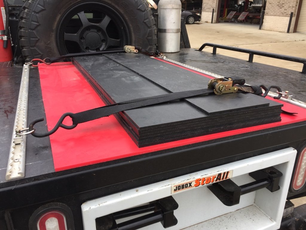

    I had the skid on during my last trip out, but didn't manage to drag it over anything. I did manage to twist my leafs, blow out my shocks, and break my drive shaft though. :eek:
    My gas tank has small scuffs and a few minor gouges in it. The skid will take that hit now. The UHMW will also rebound after taking a hit where metal will deform and keep it's deformed shape.

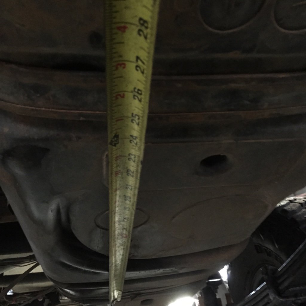

    Sure do. These are the measurements on my DBSB. I have a DCLB coming in Sunday, but we might as well confirm some dimensions.

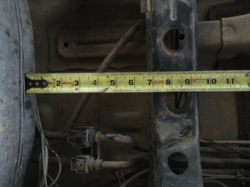

    From the front of the gas tank to the front of the cross member is about 9.5". The tape is butted up against the tank above the seam.

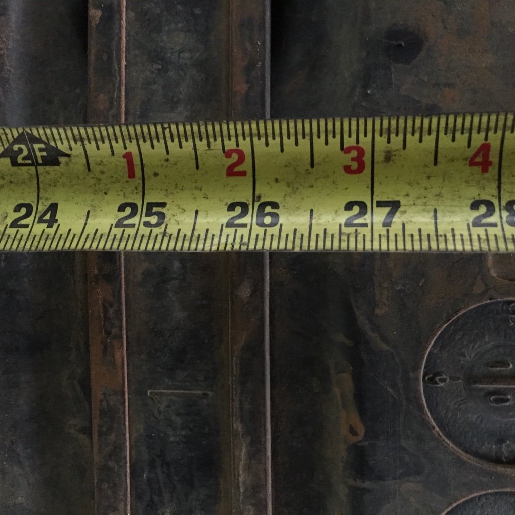

    The distance between the straps, out to out, is about 26.25".
    With the tape hooked on the back of the rear strap and measuring to the front of the forward strap.
    If someone can crawl under their LB, AC, and SC and duplicate these dimensions I would appreciate it.
