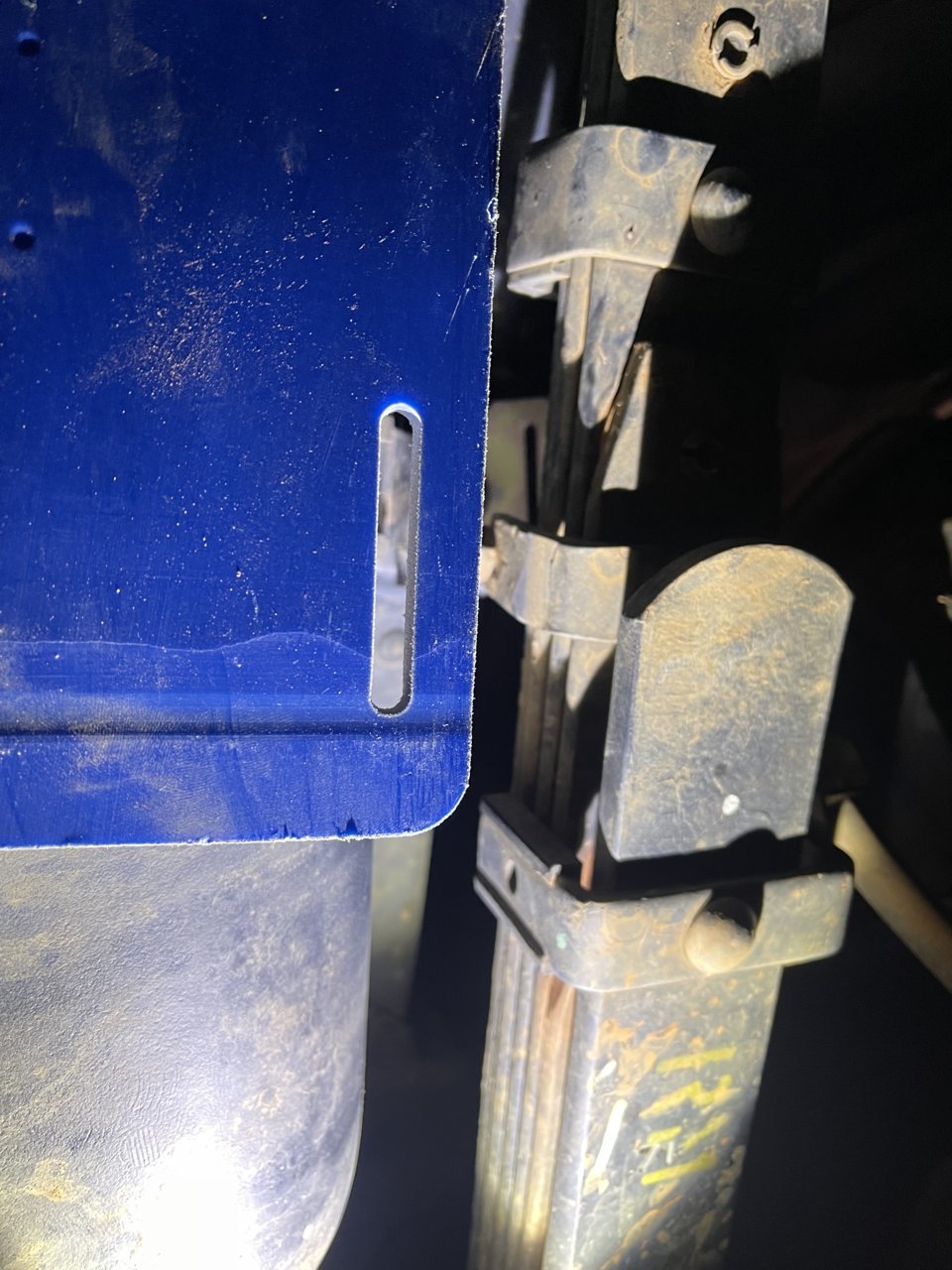

    ***NEED HELP***
    The strap by the leaf spring rubs on the leafs. I have the grade 8 strap thing oriented how it is in the pics.
    Also how many times do I feed the strap through the clamp part? Just once and cut off the excess?
    Lastly the black plastic clamp came undone and I can’t figure out how to restring it.
    Gotta get this done to get to work tomorrow

    This is what I’m looking at you can see even if everything is tightened down it’s still going to rub on the leafs not sure about turning it the other way guess I’d have to bend it to fit in that way 79511603-8022-4F8C-8B1F-5CC2771EC5C9.jpg

    If you need a quick solution a piece of Paracord or cheap webbing from a small ratchet strap will hold the skid onto the tank.
    I forget why I had to improvise a strap like that, but once it was on it held untill I cut it off to drop the gas tank.

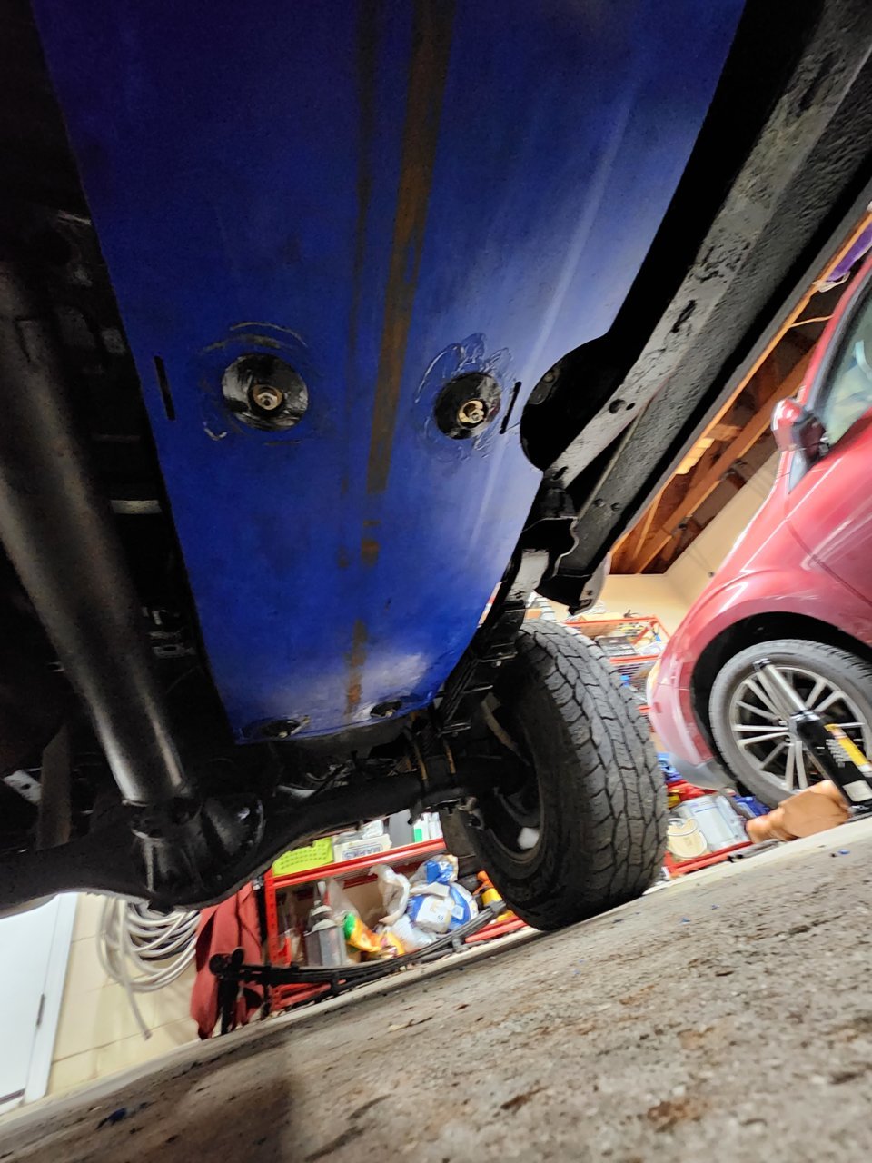

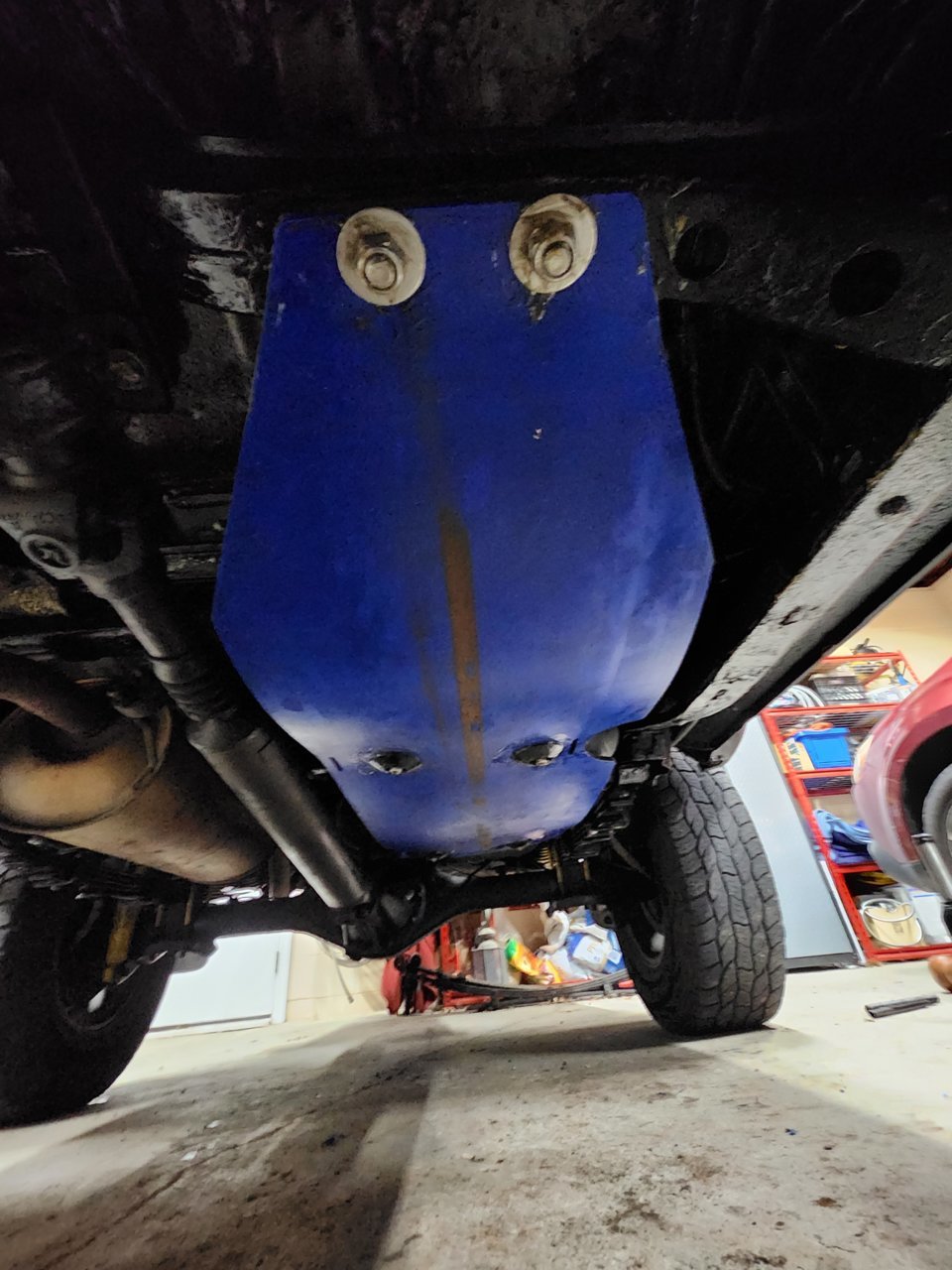

    In light of people having interference issues with the rachet and leaf spring; I found an alternative solution.
    https://www.rockhard4x4.com/product_p/rh-6000-sw-496.htm
    I bought 4 of these rock dome tapered washers, and used a grade 8 washer, locking washer, and some thread lock to properly size the rock dome washers to the smaller bolt and mount the skid after drilling holes in it. (Then lathered fluid film on the metal bits as one does in the rust belt). Now it looks like my truck has nipples! Hope some find this helpful!
