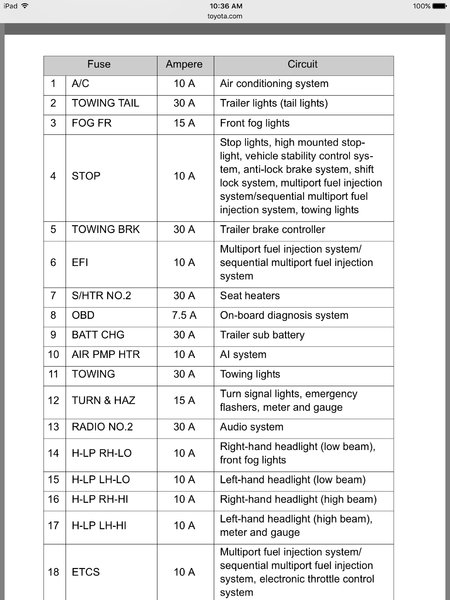

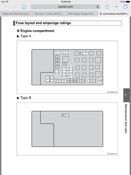

    I have the factory tow package in a '13 DCSB and a 7 pin plug. I can't for the life of me find the fuse for the AUX power wire. Is this shared with some other fuse? I have found the 30A fuses for tail lights and turn/brake lights, and a 10A fuse under the dash for trailer backup lights. I even found the fuse for the trailer breaks. I just cant seem to find the one for the AUX power wire. Any help would be much appreciated.

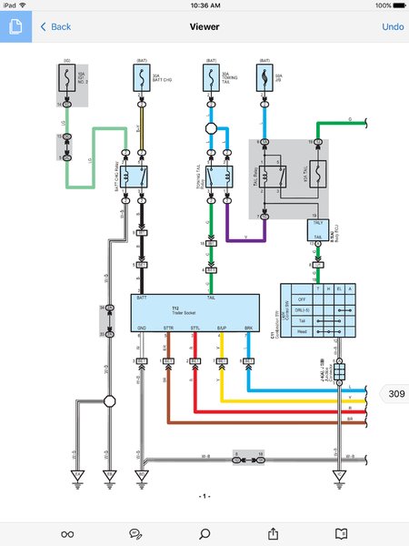

    I believe it's fuse 9 in the engine compartment fuse box.
