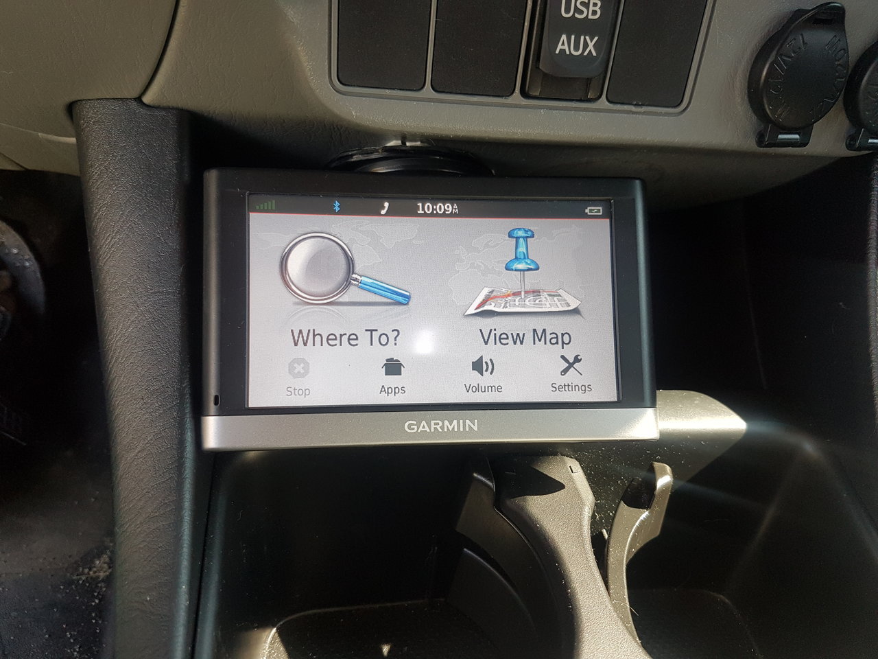

    I use a backup camera that displays the image on my Garmin. It has a very wide angle display. Off to work but I can post more info later of you like.

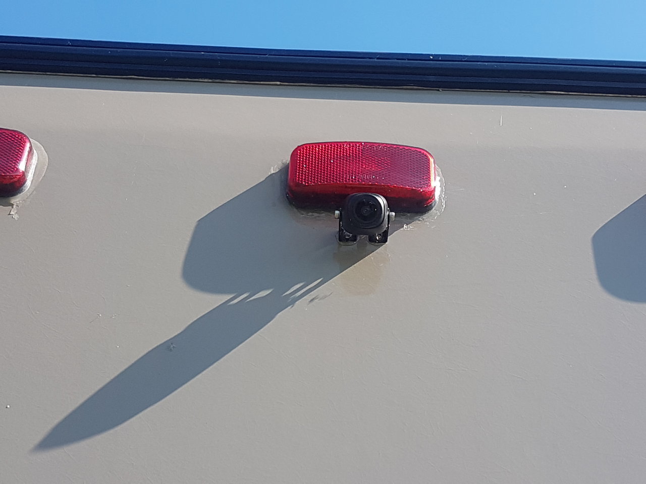

    Sorry for the late reply. The garmin accessory back up camera is the BC-30. I have the camera wired to my marker lights so all I have to do is turn on my marker lights in the truck and the camera will display instantly on my Garmin with me having to touch it. When driving at night simply hit the back button on the Garmin and it back on the nav screen. The grid lines you see are adjustable so I set mine for 1 foot wider than the camper and the closest red line is set around 4 feet from the bumper. It nice not having to have an extra monitor just for the back up camera. Range of the wireless camera is about 45'.
