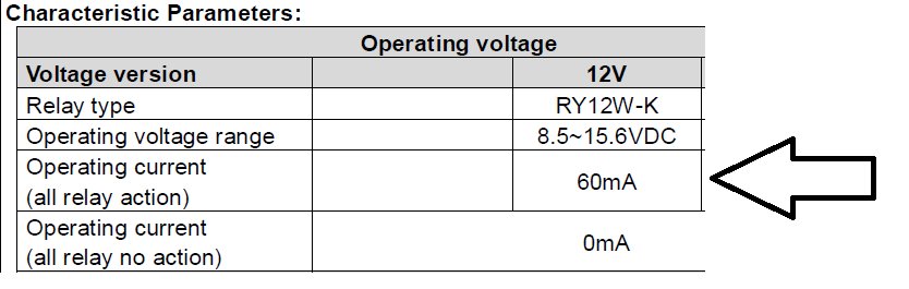

    How many amps do I need to support? My understanding is these cameras were low amperage.
  2. Oct 18, 2019 at 9:56 PM
    #22
    caribe makaira
    caribe makaira Well-Known Member
    Feb 13, 2011
    #51121
    11,777
    Caribbean, Puerto Rico
    05 PreRunner TRD Offroad AutoTrans
    Hood Struts, My version Fogs always ON, Map & Overhead Light Mod,
    If you find out let us know...but your gadget only handles 60 mA.

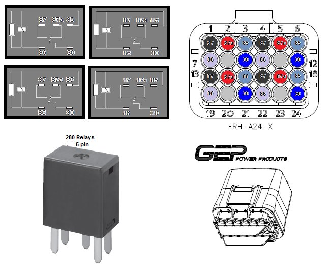

    If you're staying with Arduino control types, to be safe 5 amp on the relay output type. If you stay with vehicle type relays, 280 types. small and handle within expectations.

    That GEP FRH-24X is $10.00 at Waytek.com, but you do need other parts (terminals, seals crimper tool)

    I again want to prefix this, as I am learning here and really appreciate your expertise.
    it seems based on a previous diagram you posted I need two 8 pin relays to connect together?
    like these:
    845N-2C-C DPDT Non-Latching Relay, 12Vdc Coil, 5A 277VAC 1200VA High Sensitivity, Low Cost & Low Profile Miniature PCB Mount (2-Pack) https://www.amazon.com/dp/B07NCCTQWV/ref=cm_sw_r_cp_api_i_.dQQDbJ710NZN
  9. Oct 18, 2019 at 10:44 PM

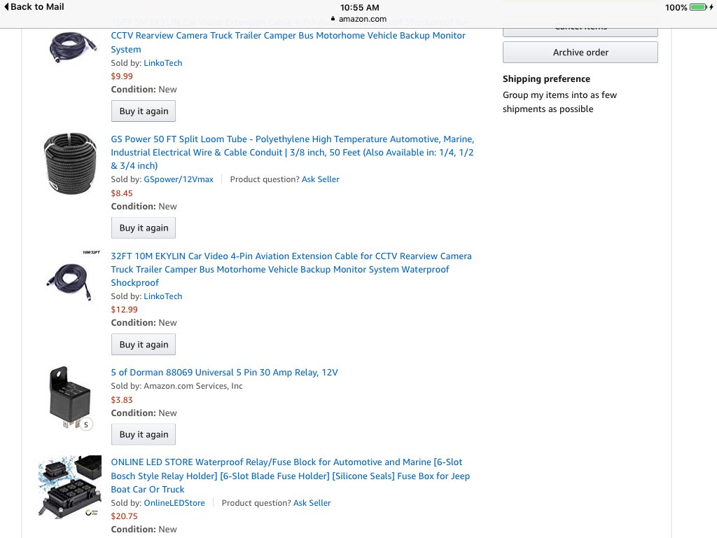

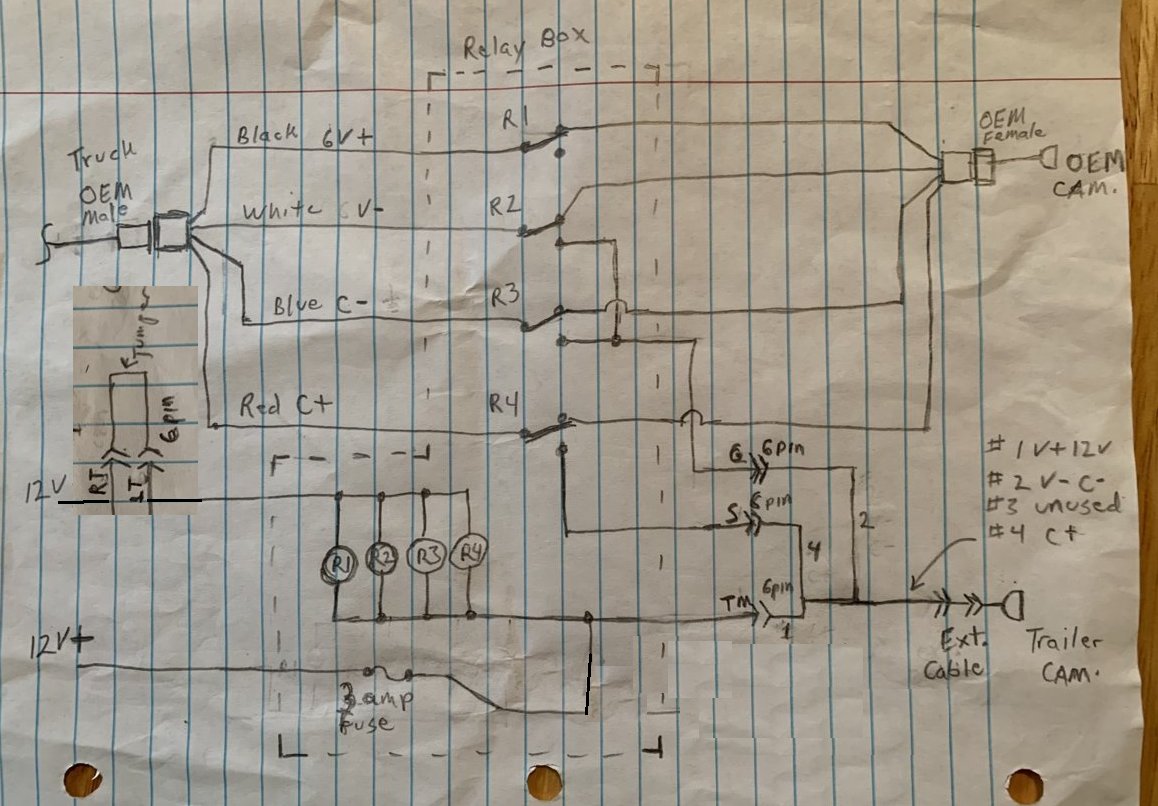

    Here is info on what I have learned so far building a relay kit.
    OEM plug from truck on my 2018 is
    Black 6 volt +
    Red C+ camera input
    White volt DC-
    Blue C- camera ground
    I had to connect both the white & blue to #2 pin on the aviation type camera plug in order to get trailer camera to come up clearly.
    Here is how I wired it up
    Here a good source for the OEM camera plugs with pigtails
    relay box installed I highly recommend using a fuse. upload_2019-10-25_9-54-55.jpg
    View from OEM tailgate
    View from trailer after plugging up camera cable
    I may add some type of switch to the jumper wire on the trailer side of camera cable to eliminate relay chatter when plugging and unplugging cable.
    I know I can sometimes be as clear as mud,
    But I hope this can help someone.
    Glenn

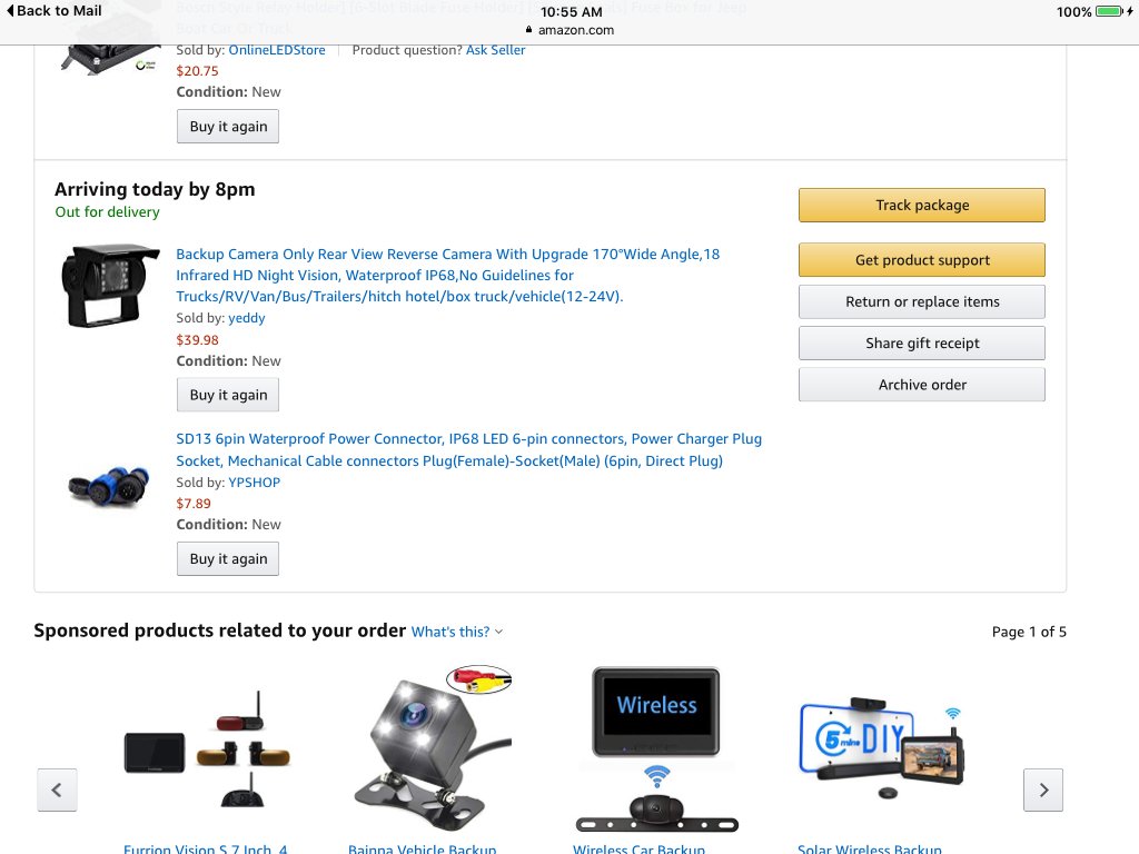

    I bought the short cable thinking that the ends would be cut off and used for pigtail adapters.
    But while being a very tough cable with shield and very heavy jacket the conductors are just too small for field cutting and splicing.
    Not sure why I ordered 5 relays? just wanted a spare I guess.
    This plug was too small for the add on camera plug. I had to pick up a 6 pin round trailer plug, this works fine but is a bit large and could be mistaken for a regular trailer plug by someone else.
    I saw another plug on a thread titled automatic trailer camera module that would be better.
    The camera was the only one I could find with IR, wired, CCD& 170 degrees but I am happy with it.
    All total I have about $175.00 invested if you removed the items not needed it looks closer to $150.00.

    Place jumper on the negative side of the relay coils, and do the plugin and unplugging with vehicle off...

    Hey good idea, if I put together another one I will use this change. At first glance it appears that this will put 12 volt on the trailer camera constantly. But after a closer look I realized that the 12 volt will be just static until the relays make and allow current flow though the ground wires. Also it may reduce arc on the pins this way.
    I picked up the 12 volt power supply from the + terminal at the 7 pin RV plug on the bumper. My reason for this is when the truck is running there is 14 volt on this wire to charge the RV battery. I thought that picking up 14 volts would help overcome some of the voltage drop due to a 35 foot cable run to the rear of trailer. Also I liked powering up relay module any time the truck is running and not needing to turn on any lights. But what was overlooked is that whenever the RV is plugged up to the truck on the RV plug there will be 12 volts on this wire from the RV battery. I don’t see this to be a problem unless we are camping on the RV battery and want to leave the truck connected in order to fire up truck and charge RV battery from time to time. But at these times I will simply unplug the camera plug.
    thanks for your input
