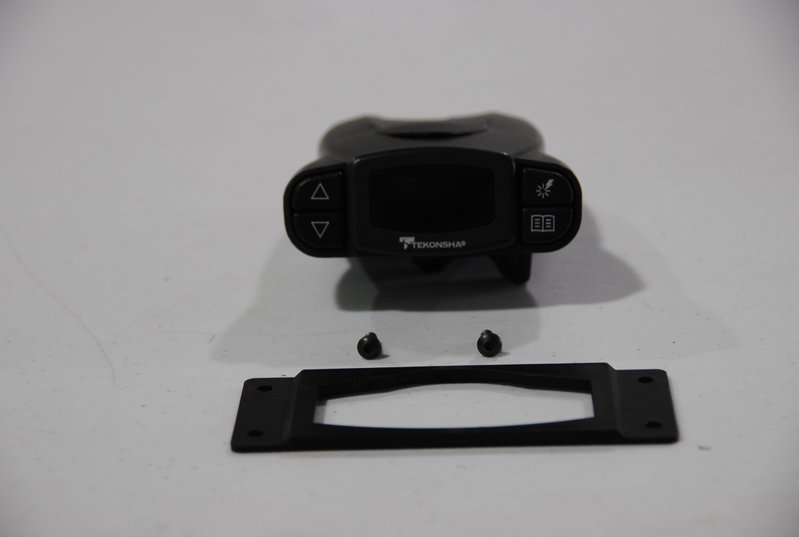

    Here it is. In stock and ready to go. It is pretty simple and I have included instructions as well. The kit includes the panel and the two mounting screws. P3 not included, lol

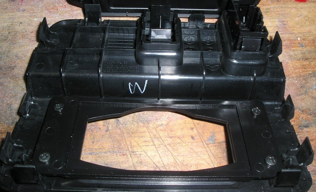

    Installed my P3 Tekonsha brake controller with using the panel from ESP Truck Accessories today. Turned out looking pretty good and sure beats butchering the cup that the ESP panel and controller replaced.

    Your fit will be better if you take the plastic clip off the top of the P3 and shave (cut/file) the ear on the back end off - this will allow the clip to sit flush on the P3 and provide a square surface for the P3 to sit against the esp plate mount. Nice job. Looks good.

    I never thought about removing the plastic clip on the top....dahhhhh! Stupid me! But still thanks for the compliment.

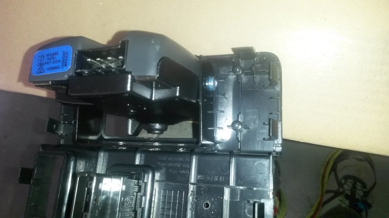

    First I removed the cubby with 4 screws to get more space and a deeper mount. Removing the plastic clip on top of P3 gave more space. I was able to mount the P-3 with the included metal mounting bracket attached to the plastic enclosure with self-drill 3 metal screws driven from the bottom (bracket oriented upright) . The 3 screws show on the front underside of the plastic cover, but they are black and hard to see.
    This uses the 2 supplied mounting screws that go into the sides of the controller. The bracket fastened to the bottom ledge of the plastic cover holds the unit securely.
    There is a small gap under the controller, but it is hard to see. You can operate the manual lever without binding.
    Interesting to note that there are other cables and connectors for non-installed options stowed just below this cubby. This install is a good time to put in other electrical options, and there may be room left in the plastic panel below P3 for switches, etc.
