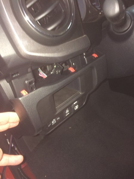

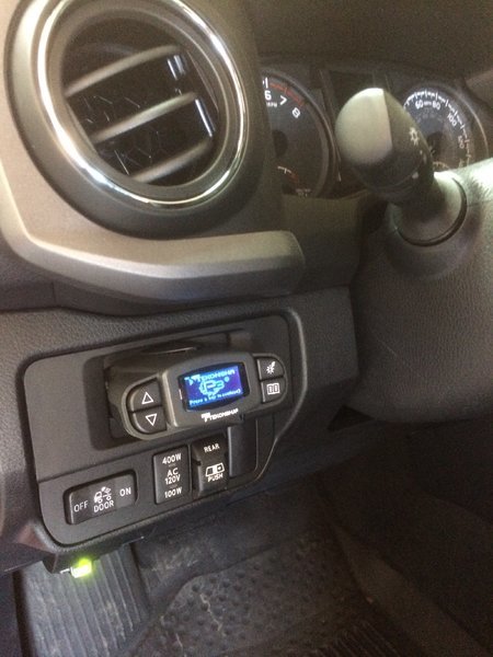

    Help. I'm installing the esp cubby mount. I have removed the three 10mm screws at the bottom, but, I can't get to or find the tabs to compress to remove the panel. Any suggestions???

    Never mind, got it. They show the little red tabs in pink circles in the instructions but the text doesn't mention them

    So here is the lower dash panel. The red clips are the ones circled in pink in the ESP instructions, however, the text ignores them and skips to the six or seven black tabs that you need to compress to remove the cubby and switch panel
    As a matter of fact, you don't need to disconnect the whole thing as you can easily remove the four cubby screws with a small or computer screwdriver once the panel is hanging down.
    Now just need the postman to show up tomorrow with the new ESP panel.

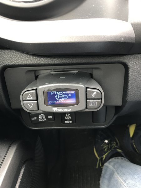

    I ordered a Tekonsha P3 and the 3017P connecting cable from Amazon.

    All done. Kinda had to scratch my head a bit because I expected a bracket behind the ESP panel, but I guess the two supplied screws keep the P3 from falling out forward and the width of the front part of the P3 keep it in place in the opposite direction. Off to pickup the new trailer in Ohio on Wednesday (from Vegas).
