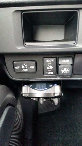

    It's easy, especially if you mount the controller where I did, don't have to take the dash piece off.
    Plug in the pigtail, zip tie it up. Marked the spot on the dash for the two screws with an awl, pre-drilled the holes a bit smaller than the screws and mounted it up.

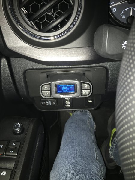

    All installed! It was easy - only concern was the 2 screws holding in the P3 to the face place. I had to go hand tight as I didn't have an Allen key small enough to get in there...
    I also removed the small cover on top of the P3 so it fits into the cubby face plate better.
    Seems to be snug enough.

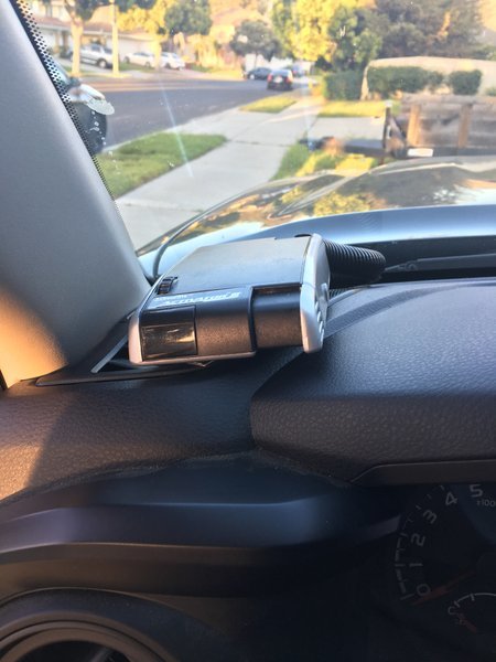

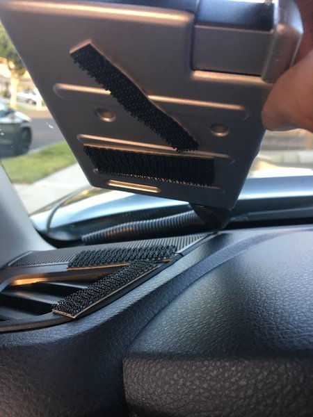

    I Velcroed my controller to the dash speaker cover. Ran harness up a pillar with a coat hanger. It's out of the way and my legs won't hit it entering or exiting truck.

    Does that controller need to be level side to side?

    Works fine like this. Roads aren't perfectly level...

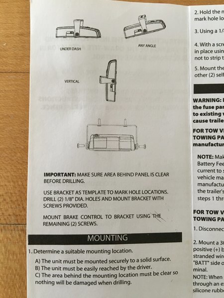

    Instructions say any angle and does not mention any horizontal angle. Velcro is good for ten pounds and is relatively solid. The adhesive will fail before the Velcro breaks free.
