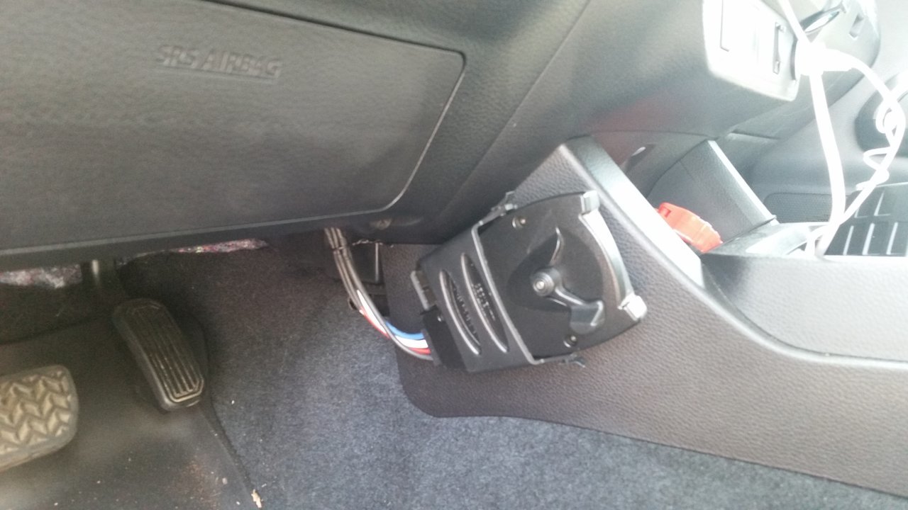

    I wish I had a picture of my P3. I attached mine to the lower dash to the right of the steering wheel. I hit it with my knee for about a week and haven't since. It's immediately accessible to my dominant hand whenever needed, and I can read the display with minimal issue. I'll try to take a picture today and upload it.

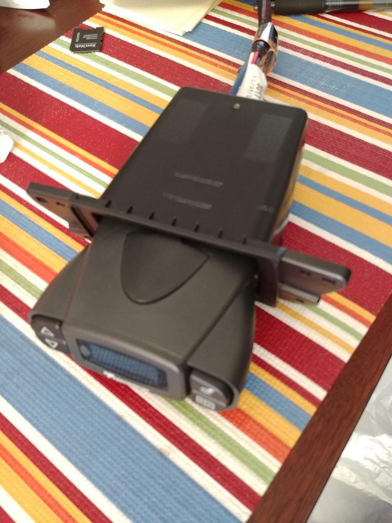

    I pushed mine into the change holder. I've never had anything in the change holder.
    I sit real close to the dash so I couldn't place it below the wheel. Its in there REAL tight. I dremeled out a rectangle to feed the plug through.
    When I first tried pushing it in, it was so tight that I thought you guys were faking your install pictures.... You just gotta push it in there

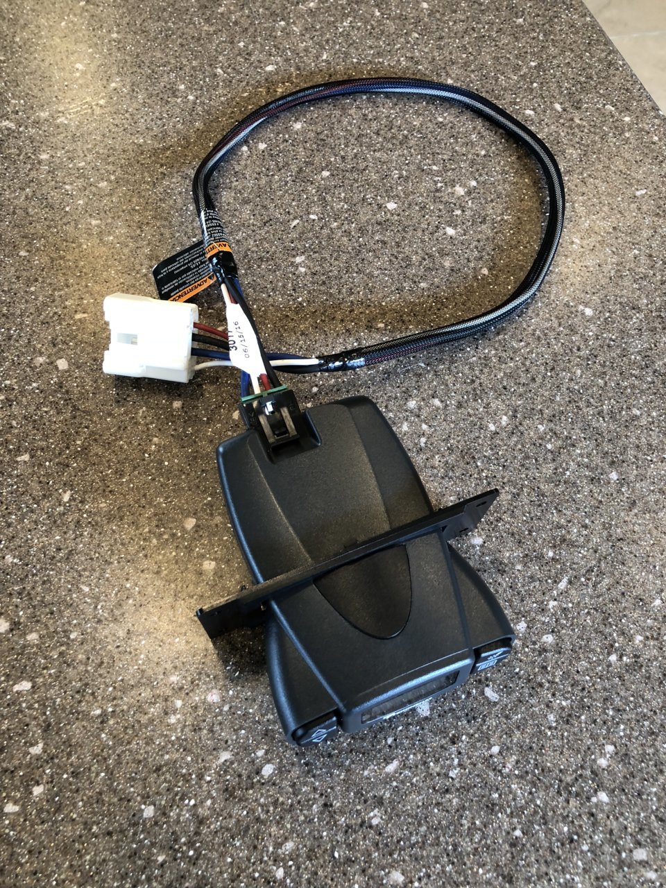

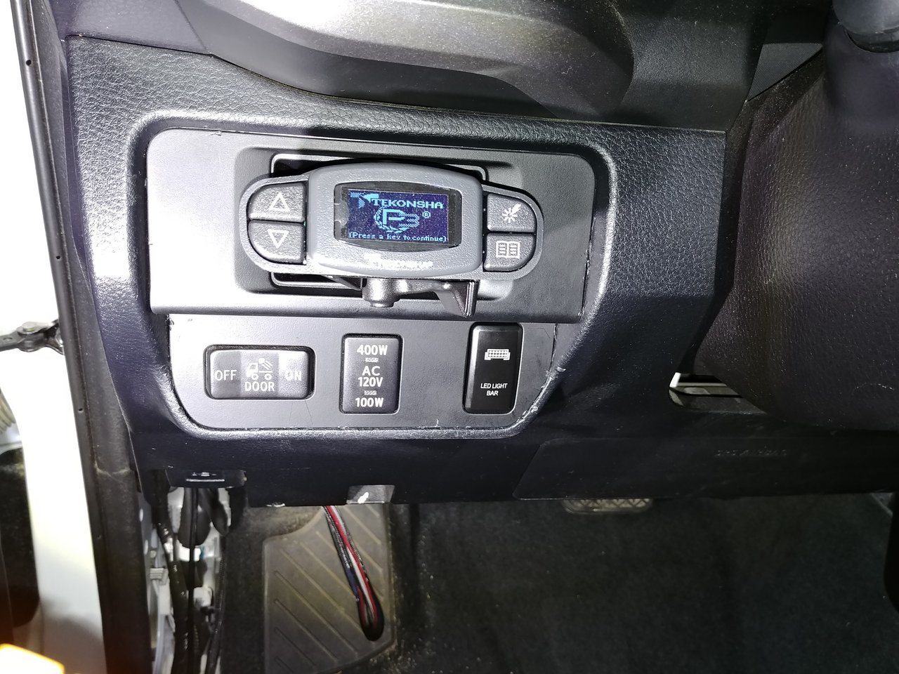

    Just did the ESP cubby mount install using the Tekonsha P3 brake controller ($117 Amazon prime) and 3017-P wiring harness ($15 Amazon). Turned out awesome. Literally plug and play and about a 10 minute total install.
    By the way, I just found another thread where a guy melted his truck harness using the 3017-P harness and caused $6k in damage...he miraculously got Tekonsha to pay for the damage. They have since released a new harness (3031) that includes a ground wire. Wish I had seen that before hand! Any thoughts on switching harnesses?

    exactly the same set up I did, looks and functions great for me. except I went with the other proportional model controller from Reese. the one with the blue boost buttons. I have an older Tek P2 but I didn't like how far it stuck out and was going to get the P3, even got the ESP plate but again it just was to intrusive for me when I only use it x number of times a year.

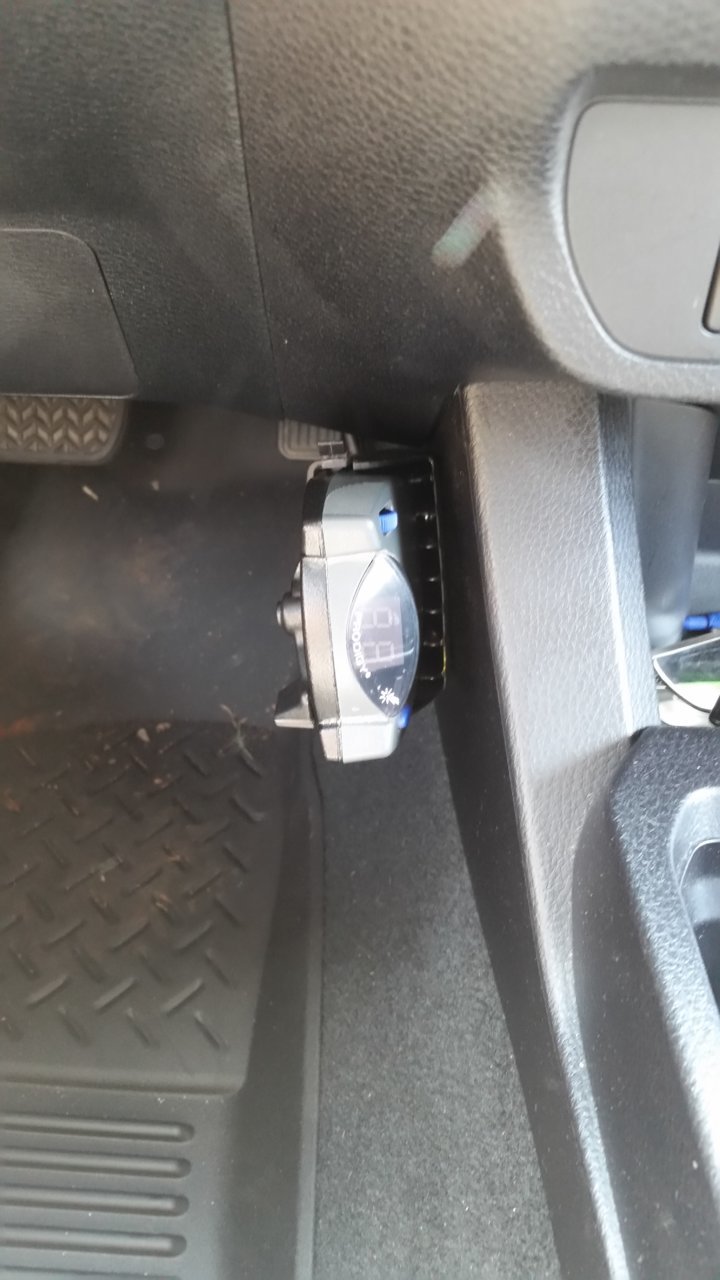

    I have an older Prodigy that was installed in my last truck. Ordered the wiring harness for the Tundra and proceeded to install. I didn't want to lose the coin cubby as I use it for other things. Under the dash on the left side was going to cause knee damage and/or wind up breaking the controller or mounting clip, so I opted to install on the knee wall on the right side. The harness wires were too short, though, so I had to solder in about 6 more inches to each wire to get it to work. But now it's in and in a spot that works for me. 20180817_133620.jpg 20180817_133640.jpg

    You sure that mounting angle is ok for proper trailer braking?

    I don't think I have the instructions any more for it. I'll double-check the mounting info before I pull anything with it. Thanks for the info.

    Yeah, it looks like I'm going to have to move it. Maybe I can mount it in the center cubby in front of the shifter.
