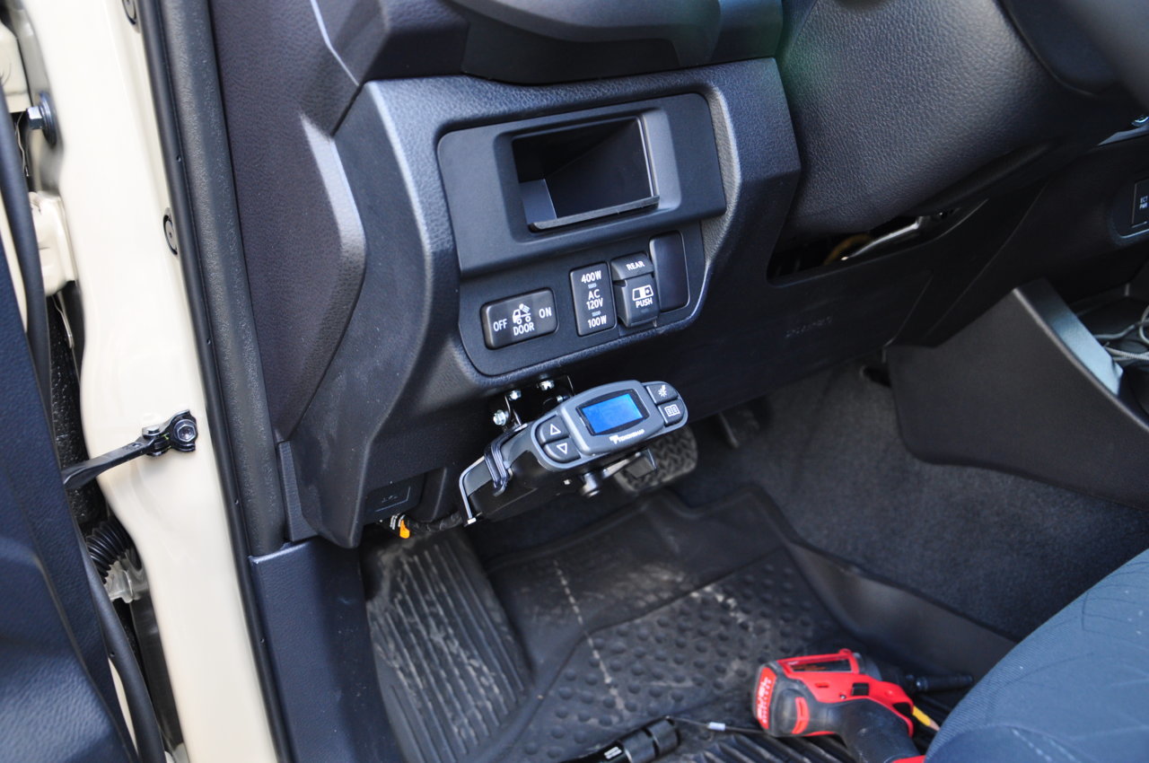

    Moved. Don't really like the location, bit I didn't want to drill a big hole in the center cubby to run the wires. This location will work okay. I'll just keep the controller stashed under the back seat until I need it. 20180817_191645.jpg

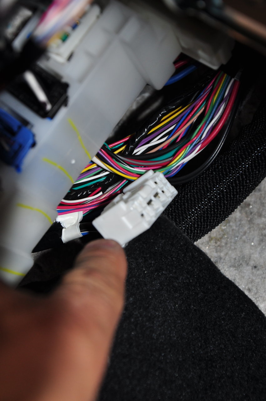

    i'm on a few travel trailer sites and everyone recommended the P3. friend has the P2 and the 3 is just the newer model.. went with th eP3. works very well for my travel trailer.
    pain in the ass to find the wiring behind the kick panel on towing package trucks.. but easy install...

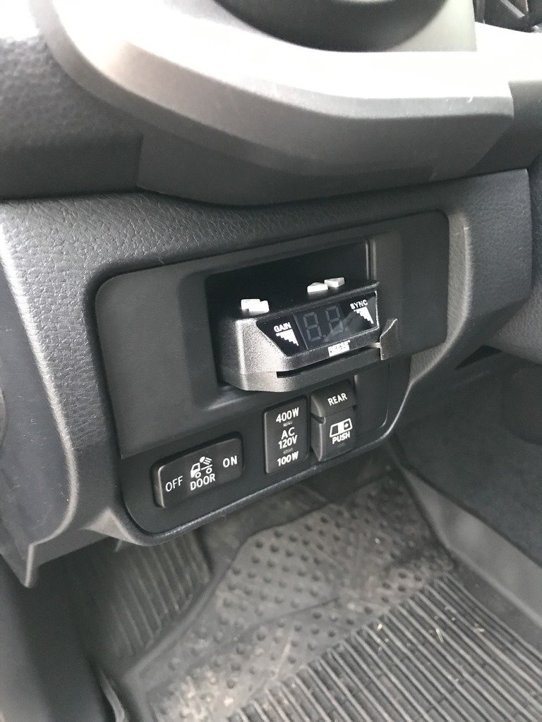

    There is a member who manufactures a custom panel that replaces the little cubby and fits a tekonsha P3.

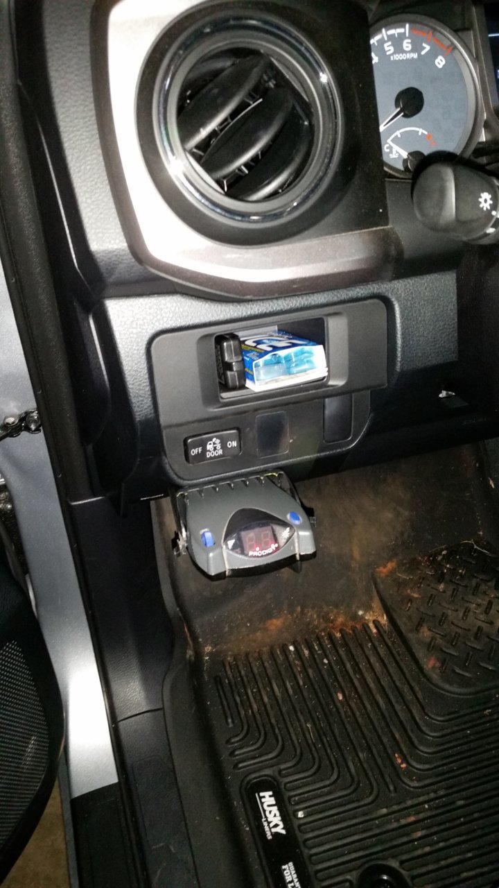

    This is the best option for install a break controller on my 2018 Tacoma TRD OFF ROAD. It is a Spectrum break controller. 5CE3C016-8F4C-49A0-BA73-4FB1BD76425E.jpg

    Wow that does look clean. What is the controller model and is that panel it is mounted in custom or can it be bought somewhere? You can't just drop that with no details...

    It is a Spectrum break controller, I just add the mounting plate behind the little pocket it is easy to take out an do some glue;)
