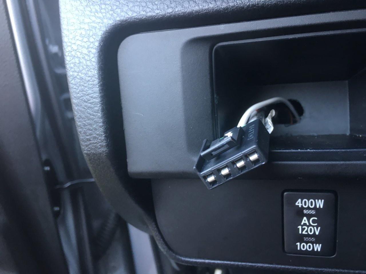

    I have my Tekonsha controller installed in the cubby and finding the plug under the dash was the hardest part. I used the ESP Truck decorative face plate. I did discover/remember that if one slides a table knife into the slot on the right side of the cubby about one inch down and pry gently, the panel pops out and all the rest of the install can be done with it loose. No need to remove the whole panel from under steering wheel to get to it.

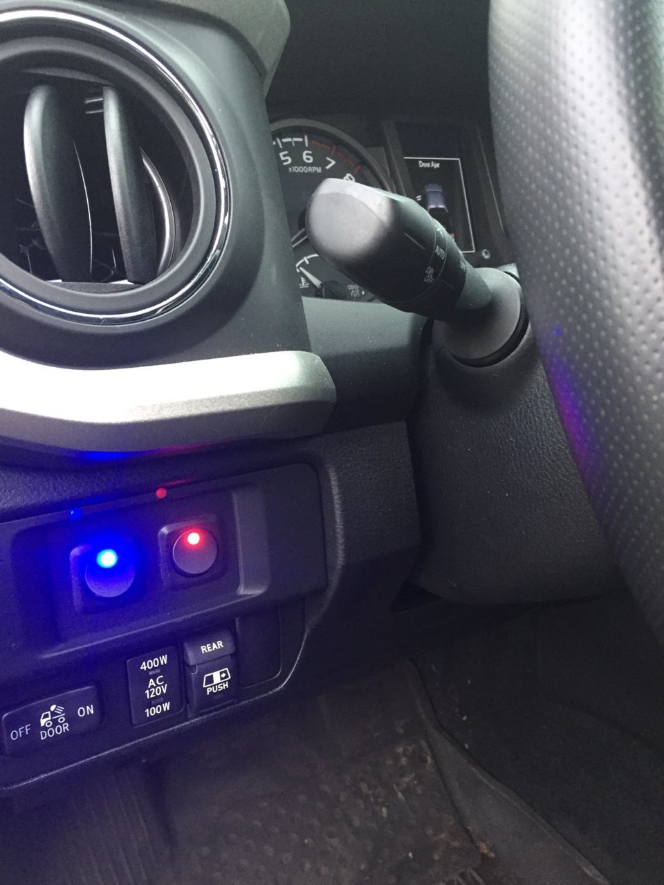

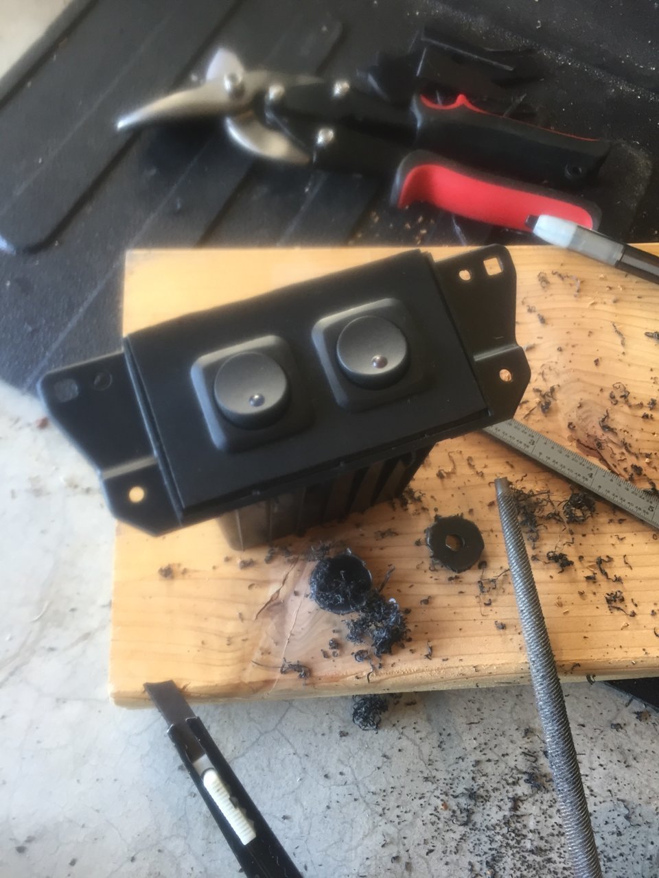

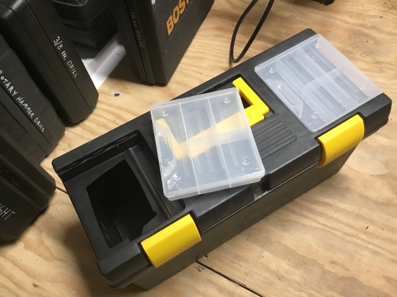

    A cheap plastic tool box that I wasn’t using.
    9F154590-3479-4C2C-A5BD-4C7B9330C36B.jpg 95A4180B-FCD4-405C-8A1A-EB44D2794D75.jpg
    Oregon Fish and Bob K like this.
  9. Jan 1, 2020 at 11:10 PM
    #389
    Bob K
    Bob K Well-Known Member
    Jan 1, 2020
    #314882
    73
    Bob
    2017 TRD Off Road
    Was it just an epoxy or hot glue installation into the backside of the cubby?
  10. Jan 2, 2020 at 12:10 AM
    #390
    OregontoBajaCA
    OregontoBajaCA 2025 DC OR High Bread
    Dec 6, 2017
    #237812
    850
    2025 OR DC iF Max
    Small screws that are slightly longer than the stock screws from the back side, as it’s sandwiched between the cubby and the face plate.
    This picture is grainy at the switches as the LEDs are bright, but the switches actually look clean and neat.
    Using for area lights. Front blue, rear red.
    I’ll find another spot for the brake controller.

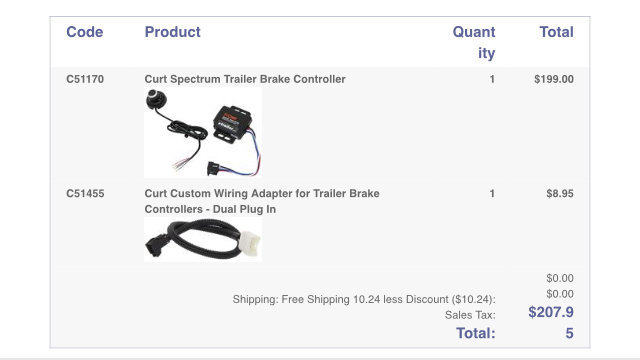

    Hi Bob K, the brake controller and adapter from eTrailer and the cubby panel from Shapeways (shapeways.com).
    I’m very happy with the quality, and look. I mounted the controller to the left thinking I could add a switch on the right and it’s easier to see around the steering wheel. I surface attached the brake controller to the panel with the screw. No gluing required.
    The details are in the pics.
    Oregon Fish and Bob K[QUOTED] like this.
